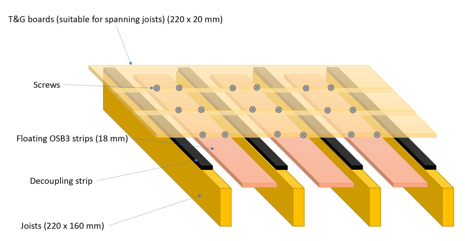

I removed some old 27mm T&G flooring. To remove bounce, I then double-sistered and leveled the 75mm floor joists with 2x 45mm sisters. Now I'm thinking about how to install the new 20mm engineered floorboards.
I have 7mm spare. The final height of the floor cannot be raised.
Ideally, I'd make a floating floor, but could screw them directly to joists if not possible.
How crazy is my idea in the attached image?
You vould just lay 6mm ply across the top of the lot, glued and screwed to the joists. If you need to decouple just lay 7mm thick soundproofing on top of the joists/sisters instead. No need for the OSB.
What is your finished flooring made from? Will it actually carry load on the unsupported bits between the joists?

Whats the purpose does the osb strips?
It holds the T&G flooring surface together tightly.

6mm ply is great, but it leaves only 1mm for soundproofing on top.
I could lay 7mm soundproofing on top of the joists, but I still need to hold the T&G flooring together somehow, and the flimsy membrane wouldn't cope with this. I also couldn't screw through the membrane into the joists, as this would void the decoupling.

Decoupling with sound proofing works, but your new flooring will need to have structural strength - does it? In fact, fixing the ceiling below to suspended resilient bars and using soundblock plasterboard probably works better, especially if you also fill the voids between the joists with mineral wool batting cut tightly and packed in. Whilst the ceiling below might not be feasible, the mineral wool is

The new flooring is 20mm and is approved for spanning joists. It should be very strong when installed. The fact that it doesn't require chipboard panels underneath gave me the idea for floating it in my attached picture.
Yes, ideally I would simply decouple the ceiling. I should have mentioned that my property is a tenement flat, with a different property owner below, so I can't touch the ceiling.
As it is structurally rated you should be OK, then.I assume the joints will be glued
In that case adding mineral wool batting between the joists will benefit you

Way ahead of you. For this room, the Victorians put 1.2 tons of fly ash between the joists. I removed it all to add sisters. I have put back the shelf (this time made of fireproof plasterboard) and will retrofit the same weight/m2 of Quietex deadening. (regs ask for >80 kg/m2).
Fly ash - now there's a really old technique! It does work, though
