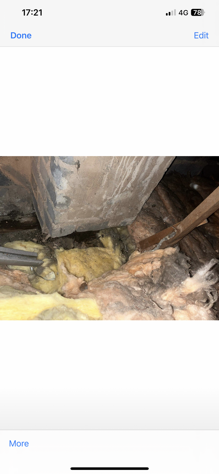

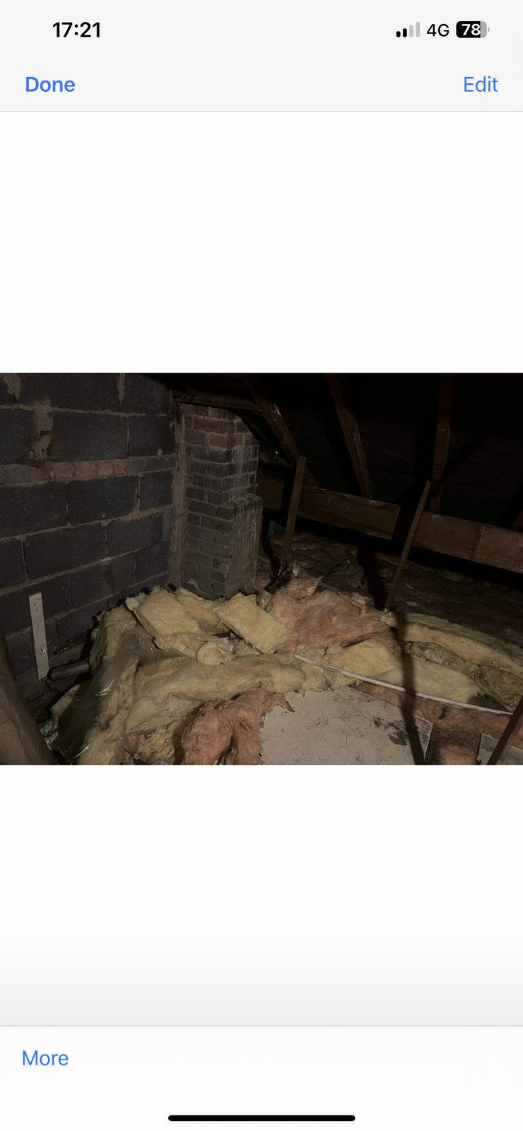

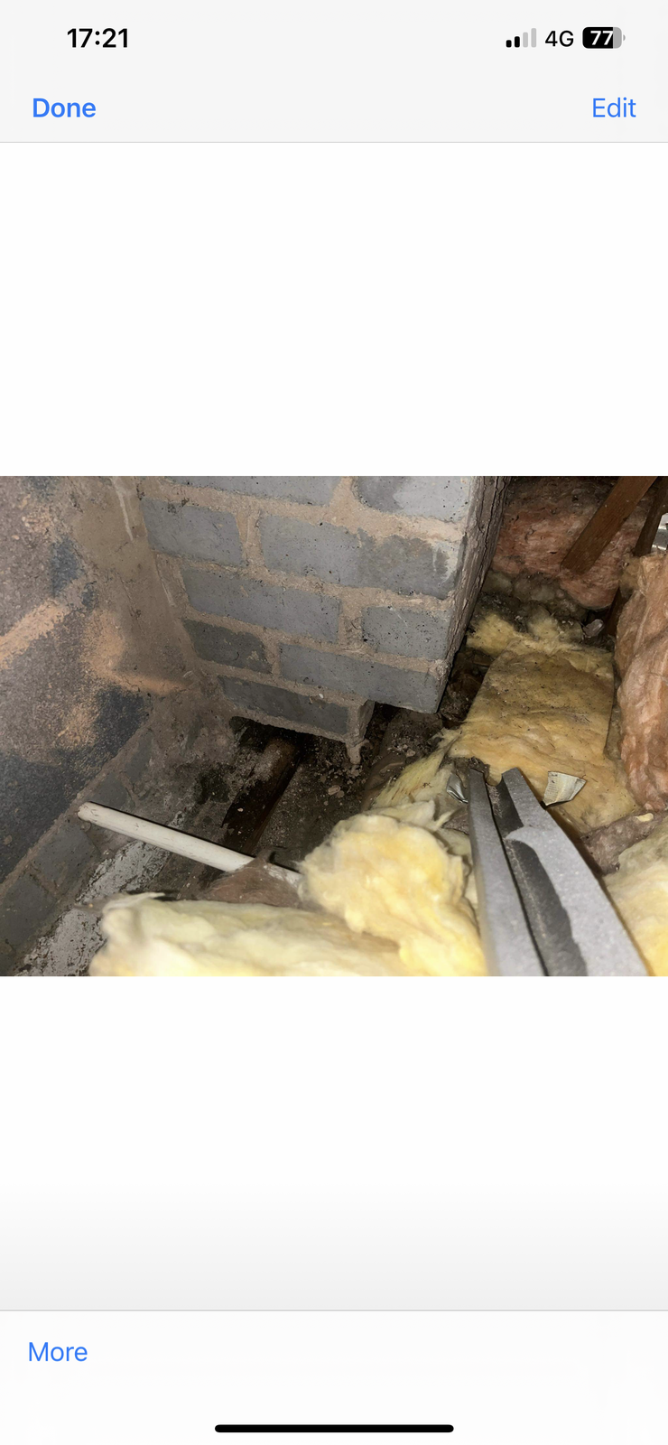

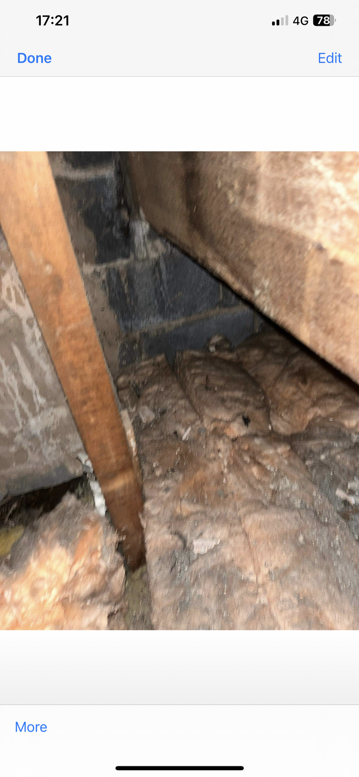

Hi
I’m in the process of buying a semi detached bungalow.
The survey showed an unsupported chimney stack. Current owner knows nothing about it and this was done prior to him over 20 years ago.
The chimney is shared with next door and her gas flue comes out into it. She’s happy to have the chimney removed if the flue can be redirected but if not, I’m not really sure as to what the other options are.
I’ve been told that because it’s a breeze block in the attic area, it’s likely metal support wouldn’t hold it.
What other options are there please? I’m sick of this chimney already and I’m not even in the house.
I’ve attached photos below.
Difficult to make head or tail of it, as every pic seems to have something moved or rearranged. Work out where the nearest load bearing walls are and that will indicate (or not) where a suitable steel can be placed to support the remaining part of the flue. Or remove the whole flue and get your neighbour to redirect her gas flue through her own roof, unless she can prove she has a legal right to discharge through your loft.
