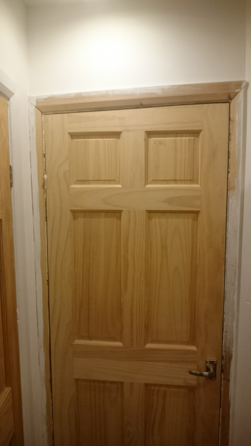

I've been in my 1930s semi for a couple of years. I've recently noticed that one of my upstairs walls is solid (blockwork I presume) and not supported by a corresponding wall below. I also noticed that the door frames in this upstairs wall are heavily distorted. There is a sag/creep of several centimetres over a meter or two. The door itself has been modified to fit the distorted frame so I'm confident this hasn't changed recently.

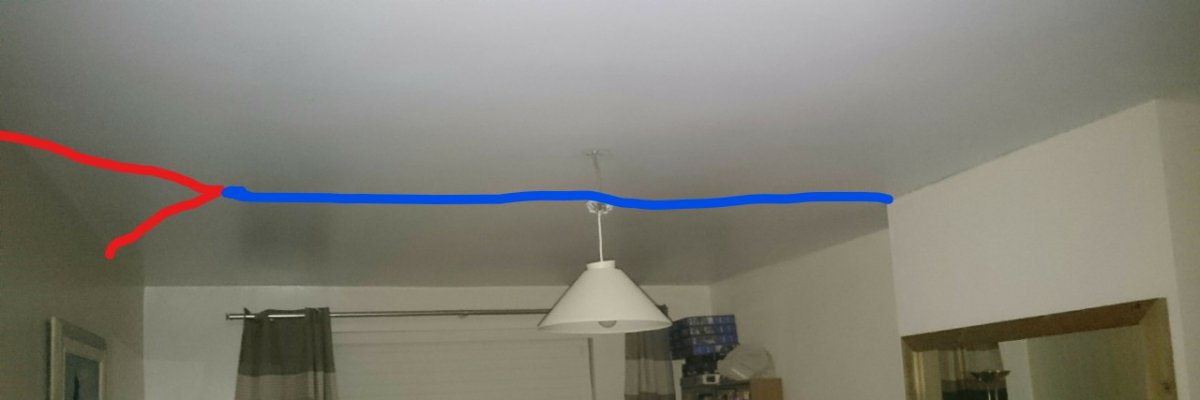

Take a long level or a level and a straight edge, and put it to the ceiling below the block wall.

I've added some pictures below. The blue line is where the upstairs wall runs, the red lines are where the doorways above would be. Using a level and a straightedge on the ceiling the blue line is actually pretty level, it's just the red bit under the doors that bends upwards
I also added a picture of one of the doorways upstairs (Don't blame me for the architraving!)

Incidentally, when I said the joists must run into the chimney breast that was because I was assuming that the joists would run across the short span of the rectangular room. I don't really know that for sure. For all I know they run front to back over 5 metres.
How sure are you it's a solid wall and not a stud + lath and plaster? If block it's possible it has an RSJ underneath, which would also allow the joists to run length ways (my house does this).
