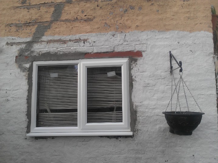

I recently had a repair done on my house for mild subsidence and a new window put in. I had asked for a new lintel as well, but the builders said that the one I already had was ok. (Two other trading standards approved builders had also said that I didn't need a new lintel when they came to give quotes.) However, a neighbour's friend took one look at the work and said 'who did that' in an incredulous voice when he saw it, but said it was OK when I asked him what was wrong with it. My neighbour does not think much of the work and I suspect put him up to be critical. It has made me worry though. The builders put mortar on half of the lintel though it was just the same as the half they didn't put it on. The structural engineer wasn't effusive in his praise, but just said it was the best you could expect nowadays and I had nothing to worry about. I am enclosing a photo of the new window with the older lintel and would be interested in hearing what people here think.

From what you've said clearly the lintel isn't the issue, but what they've done isn't going to win any awards for beauty
What's wrong? It's going to be painted isn't it?
Anyway, if this is part of subsidence remedial work, then it's not up to the builders to say what they think it's needed, but it's up to the consulting structural engineer to specify what is required.
The structural engineer hadn't said that a new lintel was needed. I just thought it might be. Yes, the work will be painted. It's just that my neighbour and then her friend made critical remarks. My neighbour is the sort of person who thinks that I am useless at arranging for things to be done. I said to the structural engineer about her friend's comment and he said that that was an unhelpful thing to say.
Your neighbour and their friend are presumably not Clerks of Work, so can be politely told to go and swivel.
Your engineer is a bit of a drip too for his "best you can expect comment". He should swivel too.
