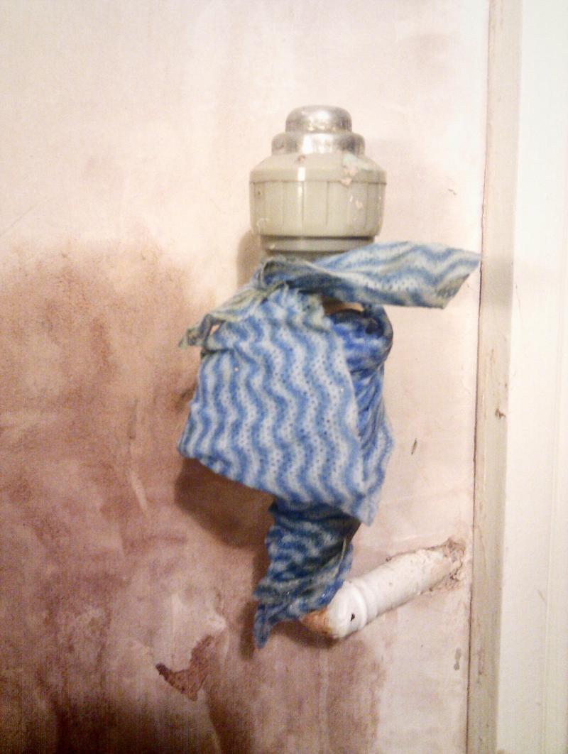

So we have taken our single finn radiator off the wall, to have our plasterer skim behind. While it's been off, there has been continuous dripping from the main valve at the top (see photos), which we've stemmed with a cloth and have a bowl underneath.

So I want opinions on why the valve might be leaking (novice DIYers here), what we need to buy and change to resolve that in the mean time?

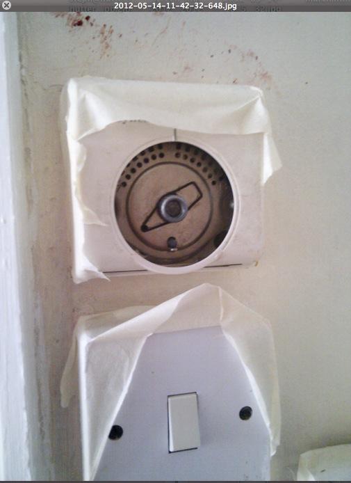

Also included is our lovely thermostat in the hall for another laugh!
YOur thermostat's a Honeywell, with the knob missing:

That drippy valve may be working just fine - they're designed to open when they get cold. You could get a plumbing fitting to screw on its exhaust..

I have a plumber round this afty and he advised that we should have taken the radiator valve head off and screwed in some retainer type nut that would push down a pin inside and prevent the water dripping out, all before taking the radiator off. Anyway he advised getting a threaded cap manifold cover type thing for it meanwhile, which I did (a 3/4 thread) and some PTFE tape for inside the thread. I've screwed this on but is still dripping, though I don't have the strength of a man to tighten much! lol. Er also I think with the pin not pushed in, its a bit of a fail there.

Last night OH put radiator valve back on as pictured but leak continued after a while and my end 3/4" manifold cap and PTFE tape didn't work (AT ALL). Today we have steady big drips every 4-5 secs and bowl fills up slowly but surely. My OH reckons he has bust the olive from trying to tighten things whilst tired after long day at work last night (12hrs).
Now OH has changed an olive before on another radiator and back then he fitted a new thermostatic valve that I got from B&Q.
Prob here is, the pipe goes inside the architrave and he is worried that he can't get the olive off without hacksawing it off, which he thinks will then prevent the radiator fitting back in place as the pipe will be a tad too short.
He is therefore getting me to find a radiator and get the plumber back today, BUT we are skint and I'm being made redundant next month and this is a BAD idea when said radiator was working fine before we took it off briefly to skim plaster room, just had no thermostatic valve to change temperature (so On or Off).
So we have a 15mm pipe going vertical up to valve and a 3/4" connector coming off at the right angle that connects to rad... Please can some nice person with knowledge of plumbing, advise if we can /a get the olive off without hacksawing e.g. tool we can buy or may have, or b/ hacksaw it off but somehow still connect rad e.g. extension bit nuts or washers or something and c/ suggest a decent thermostatic valve from one of the sheds or plumb centre places that we could fit tonight? P.S the pipe from the door architrave is bendy, as in not secured into plaster properly and this is also scaring the OH. He thinks it is too old but pipes don't bend when they are old do they? It is surely just what I said?

OH hacksawed old olive off just below it on the dodgy leaking valve and managed to re fit the old radiator.
Prob is there is now not quite enough pipe to fit to radiator and it is pulling on the connection a bit and therefore we don't want to fill it back up, as the drip has stopped and we will probably be inviting more trouble! We bought a £3.99 On/Off valve from B&Q to solve present issue.
