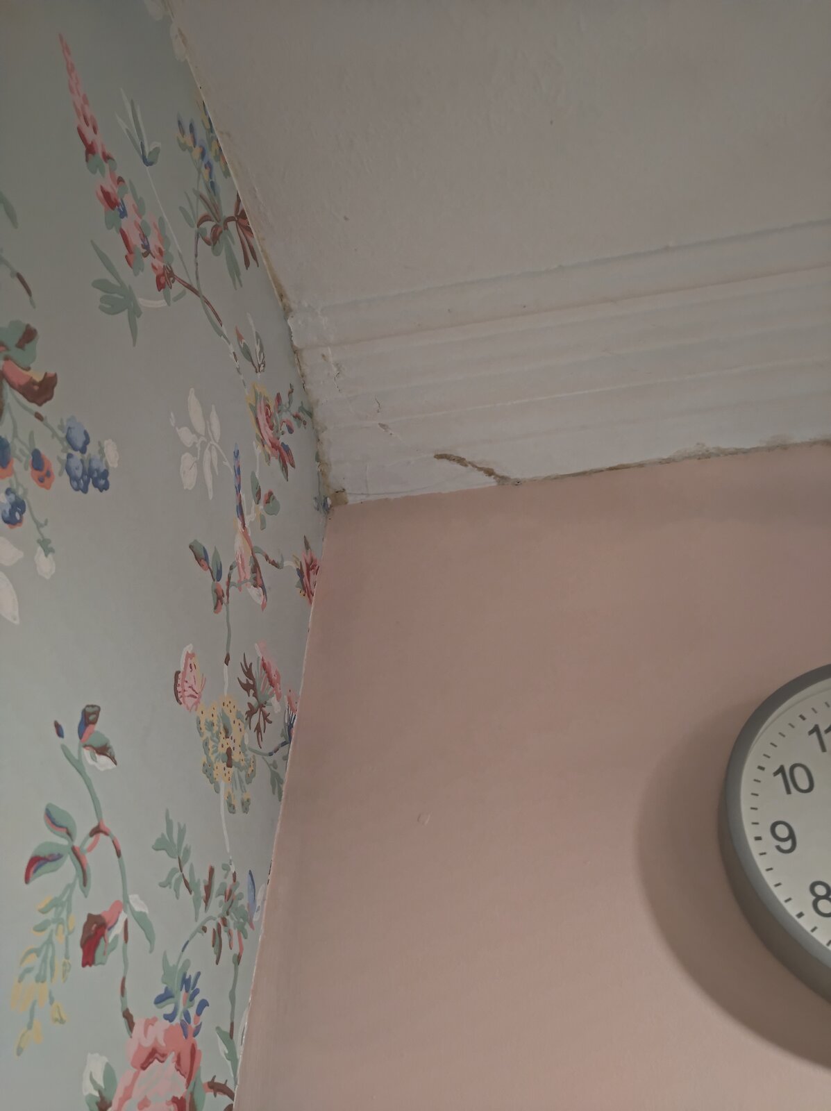

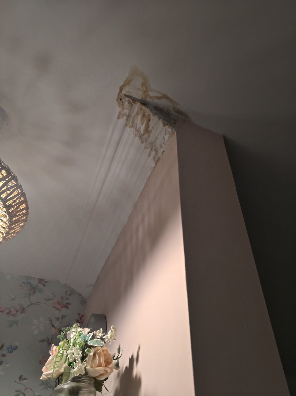

Unusual ceiling stain after decorating, please help
4 Feb 2022
2
Its an old water stain (unless it is a current leak) You need a couple of coats of a good stain blocker any DIY store will have a selection, for a small area like that some Zinsser BIN would be ideal, available in brush or spray can.
