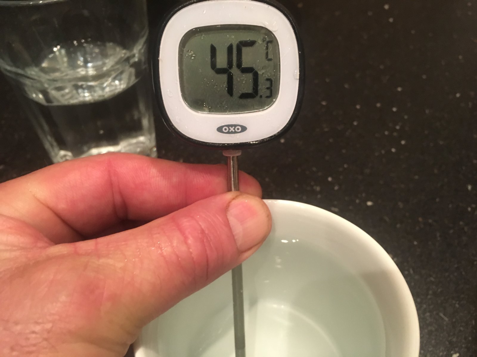

This is what I’ve got coming out of my tap. Plenty hot enough for me. Any hotter and I’d need to add cold to it to get it down to the temperature I PREFER. Why the **** would I want to do that? Is it cheaper to heat water hotter than that nowadays?
Perhaps you should read stuff you post links to.

Now, have a look at my temperature (it had cooled down from 46.1 while I went and got my phone to take a picture) and tell me whether it is higher or lower than the recommended temperature that you sent me. Oh, it's higher! Guess I’m not so daft after all.

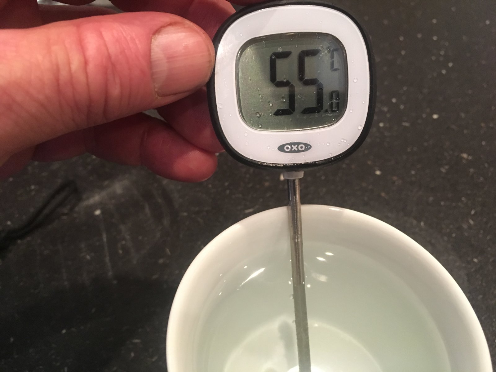

Now up to this:
Bloody hot though - I can’t hold my hand under the tap now. I reckon 60° would take my skin off so I’m stopping at that.
That is a good thing. You will notice that your washing up will be easier now.
For reference, when I commission my cylinders, I tend to leave them at 55.
