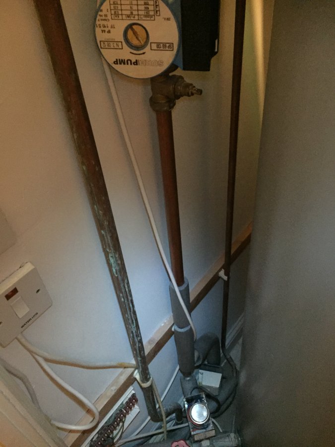

Confirm the fault...
after the central heating has been running turn off the water and heating at the programmer if the pump continues to run and the red (overheat) light comes on then microswitch stuck in zone valve.
find the location of the zone valve...
you "should " have two valves just after the pump but could be anywhere.

Problem solved - it was indeed the heating zone valve - it's the white one in the background, not the one opened in the foreground.
The lever that actions it manually was being dragged with the motor when valve opened, and when trying to close, the lever was blocking the motor of closing the valve ... a bit of grease and everything was fixed ... picture with the culprit ...
