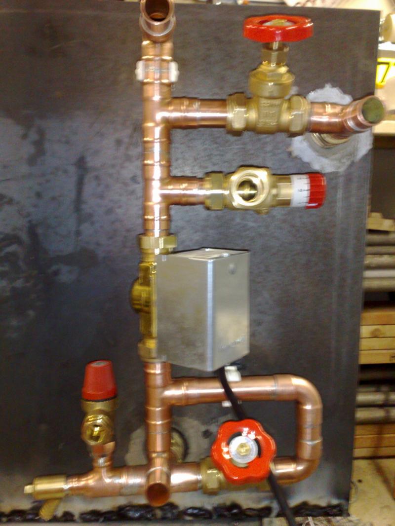

Ok, one more question if I may, is there any regulation/rule/law prohibiting me from building my own store from scratch (i.e from sheet steel) I would of course use normal commercially available PRVs and expansion vessels. And needless to say, I would pressure test it to well in excess of 1.5bar before using it, I don't really fancy 200litres of 80C water throughout the house!

Oh, forgot to mention that I think I have a novel way of connecting said store to an (my) exisiting system which means that it can be connected using only a couple of tappings and also so that it can be isolated (using a two port motorised valve) should it become depleted (and then reheated when there is no demand elsewhere.
From what I've seen of other designs, this is one failing of the thermal store idea, that being that once depleted it puts further demand on the boiler at a time when it's trying to service the system elsewhere.
I *think* my system will mean that in a situation like this is can be isolated to prevent such an occurance.

It's just as well that I am allowed to make this thing, because I've already started it :D
...strange looking eh?!
I reckon, although I'm happy to be proved wrong that the 'thing' I'm building pictured above will allow me to get boiling hot radiators as soon as I swtich on the heating, prevent boiler cycling and provide a quick reheat on my unvented cylinder.
Which I admit are all things a normal thermal store can do...
However... I think I'll only need the existing pump, and the two port motorised valve pictured will allow me to isolate the store when and if it gets empty and I can then reheat it when all other demands are met.
I don't think a normal thermal store allows this, i.e you need multiple pumps and there is no way of isolating the store when it's depleated.
I'll post more info when it's finished, at present it only has two sides, so won't be storing much!!
I can't see an image.
A heat bank is not an unvented cylinder. Are you fitting one of these as well?
A normal thermal store with pump(s) on CH can be isolated (I think you mean switched out). You just switch out the pump(s) with a simple relay when the boiler is firing, as I have explained. Simple. Just put a check valve in front of the pump and this will prevent gravity circulation. Depending on CH pipe arrangements, you may need on on the return too.

Needless to say (and as you can see in the picture, I'll be using a PRV set at 3bar on the store, additionally as it is a sealed system, there is another one integral to the boiler.
So I'm fairly sure this won't happen to me! :D
It happens to many unvented cylinders around the world.
Put a high temperature cut-out stat (needs resetting if stripped) at the top of the store set to 95C. This cuts out the boiler if it runs wild.
