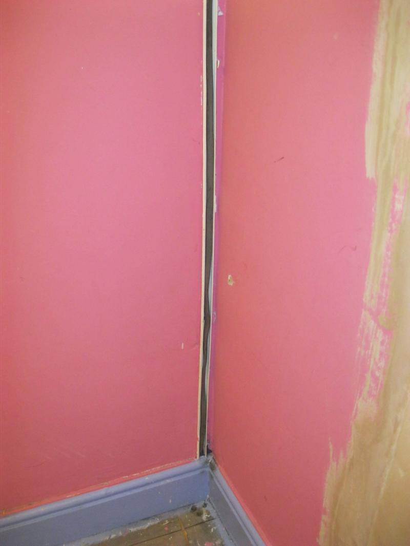

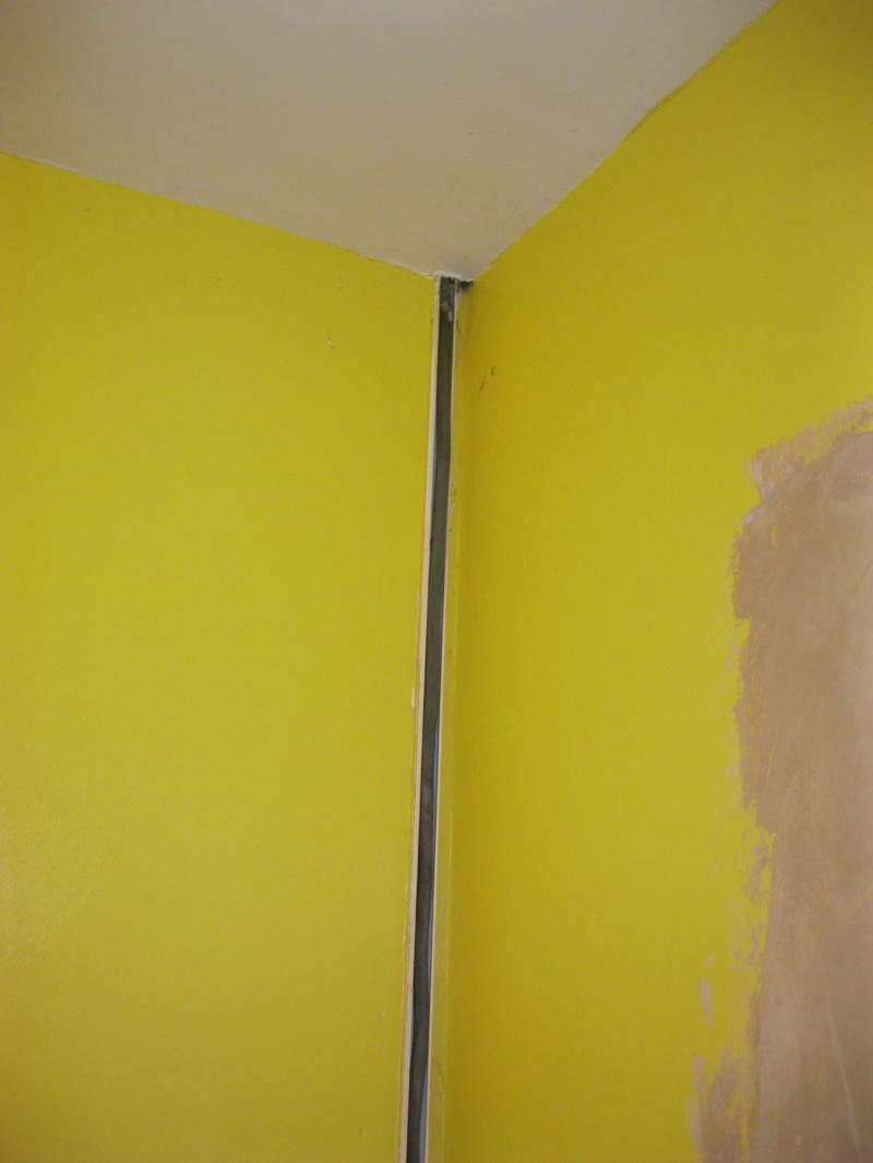

Hi
I have unsavoury looking conduit running down a bedroom wall, this runs into my loft and down into my bathroom to power an electric shower
Ideally this has to be buried into the wall as we cannot simply remove or we would have no shower
What would be the simplest and legal way to do this

Put it some trucking tight into the corner and paint it the same colour as the wall, you will hardly see it.
Easiest way.
What if I install a double socket about 12 inches away from the wall, would I then be allowed to chase the electricity wire into the wall, am i right in thinking that by doing this i would be creating a safe zone for the original wire

It might be possible to chase it in but you will need to gain some slack, which may or may not be available.
The thick cable once in the ceiling travels to the left, and it is to the left that I could fit a double socket

So even if there is no light switch or socket on the wall can I legally still bury this wire into the wall, if I ever move out whose to say someone won't hang a picture or a shelf and drill right through the wire because there is nothing electrical in the room to suggest a wire will be hidden in that exact place, and who goes into a house tracing all the electrics to find out were all the wires are
Without a socket in-line with this wire I think it would be dangerous, the socket being the clue that there is wires in the wall
It's in a safe zone.
Even though it's in exactly the place someone may want to install a pipe or trunking, it is in a safe zone. Within 150 mm from the corner.
Whether you wish to install a socket nearby is up to you.
You shouldn't need much slack on the cable to do this. I recommend using oval conduit or capping before you plaster over. Not essential though. Capping will allow you to do the job without having to unwire things.
You may have to chase into brickwork as well as the plaster, you want a decent covering of plaster otherwise it may crack later.
If you have been considering fitting a more powerful shower in the future, now is the time to evaluate if the cable is big enough.
