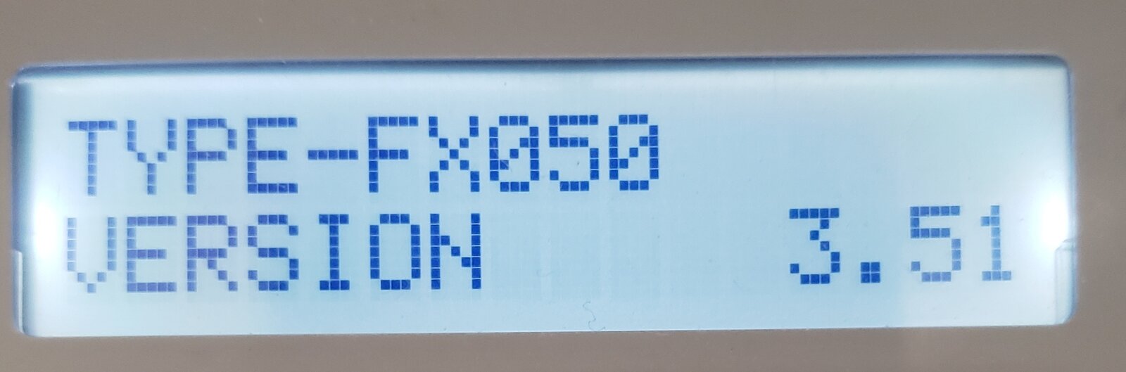

The Flex panels can be updated with a mini USB lead and windows flash software. Select menu 23 and press star to see the part number you need. The latest for Flex V3 is 3.54. pm me the part number and I'll send you a link.

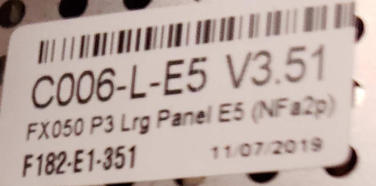

"Select menu 23 and press star to see the part number" This step provides the actual F182-XX-351 part number where XX may vary depending on country code. Please perform this step.
V4.10 of the A083-00-10 will hang/crash randomly when you use reporting or app control. You need V4.16 which is the latest. Unfortunately, the older V4.10 board cannot be flash upgraded.
No f182xxx in the menu 23,only this
The f182xxx info finded is this

I'm not sure what you're doing, as pressing the '*' key will display the part number when you are in menu 23. It doesn't matter now, as you've shown it's E1 country code on the PCB label.

Pfffff.... I've totally missed the star...
