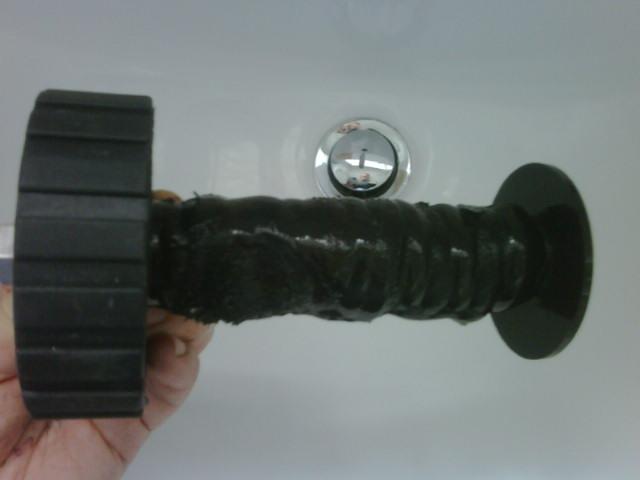

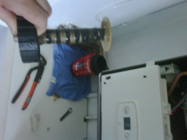

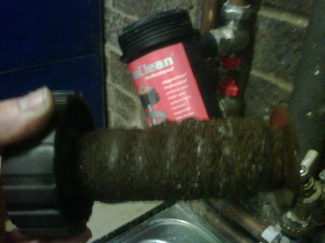

if you can afford to have a Magnaclean fitted as well, you will be surprised how much black sludge it captures, and it continues working permanently. Even the best powerflush will not get it all out.
This can prevent future accumulations and blockages
We did get a magnaclean fitted as well so hopefully our system is tip top now.
have you had a look inside it? It can be very satisfying to see what it has caught. I am a bit obsessive so I scrape my mum's Magnaclean into a glass jar and make a note of how much came out on what date. At first it needs doing every week or so, but after a while you can leave it for months. You will know, because it will be fairly clean, when there is not much sludge left for it to collect.
View media item 12015
View media item 12016
