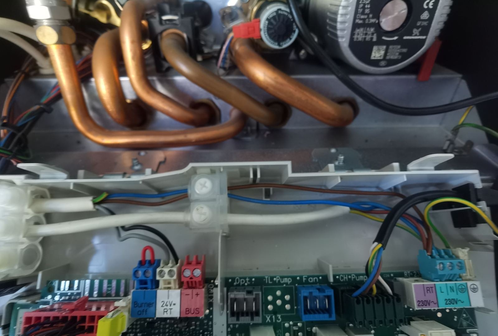

I'm unsure how to connect the circuit breaker (relay circuit) from the thermostat, so I have pictures from the boiler PCB and old thermostat with all connections in place.

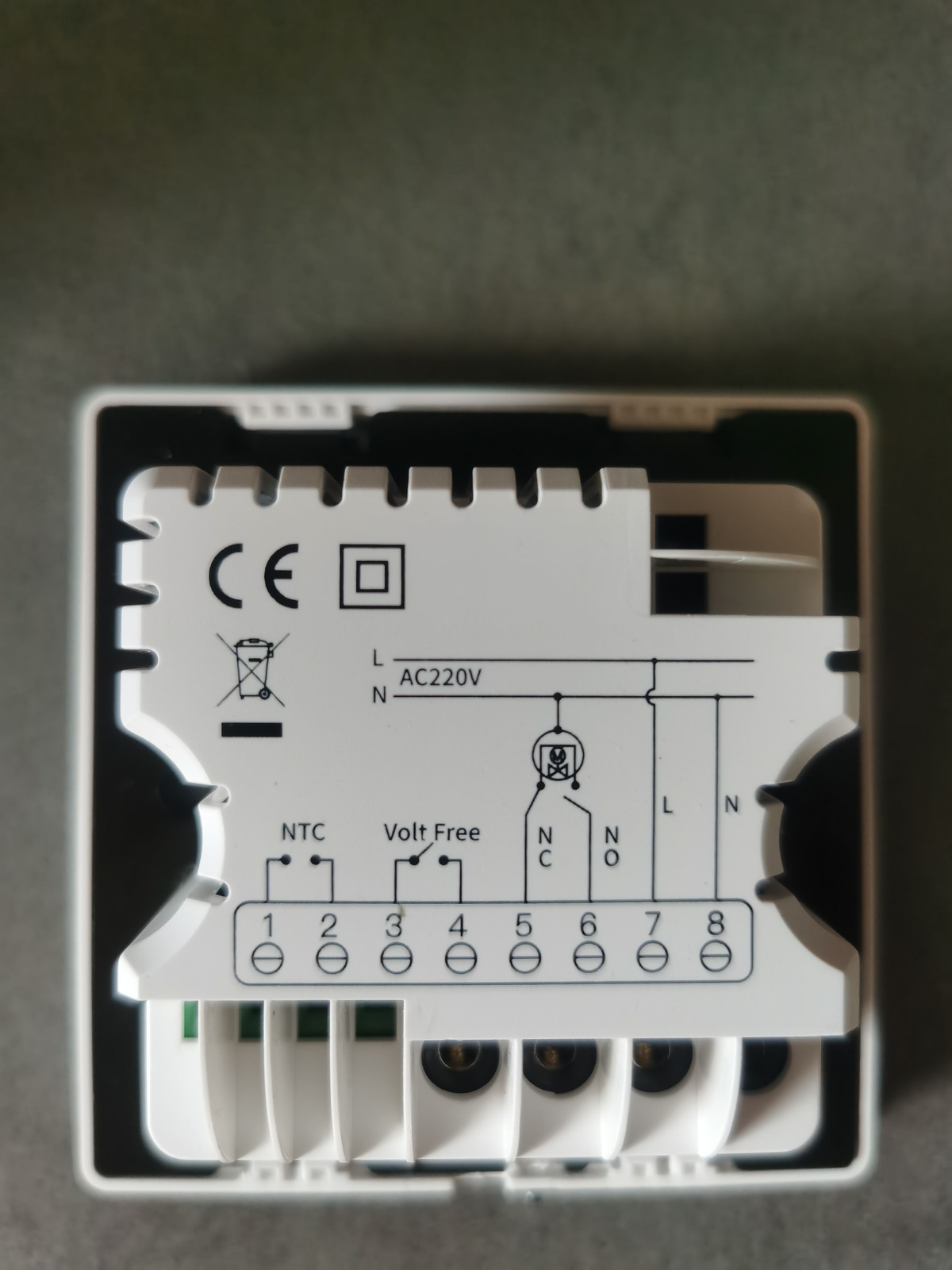

Here is the back of the new thermostat and pinout:
Here is the wire layout and pinout from the boiler PCB (the black and grey wires are routed to the old thermostat pins below). The thicker cable on the top goes to the Honeywell thermostat, picking up the mains and relay circuit wires. It seems that the relay circuit is rated at 24V.

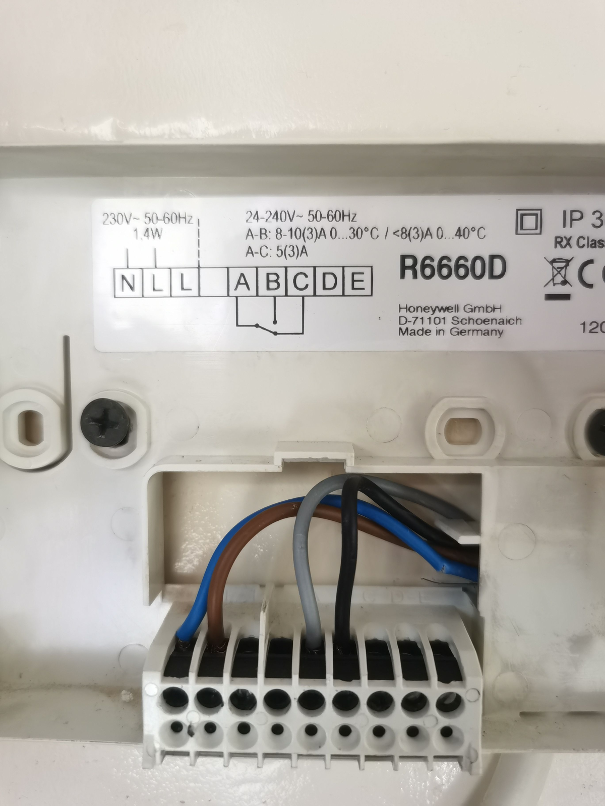

The old Honeywell thermostat connection from the boiler wiring (with wire colour matching and connection as above from boiler PCB)

It is very simple
L&N from existing thermostat to L&N on new one
Black and grey wires from old thermostat to 3&4 on new thermostat (either way round it doest matter) DO NOT make any links anywhere

Yes, that was the source of my confusion, primarily because o 24V label on the PCB connector. But, looking at the boiler manual, it doesn't need supply voltage indeed, so volt-free relay pins from the thermostat make sense.
On the boiler PCB, there is a separate 230V connector for the output voltage-based breaker (NO/NC).

So, all wired up (L+N -> L+N and no-volt grey->3 black->4 on the thermostat), but it's not closing the relay circuit on the boiler side (that's RT white connector on boiler PCB). In a way, I can hear the relay click on the thermostat, but the boiler heating pump is not starting.

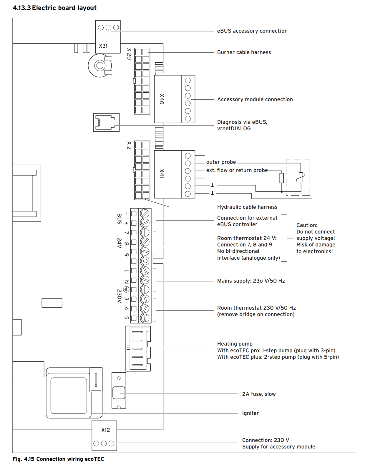

Sorry, which pcb do you have? You have posted a photo of the newer type with wiring on 24v and then a wiring diagram of the older type. Also your “smart” thermostat, I only count 7 terminals, have you definitely got them in the correct ones?

Is everything on at the boiler, like a time clock heating switch turned to on? Double check the wiring, on the smart thermostat photo, I only count 7 terminals as opposed to 8.

Right. All is good now. Grey wire was a bit worn and loose in the thermostat socket 3 - so the contact was off. With a fresh wire strip and a bit of tinning, connections are correctly secured now.
