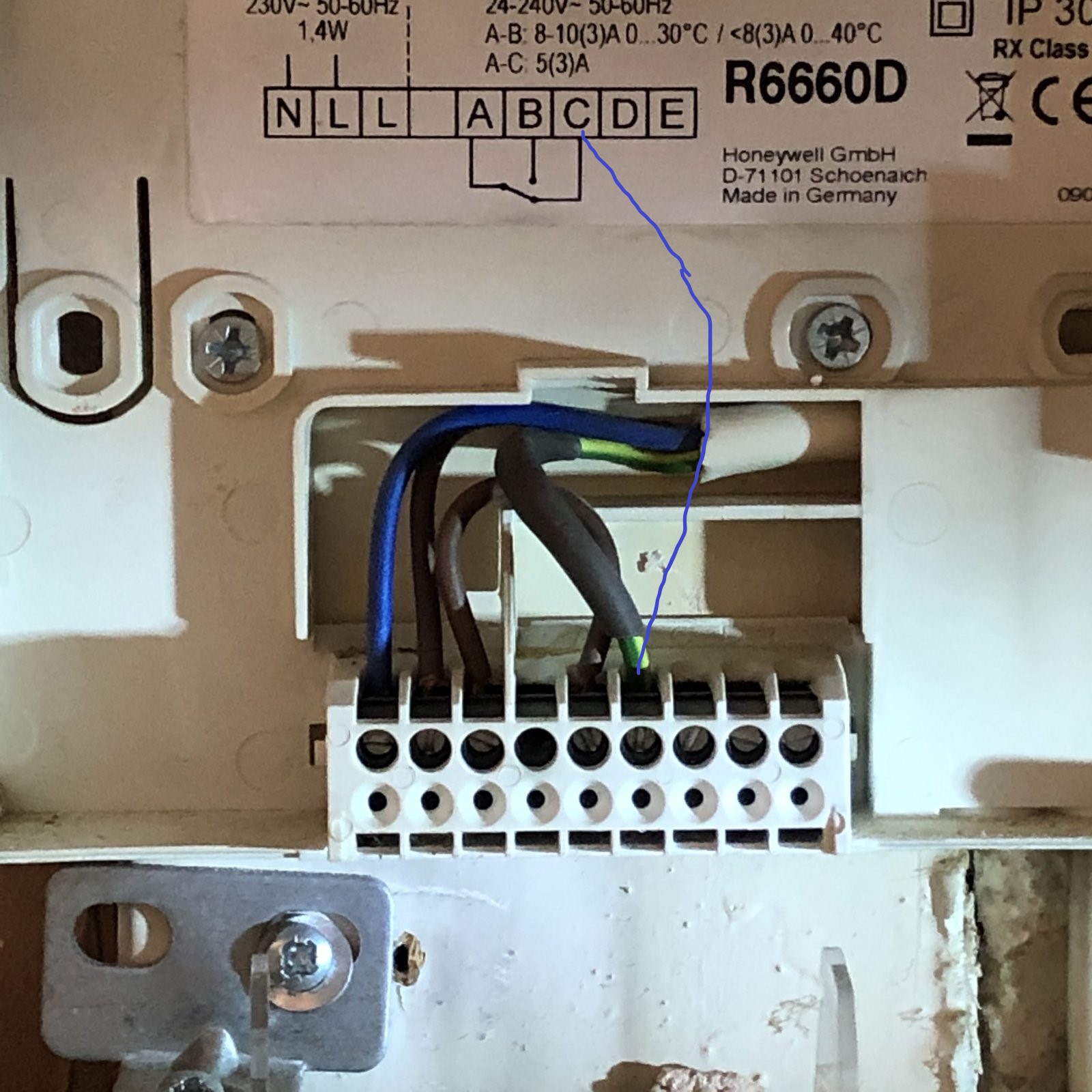

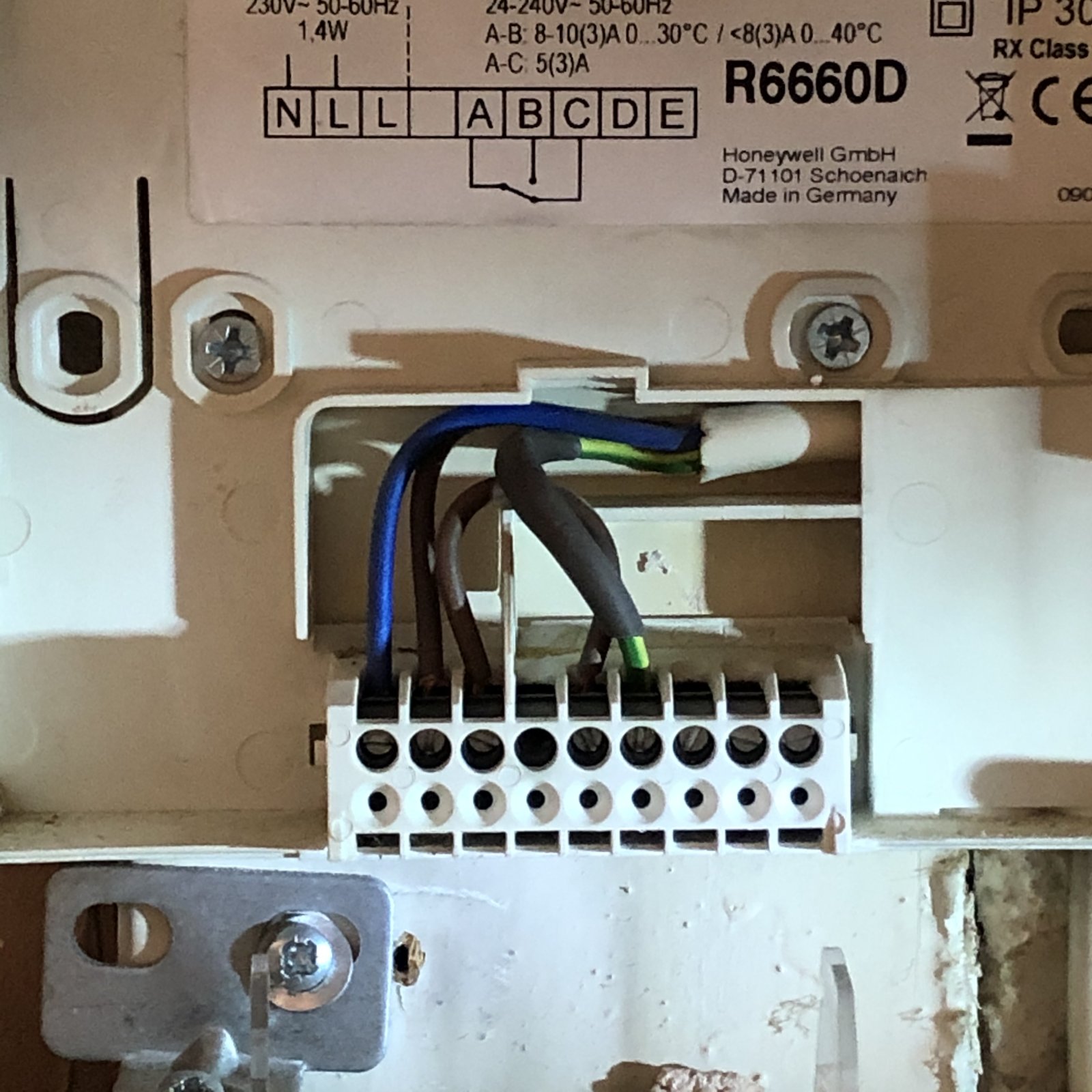

Hello guys, I am trying to figured out the wiring on my current Honeywell Receiver which works fine with my wireless Honeywell CM927.
I am confused with the current wiring of my receiver - please see pictures which I will attach:
current wiring:
N blue cable (I guess neutral)
L brown cable (I guess live)
L brown cable (this is where I get confused as this is a small brown cable connecting A to L like a loop cable)
A small brown cable coming from L as above
B green cable (I guess open wire?)
C empty
D empty
E empty
on my new nest heat link I need to identify the common and open wires from my current setup so I can carry on.
any help would be appreciated.
regards,
Seb.

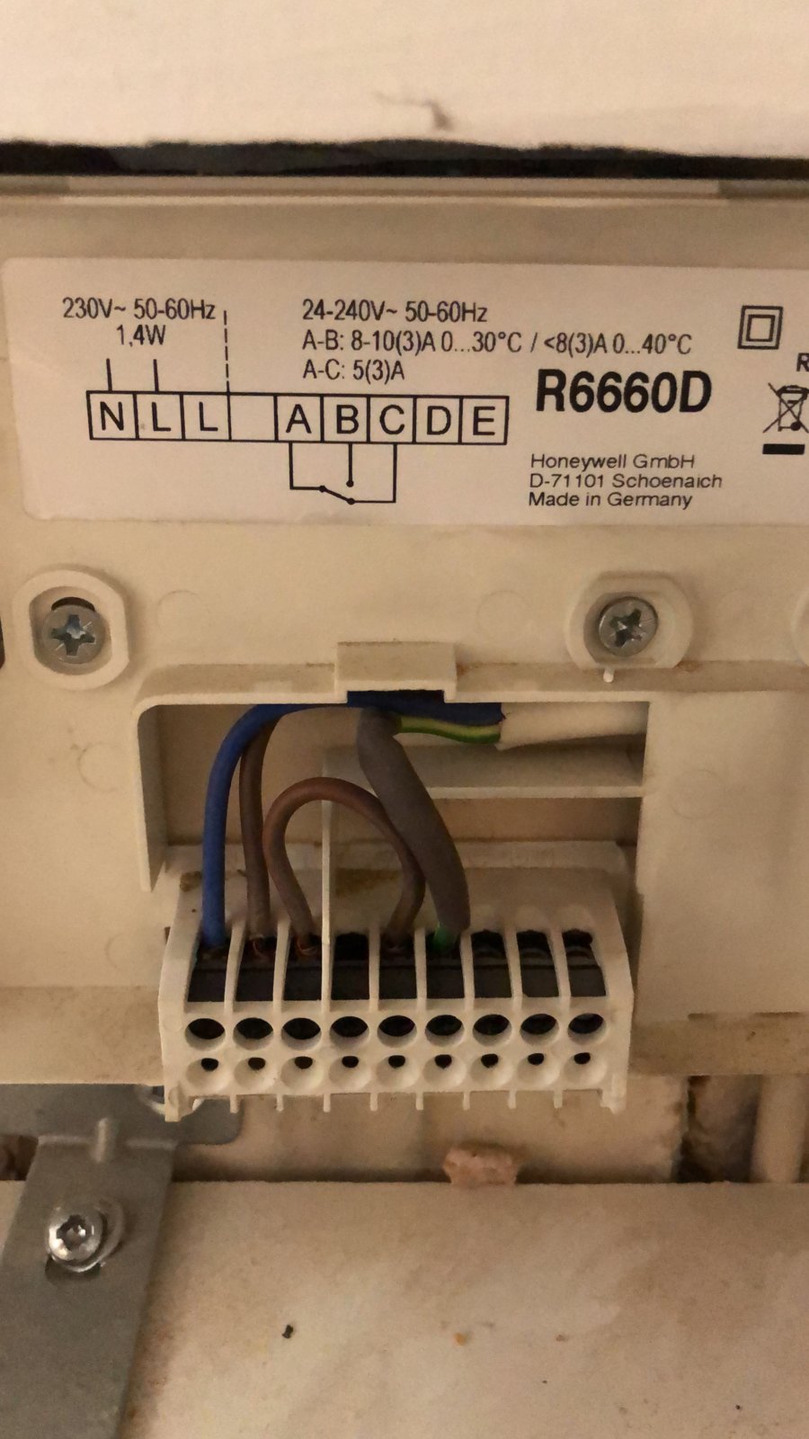

One more picture if it helps

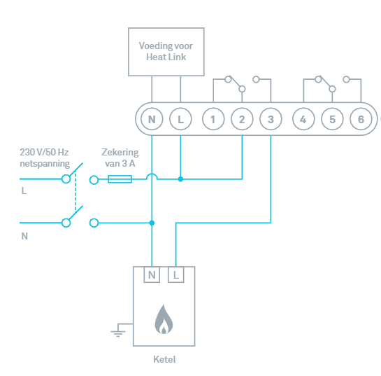

Couldnt be simpler but never go by wire colours on a heating system
honeywell Nest
N to N
L to L
Link L to 2
C to 3
If anyone can just confirm what’s the common and open wire on my current system that would be great. I want to make sure I understand current wiring to proceed with the next steps. Thank YOU in advance

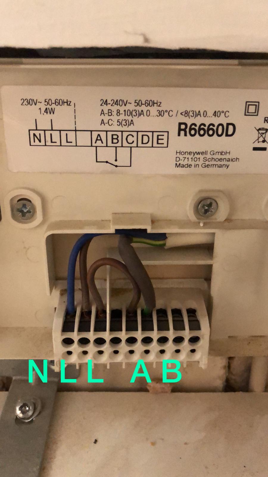

current wiring:
C empty
D empty
E empty

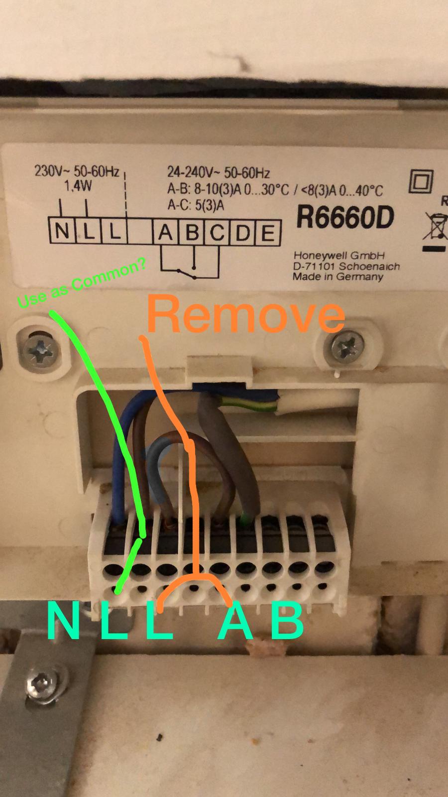

The two L terminals on the Honeywell reciever are linked together internally. The loop from L2 to A means that terminal A always has 240Vac on it. When the switch in the receiver closes terminal B (switched live) provides 240Vac to turn the boiler on.
Terminal C is used for cooling systems.
Thank you so much for all the answers, things are starting to get clear in my diagram mind :)
As per what D_Halisham said I will then use the brown cable currently connected to L1 as my common wire and the cable connected to B my open wire, therefore the small brown cable connecting L2 to A can be just removed.
I tried to draw what I will be doing just to confirm if anyone can please confirm it that would be great. I don’t want to try anything before I am 100% as wife already threatened me with a divorce depending on the outcome....

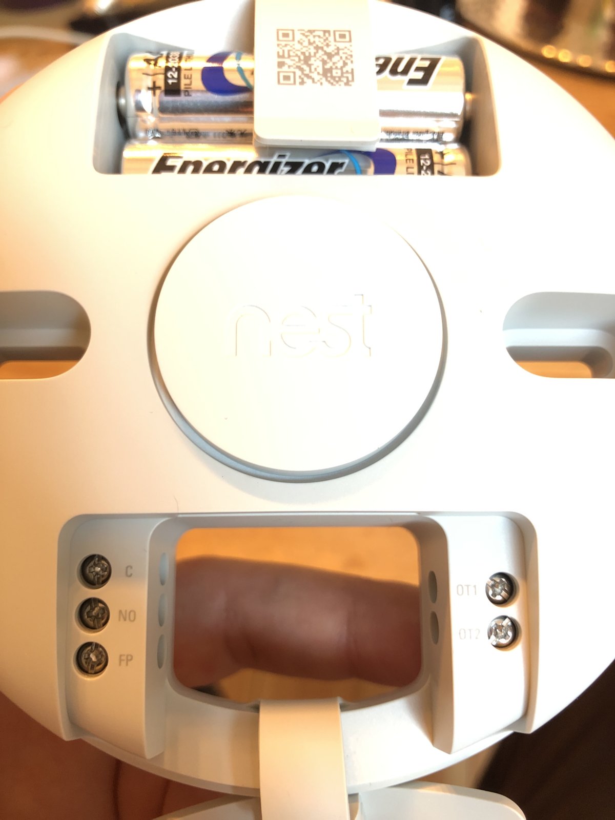

my new Nest Thermostat only requires two cables (Common and Open) therefore N and L1 won’t be used from what I understood - I will use the terminal blocks to isolate them.
Link L to 2 means I will connect L to Common socket on nest?
€ B to 3 means I will connect B to NO socket on nest?
I didn’t understand what numbers 2 and 3 meant on your earlier post. I will post a picture of how Nest thermostat sockets are arranged.
