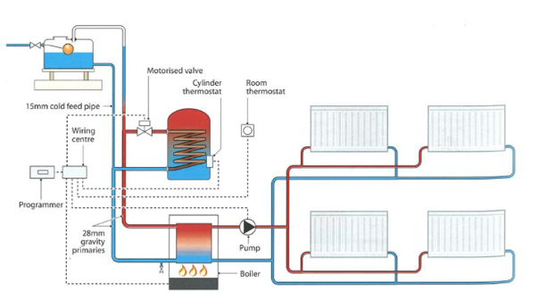

Hi all, I've recently moved into a house that has a Thorn Housewarmer 30/45 back boiler. Gravity HW and pumped CH.
Currently, the HW comes on with the heating and I would like to be able to control them independently. I have an electric shower and no need for a cylinder full of hot water. My understanding is that changing to C Plan by fitting a 2-port valve and cylinder stat would allow me to do this.
I've already flushed out the rads and fitted TRVs to most (except hallway where the thermostat lives, and bathroom) and have a Nest thermostat fitted, wired so that the HW comes on with the heating as per the old Randall programmer it replaced.
I'm not overly familiar with back boilers so just wanted to be sure of the basics - would I have any issues in replicating the following? Where does the heat in the HW circuit go when the valve is closed?
(Does it mean that the boiler fires up for less time when there is a CH demand as energy isn't lost to heating up the HW...?)
Valve and cylinder stat aside, that's a pretty accurate representation of the system I already have in terms of how it's piped up. Is there a better way of achieving what I'm looking to do that doesn't involve a great deal of upheaval? Not looking to change the boiler but instead do the best with what I have.
Thanks in advance
It wouldn’t meet current building regulations. You could upgrade to a modern S plan or Y plan and just not have hot water on for long?
Fitting a motorised valve where you indicate will be accurate as per C plan but this valve will need to be 28mm or 22mm with head replaced (6 wires- end of travel switch needs to have orange, grey and white wires). A relay would suffice too if standard 22mm MV used.
Just fitting cylinder stat will allow hot water temperature control during summer and also enable use of controller in winter ( as no interlink to fire boiler when ch selected). Can do drawing for this option
Keeping present system, upgrading controls to higher lever, you will have an old system that is bombproof built likea brick outhouse, no current boiler has facilities that you will have.
