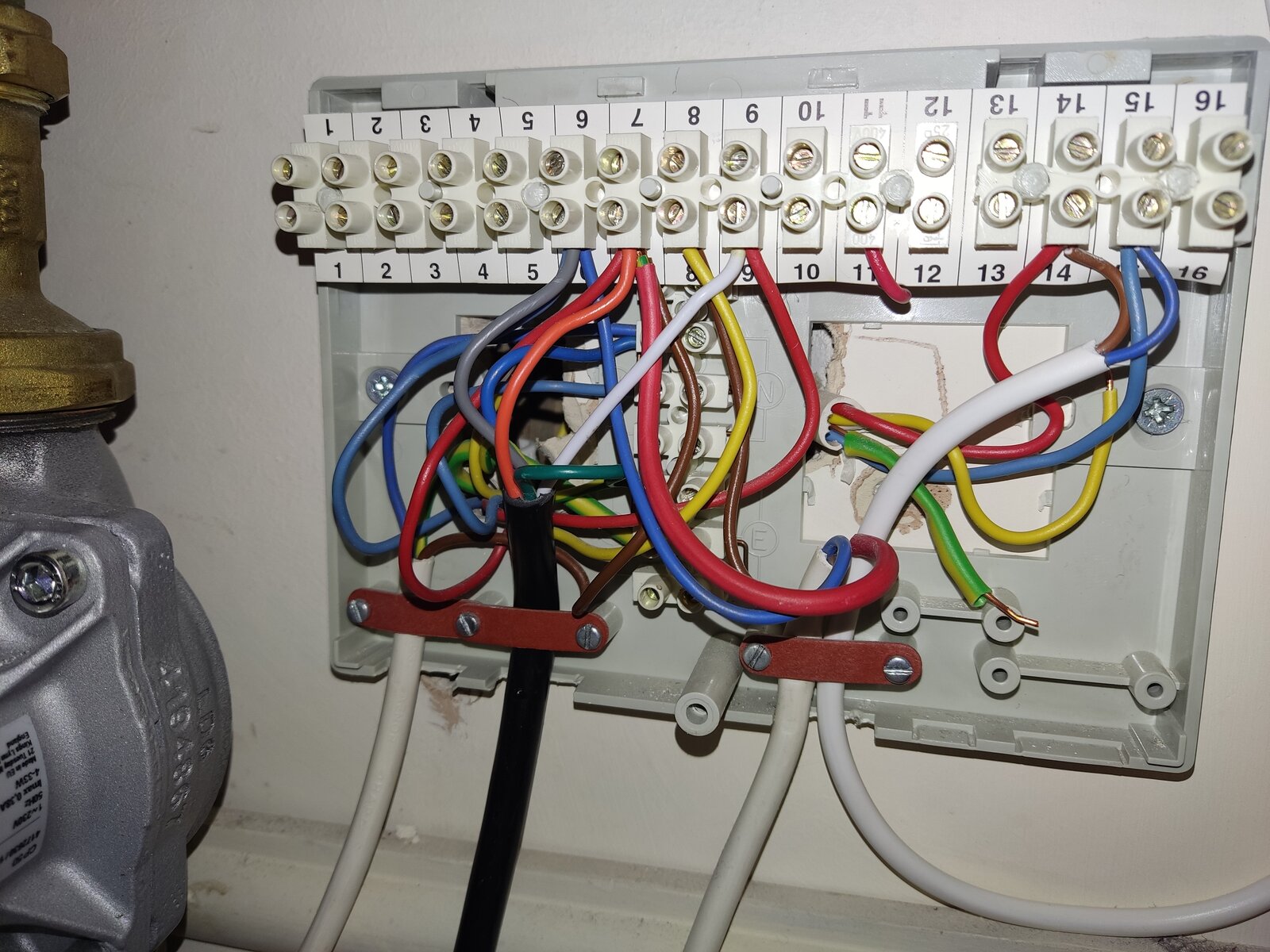

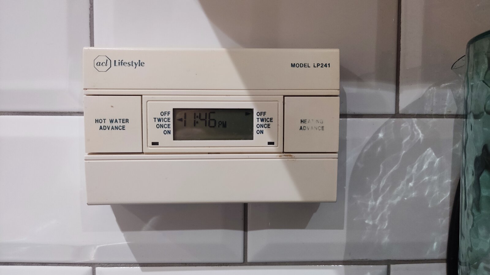

I believe I have a Y plan system (a 3 way valve is located in the airing cupboard upstairs along with the pump and 'wiring centre'. The LP241 is located in the kitchen about 2 meters from boiler and the thermostat is in the hallway, ~2 meters from LP241.
Here are some pictures of my current setup (I am not responsible for the existing installation!)
LP241:
Note the 'interesting' way the L wire is connected ^
Wiring Centre:
Thermostat:

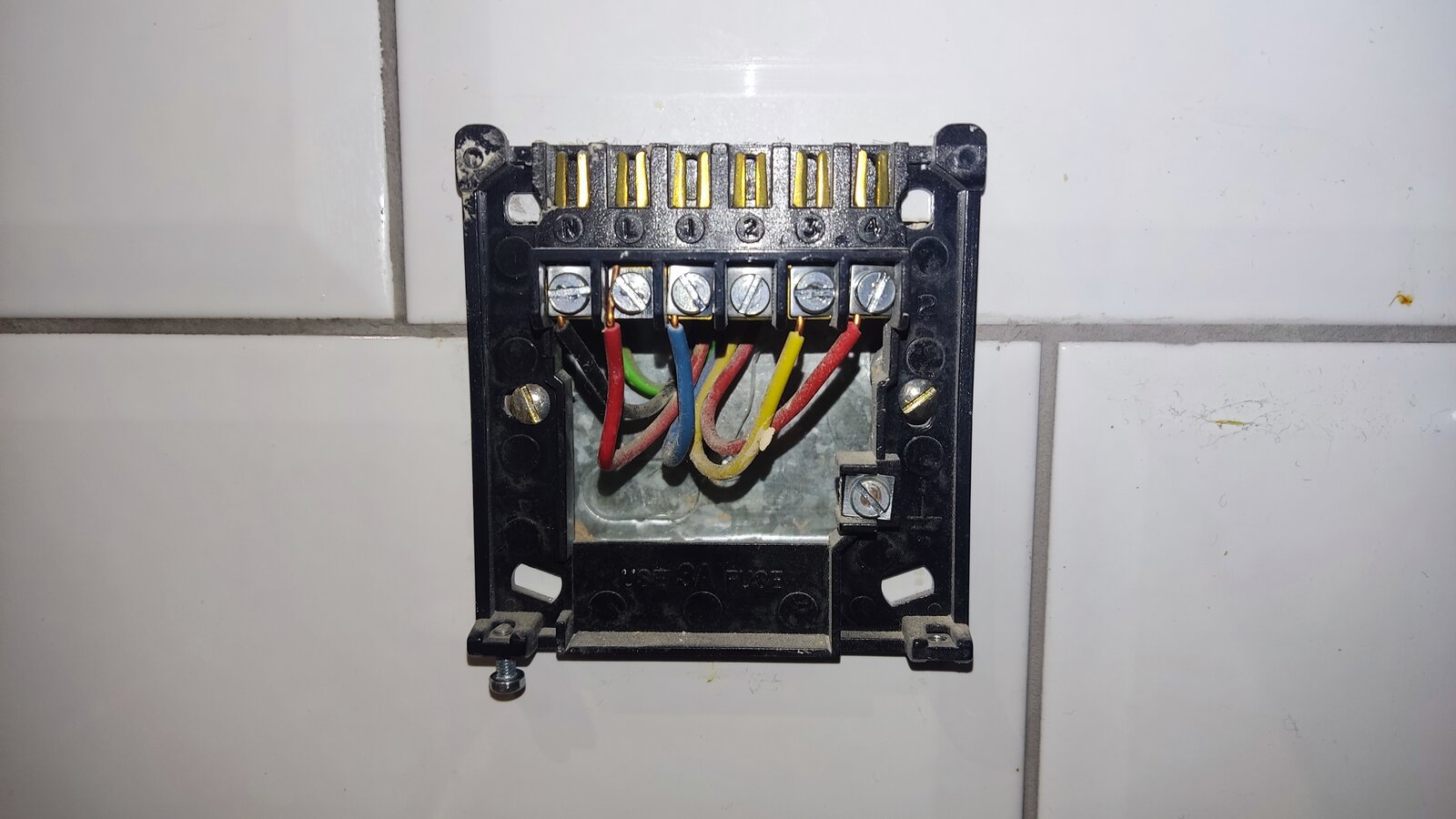

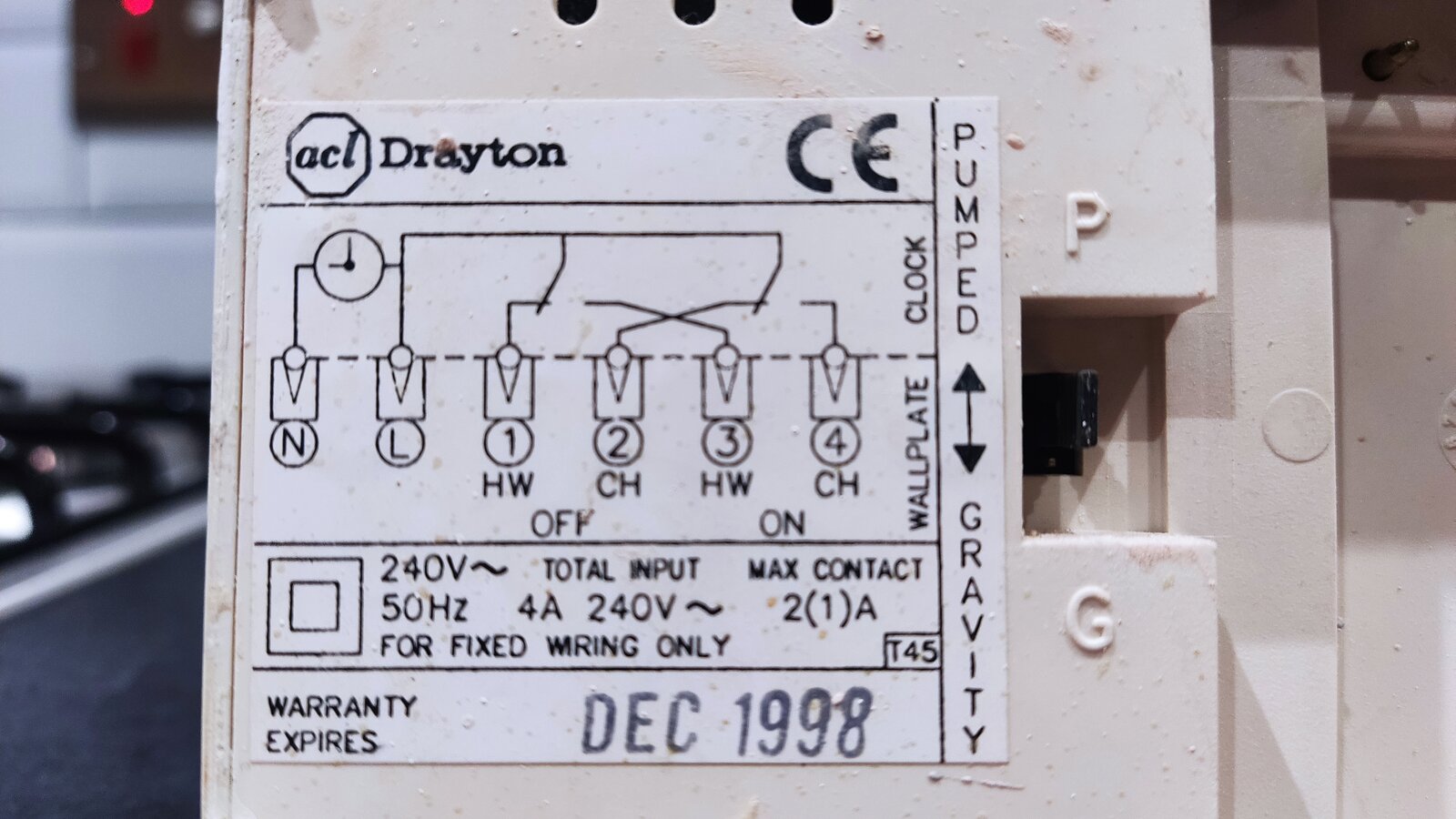

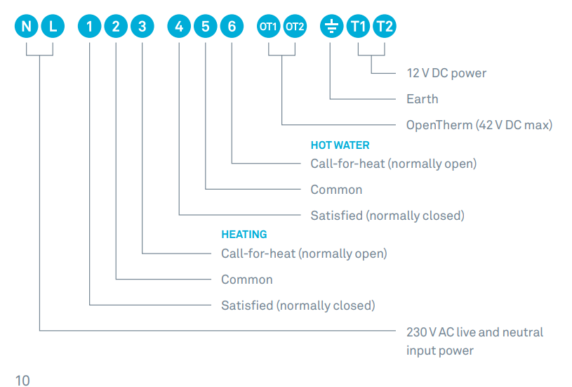

Initially I believed the wiring to the LP241 is wired to the nest as follows:
LP241Nest Heat Link
NN
LL
1 (HW OFF)4 (Hot Water Satisfied)
2 (CH OFF)1 (Heating Satisfied)
3 (HW ON)6 (Hot Water Call-for-heat)
4 (CH ON)3 (Heating Call-for-heat)
Additionally a link is needed between Terminals L, 2 & 5 on the Heat Link.
But why is nothing connected to Pin 2 of the LP241?
I was hoping I could power the nest thermostat from existing wiring utilising terminals T1 & T2 on the Heat Link, but I don't think this is possible. It isn't immediately obvious to me how the system operates.

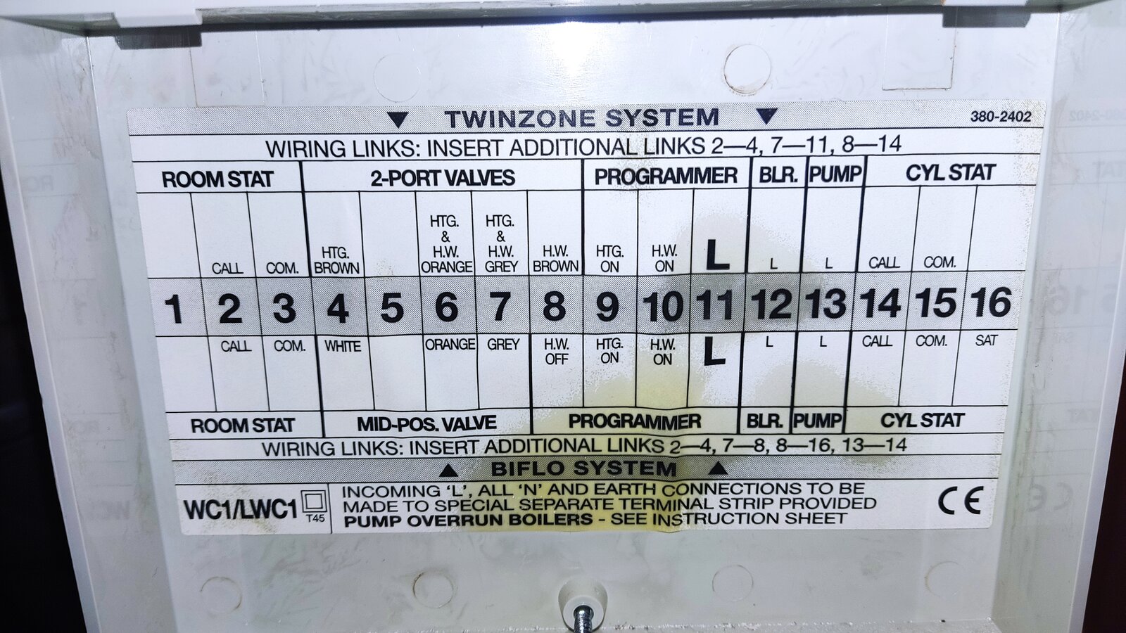

It depends on the requirements of the heating system components. Terminal 2 isn't used because the Mid Position valve doesn't need it. It knows where to position itself using the CH ON / HW ON and HW OFF. [Many installations don't use terminal 1 HW OFF either, but yours does]
T1 and T2 at the Heatlink connect to T1 & T2 at the Nest thermostat. You can use the old thermostat wiring, but it must be completely disconnected from the mains as T1 & T2 are only 12v.
This can be done by disconnecting the existing room thermostat cable completely at both the thermostat and wiring centre ends. At the wiring centre end, a link must be inserted between the terminals that the red and yellow wires are removed from to complete the circuit. Once the cable has been completely disconnected from the mains wiring, it can be used for the T1 & T2 connections.
By the way, the original installer hasn't stuck to the lid nomenclature when wiring the system up, which isn't that unusual. So it will be necessary to identify any wiring by what's on the other end of it, not what's printed on the lid.
LP241Nest Heat Link
NN
LL
Yes, that would be correct, excluding terminal 1; heating satisfied is very rarely used.
If you intend to use T1 an T2 to power the thermostat, you would also need an earth connection to the HeatLink earth terminal.

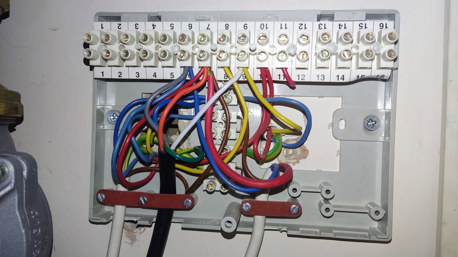

I believe the cable to the LP241 is hiding behind other wires in the wiring centre - I think this is the cable to your existing thermostat, could you confirm?
If so the red wire coming from the left of the image in terminal 10, would be moved to join the white wire in terminal 9, bridging out the old stat.
The cable could then be reutilised for T1 and T2, but you would still have to find a neat way of getting another cable from the HeatLinks new location, back to the wiring centre (to join up with the old thermostat cable).

You wouldn't have any spare wires in the current LP241 location.
The alternative would be to site the Heat link next to the wiring centre and decommission the LP241 wiring.
You can use the existing thermostat cable as below where it runs from the old thermostat. You might have to extend it at the other end to reach the Heatlink though.
It would be good to make the link anyway to decommission the old thermostat properly, if it was left in circuit it could end up interfering with the operation of the Nest.
The cable you circled is indeed what goes to the thermostat
I confirmed this by connecting the blue and red wire together at the wiring centre (power isolated at the fusebox) and then did a continuity check at the thermostat and got a satisfying beep.
I have noticed that the wiring centre is not permanently live, so my plans of adding a 240V>24VDC power supply won't be so easy. There are nearby sockets that I will be able to spur off. I'm not entirely sure if what I'm suggesting is 'legal'

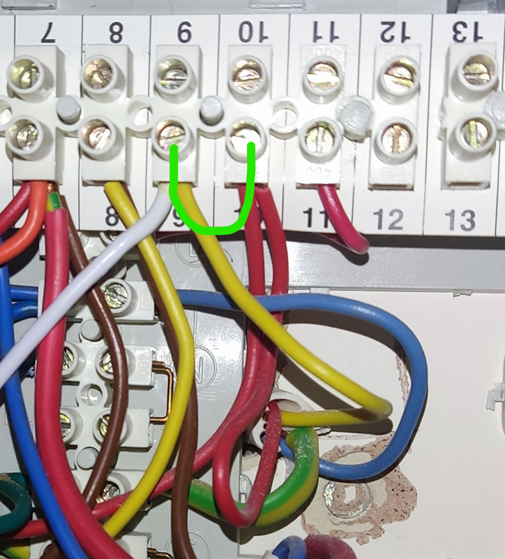

Is that what you mean? Adding link wire between terminals 9 & 10? (obviously after removing yellow from terminal 9 wire and the rightmost red wire from terminal 10)

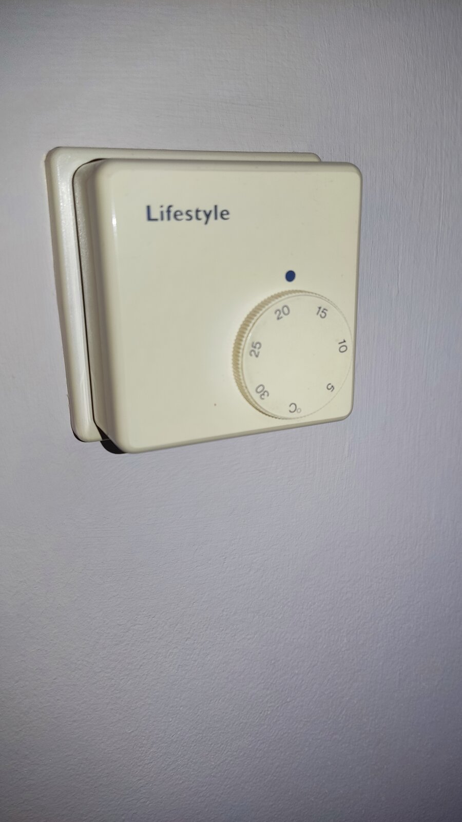

What does this link wire do?

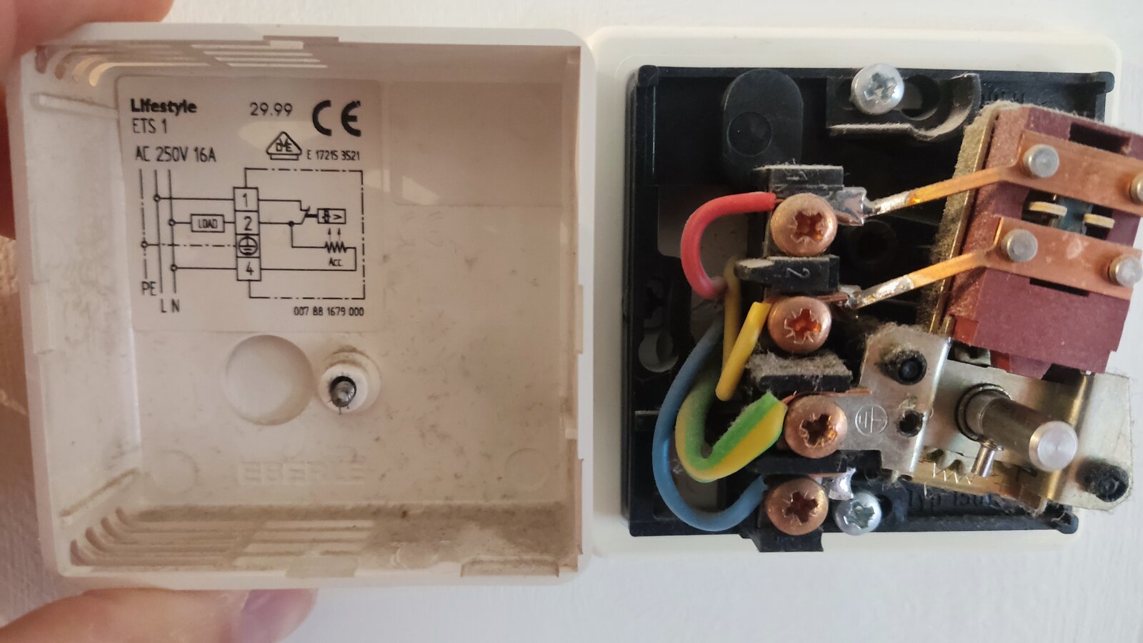

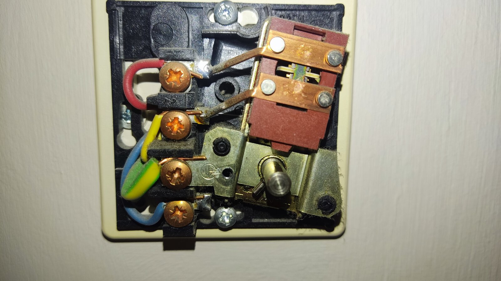

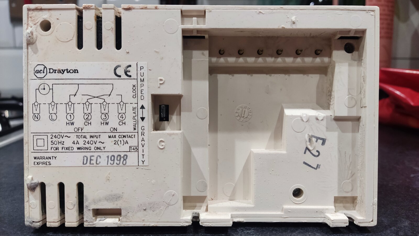

Edit: I thought it might be useful if I added an extra picture of the thermostat wiring I found inside the thermostat cover:

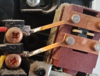

The thermostat has a contact (switch) inside that opens and closes. This is it:
When the contact is closed, the red and yellow wires are electrically joined together and the heating comes on. When the contact opens the wires are no longer connected and the heating goes off.
If the thermostat was just removed and there isn't a link added, electrically speaking it would be exactly the same as the thermostat being 'off' and the heating won't operate, ever. Inserting the link completes the 'open circuit' and allows the Nest Heatlink to take over sole control of the heating.
The link you've shown in green is correct.
When the contact is closed, the red and yellow wires are electrically joined together and the heating comes on. When the contact opens the wires are no longer connected and the heating stops.

Instead of the link you could of course simply put the remaining white and red wires currently in terminals 9 & 10 together in one of the terminals, which achieves the same thing.
I have noticed that the wiring centre is not permanently live, so my plans of adding a 240V>*24VDC power supply won't be so easy.
Looking at your wiring centre, I think terminal 8 may be a permanent live.
But as I said earlier, it's a little difficult to tell, with the LP241 cable hiding.

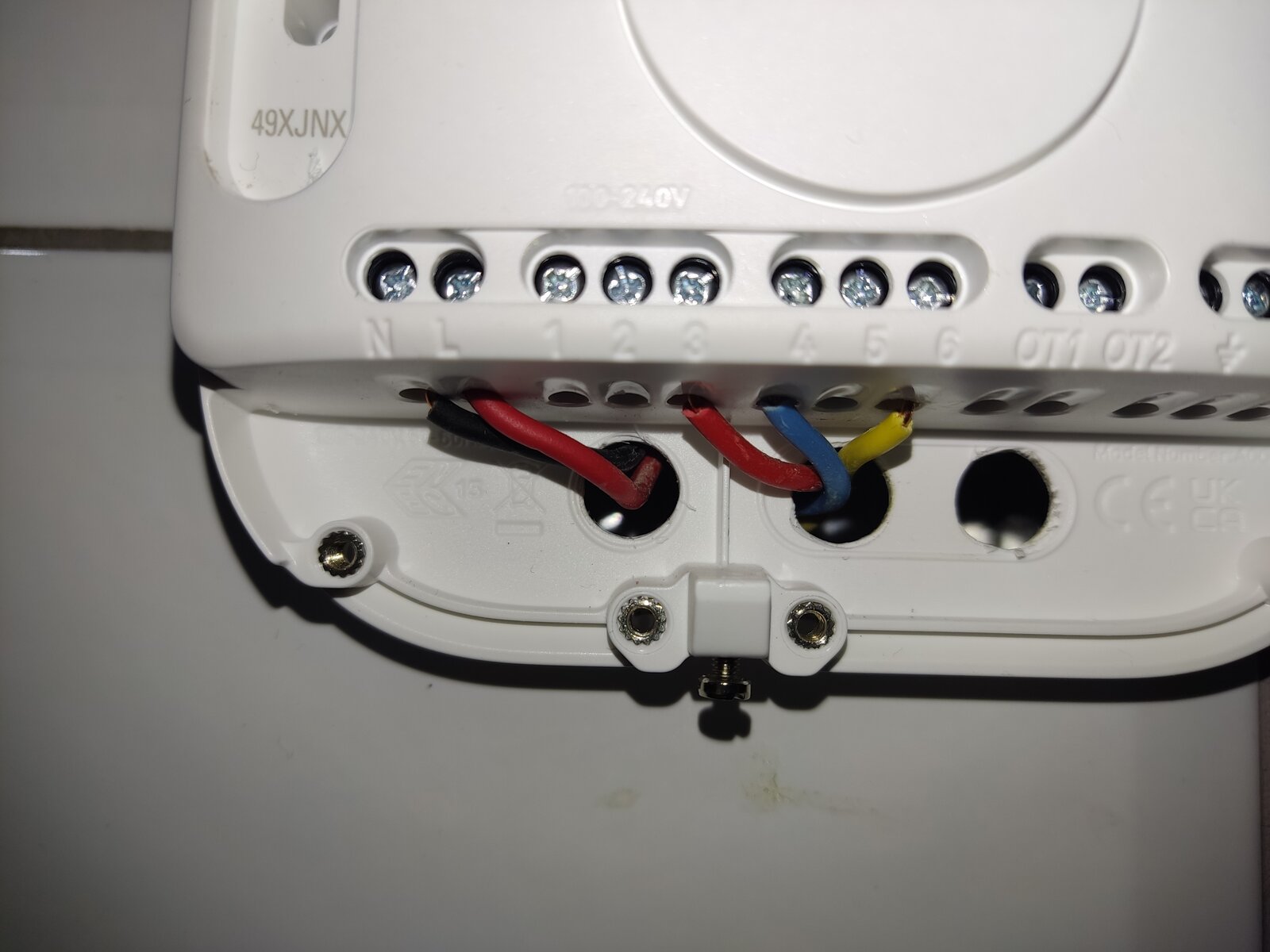

So, the Nest thermostat arrived today and I wired it as above. However it is not working at all. The nest is clicking on but the boiler is firing. The only changes I have made to the wiring centre is removing the 4 wires that went to the thermostat and moving the remaining red wire in terminal 10 to terminal 9 to link out the thermostat.
Here is the wiring of the heat link:
And the wiring centre:
Note: I utilised terminals 14 & 15 to provide 12VDC and wired the red and blue wires that went to the old thermostat to power the nest thermostat.
I'm a bit stumped...
Edit: it's probably worth pointing out that exposed wires in the wiring centre (which are the remaining 2 wires used for the old thermostat) are isolated. I plan to trim the exposed copper, tape and label them. I'd rather keep them than cut them off completely.
Add short link wires between L, 2 and 5 in the Heat Link.
And just to tidy up, park the loose thermostat wires in a spare terminal - you don't want them touching something they shouldn't.

DOH! I even wrote that in my first post. How did I miss that?!?
I'll add and report back (and show my tidier wiring centre wiring
