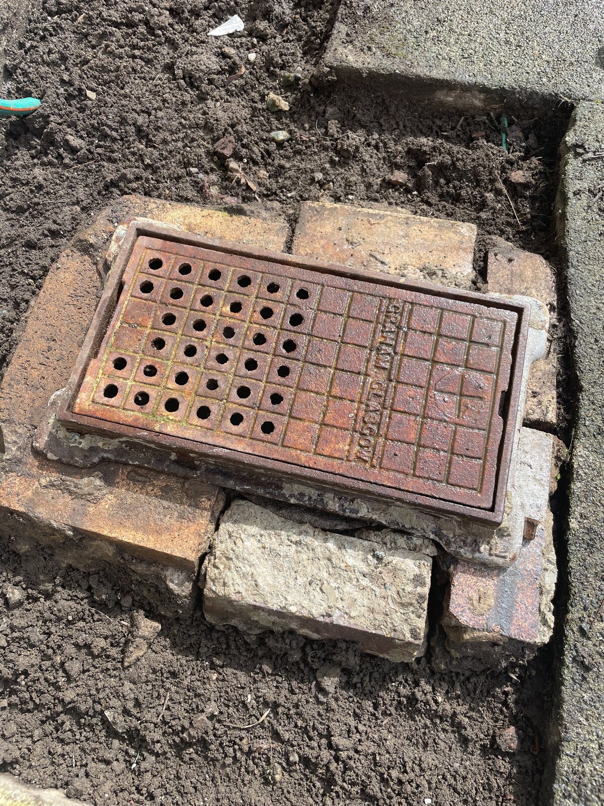

I’m wanting to upgrade my outdoor gully cover that takes away my kitchen waste water.
the pipe itself is 8” is there anything that I could just slip over this?

I don’t think it’s broke but I won’t be replacing anything just yet, I’m just wanting to cover it with a new housing but was unsure of the name of the parts I’m after
Circular cast iron gulley Grids - they come in various sizes. Just google for them.

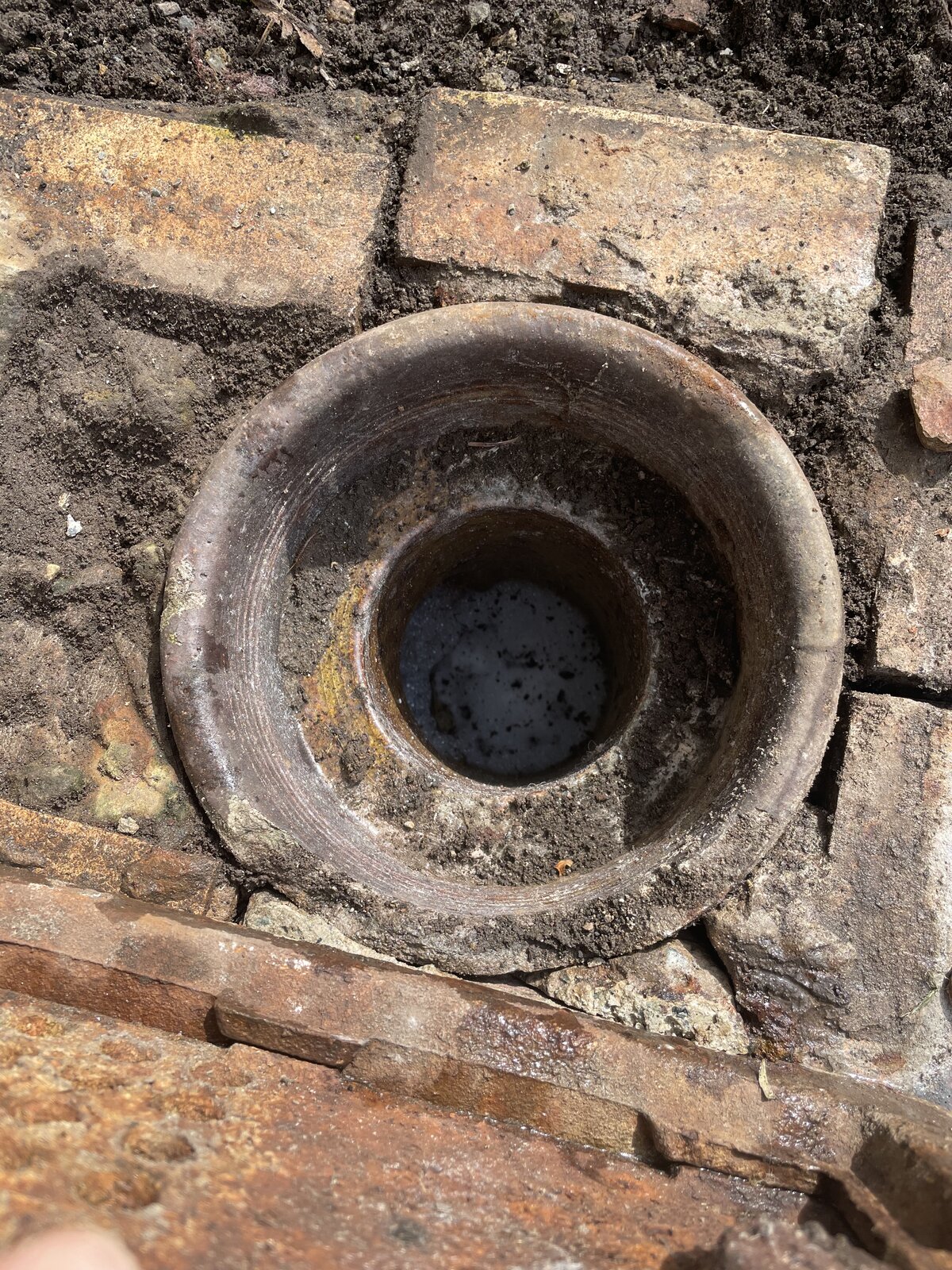

Your upstand chamber shows water so reach down with a gloved hand and clear any silt from the bottom.

All I can see are the grates, is there anything that I can get with a housing also? So it can cover the 8” pipe.
So I shouldn’t see any water in the pipe?
Your upstand shows a socket end, the socket acts as a limited kind of hopper.

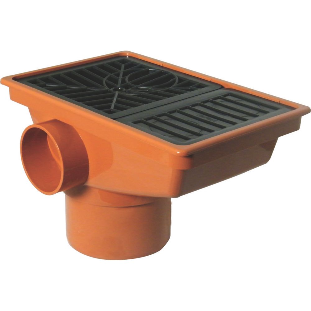

Check hoppers - one of them with a "housing" might squeeze into your 8" diameter?
If its for a Soakaway then no water should be seen - the upstand goes into a bend and drainage.
If the gulley is connected to the sewage system then the upstand drops into a trap with water in it 24/7.
What's the diameter of the pipe, (not the socket)? Assuming 4", try a McAlpine DC-11 into that, then a gully hopper into that.
