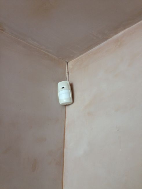

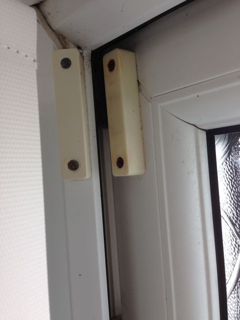

We have an old system in place (Scantronic 9448+). It's a wired system. I don't know exactly how old in it but the battery has a 1999 written on it :)
In short we'd like to upgrade it.
  1. What would an upgrade entail?
I would imagine a bit more than taking the box off & putting a new one on?
2. This one is going to be a bit of a dummy question - but who do you get out to do the job?

When I replaced my old Galaxy system for a more modern Galaxy system it was pretty much a case of taking the old box off and fitting a new one. I've no knowledge of Scantronic systems but there's a fair chance you could do the same.

If you already have the wiring in, that's 9/10 of the work of installing a wired system. A wired system is vastly superior to wireless units which need regular battery changes. Just get a modern control unit and sounder box, the wiring hasn't changed significantly apart from some units being resistance-sensing and hence requiring a resistor at each sensor. Unless a cowboy made a hash of the previous wiring, of course, but it should be easy enough to see if it's a competent job. Is there a cable for each sensor for example, or have they been daisy-chained, making it hard to find faults? As for who, depends very much where you are.
What Anteaus said is good, but unless you need lots of extra features or the panel you have is faulty, then why not keep the panel and upgrade everything else. Scantronic is on the whole a good reliable make.
I have no idea how the sensors have been put in to be honest with you.
When you say upgrade "everything else" - do you mean the window sensors & PIR sensors?

To be fair the battery should be long since dead, remove the battery, check the fuses and power it up, do you have the codes for the panel?
As long as the wires are good, upgrading could be relatively simple as replace panel, keypad and battery and do some programing.
Take a picture of the wiring and label the cables if you can before dismantling, will help when putting into new panel.
Understanding the programing options is probably the most difficult part.
