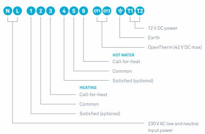

The LP522 wiring terminals are thus:
The existing wires are simply moved from the terminals of the LP522 to the terminals of the Nest Heatlink that have the same function. Don't worry if there are some terminals that do not have wires connected to them, if your system doesn't need them now, you won't need them with the Nest.
So:
LP522 N = Heatlink N
LP522 L = Heatlink L
LP522 1 HW off = Heatlink 4 Hot Water Satisfied
LP522 2 CH off = Heatlink 1 Heating Satisfied
LP522 3 HW on = Heatlink 6 Hot Water Call for Heat
LP522 4 CH on = Heatlink 3 Heating Call for Heat
The Heatlink common terminals (2 & 5) need to be linked to Heatlink L
The Nest Thermostat can be powered by wiring it to Heatlink T1 & T2 terminals, or alternatively by using a separate plug in 12V power supply for it.
