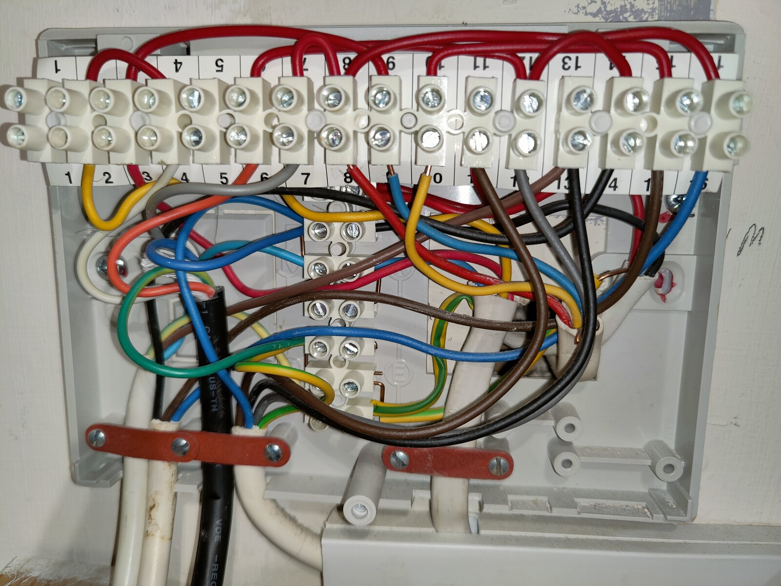

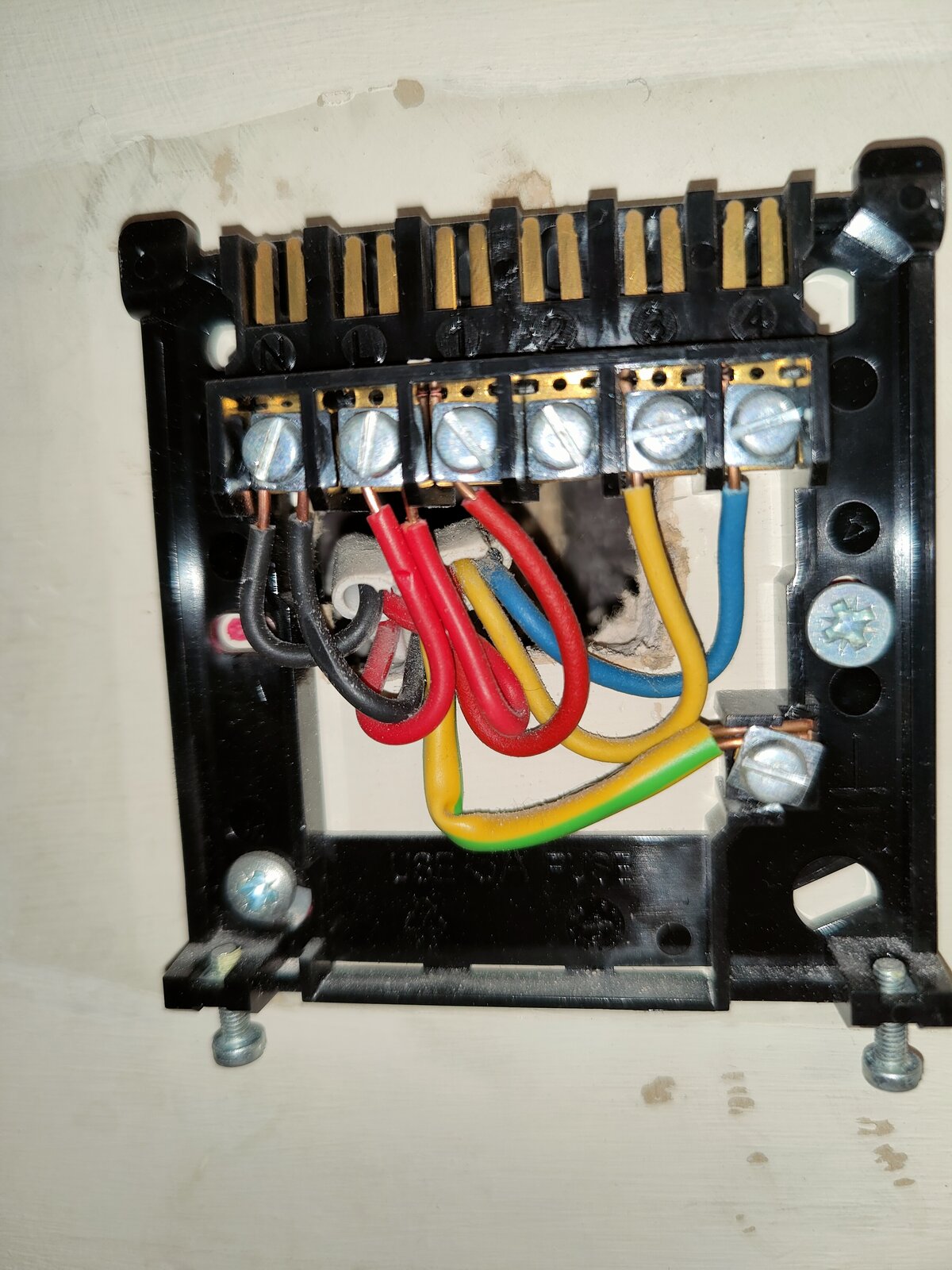

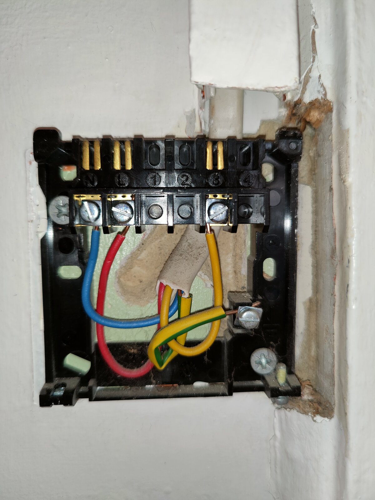

So I'd like to upgrade my existing programmer and stat to the Nest 3rd generation I have.
The wiring for each is below, I'd like to replace the LP522 with the heatlink directly, and the old thermostat with the nest stat (I know I need to alter the wiring so that it's wired into the heatlink and not the 240v).

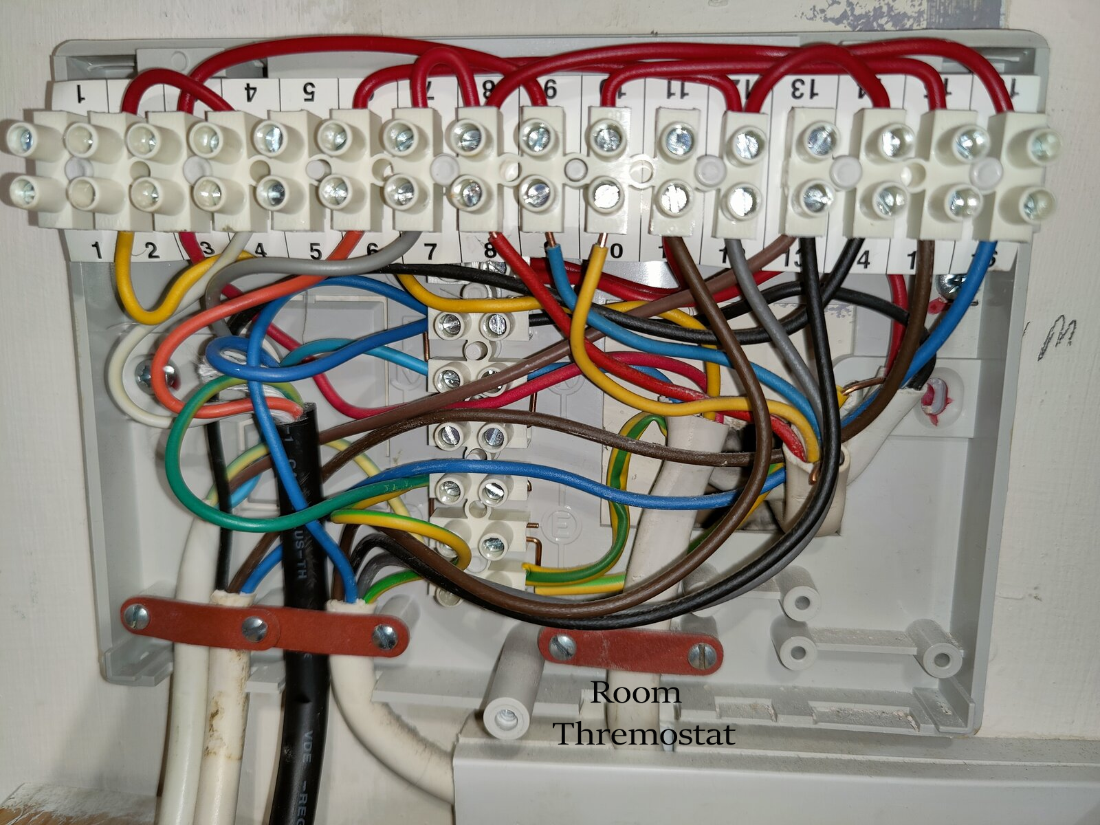

I have included pics of my existing wiring, is it simply a case of moving the correct wires from the 522 into the correct ports on the heatlink?
Are the thermostat wires easy to identify from these images?
Cheers in advance!

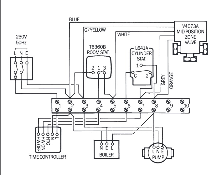

One image looks like you have an S plan (x2 motorised valves) and another looks like you have a Y plan (one motorised valve).
Since the heat link does thermostat and programmers job either the old thermostat set to max, shorted out, or some change in wiring.

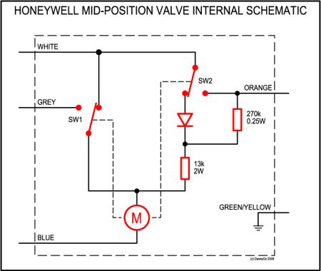

Looking at wiring centre the only colours you can trust are the colours from the motorised valve.
White = 4
Orange = 6
Grey = 7
It would seem you have a Y Plan, Y-Plan.jpg so a mid position valve mid-position-valve.jpg and so likely Orange with go to boiler, White to room thermostat and Grey to cylinder thermostat.
Some of the links I can see, white links to 2 for example and to yellow so this matched up with the yellow shown at the room thermostat, so following the yellow you can identify the room thermostat cable
This means you can link out room thermostat, however can make errors working from pictures, so better if you trace wires and confirm what I think is the case.

The first image is the stat wiring, the second is the LP522 wiring and the third is the wiring centre
White = 4
Orange = 6
Grey = 7
It would seem you have a Y Plan, View attachment 264709 so a mid position valve View attachment 264708 and so likely Orange with go to boiler, White to room thermostat and Grey to cylinder thermostat.
Some of the links I can see, white links to 2 for example and to yellow so this matched up with the yellow shown at the room thermostat, so following the yellow you can identify the room thermostat cable View attachment 264716

So if I remove the yellow and live cable from the room thermostat cable and out them into the t1 and T2 on the heatlink, that'll give me 12v at the room thermostat to install the nest stat at?
That is what I did, and was main reason for Nest Gen 3, I only have two wires between where boiler in and main house. But I did check them for dead before reusing them. My Nest Gen 3 heat link is right up against the wiring centre as the terminals in Nest are not big enough to take multi-wires.
Do I still need to bridge 2 and 5 to live on the heatlink?
