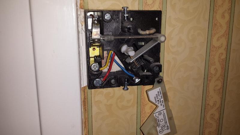

Most new digital stats only use two wires; you just make the unused third wire safe.

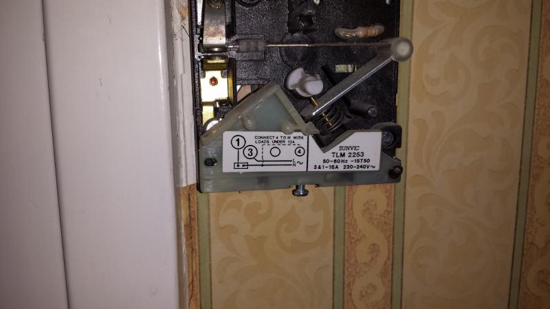

Yes, 3/red = live/common
1/yellow = switched live
The numbers I'm referring to here are on the old stat, not the Horstmann.
