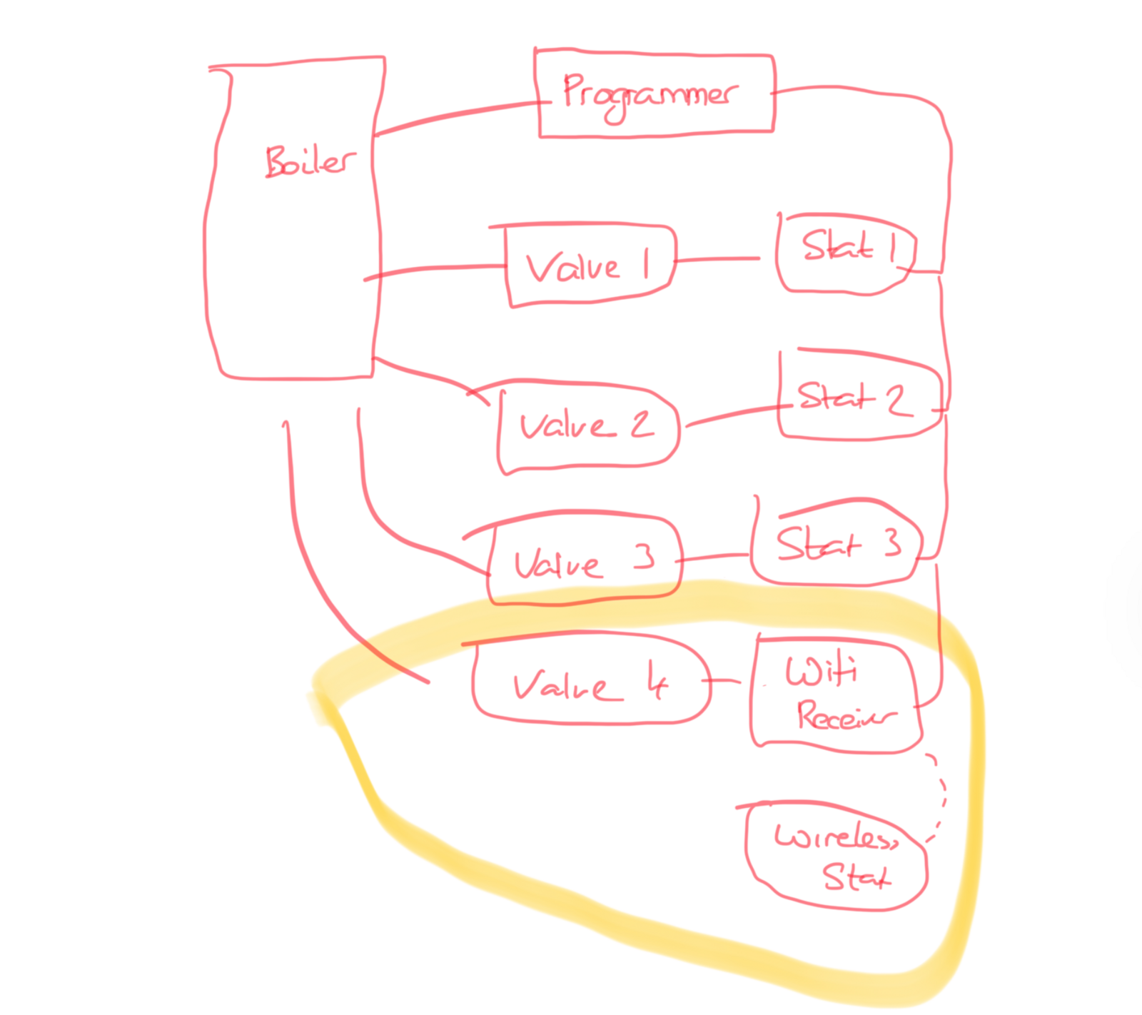

After some advice from people who may have encountered similar before. We’ve moved into a new property that has been developed over time. Part of the house is on modern Heatmiser UFH which works fine. The older part of the house is on traditional radiators, controlled by 4 thermostats and motorised valves, all operating through a Honeywell ST9400C programmer (also controlling HW).
3 of the stats are battery powered with two wires (live and I presume, live to boiler) - when the programmer is off, no power goes through the live to thermostat and then boiler. The 4th thermostat is wireless - when the house was renovated, there must have been an old stat where the UFH now sits so a wireless receiver was put in it’s place, controlled by a stat on the other side of the house.
I am looking for a simple replacement with smart system but the fact that one of the stats operates wirelessly when the others are wired is confusing me. I’ve experience with Tado in my last house which worked fine as do I with systems such as Hive. It seems pretty straight forward to replace the programmer with the central controller for one of these systems and the same for the 3 wired stats… but what about the 4th as it’s the wireless receiver thats needs replacing (and putting a stat on there would not work given it’s a completely different side of house)? I would presume Tado/Hive or similar would need the received installed too for this 4th stat but that would then end up running through the mail received (currently the ST9400C.

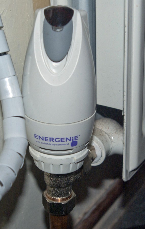

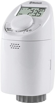

Using radiators we also use motorised valves, this type 1728815395008.pngis hard wired and has a micro switch inside to tell boiler when to run and is simple on/off, and this type 61dmtMm13BL.jpg has no micro switch and is analogue, so slowly turns the flow up/down, and the boiler uses the return water temperature to work out how much to modulate, (turn down) once the boiler has turned down to as low as it can go, then is starts to use a mark/space ratio, (turning on/off and adjusting the off time) but the boiler will not turn fully off.

Likely you do not need expensive TRV's in every room, in 2019 (before brexit) I got 5 of these 61dmtMm13BL.jpg bluetooth heads for £15 each, they use degs C to set them, and can be set as to when to heat and can also be manually set, which is important as likely not everyone in your home will walk around with a phone glued to their fingers, these IMGP8035.jpg were more expensive, and little can be set without a phone or PC, one of the few which can be controlled with a PC without an emulator, were sold as being compatible with Nest, but are not, so wifi rather than bluetooth so multi people can control then wireless and can be set to geofence using IFTTT, Wiser also use IFTTT to work the geofencing, the Nest works direct, but is useless as can't set the distance.

Hence, looking at the options of just replacing 4 stats with smart stats, programmer with smart programmer but that leaves the issue of the 4th stat which is wireless and how do we connect this… Can you hvae one receiver feeding another receiver on these systems?

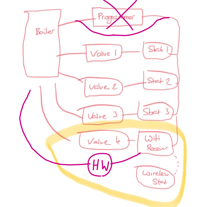

The Tado receiver unit will replace the main programmer but what would i then replace the wireless receiver with for the 4th stat?
You're over thinking this.
The Tado wireless receiver would replace the existing programmer.
This would control the Hot water.
The existing heating connection from the ST9400C would be 'linked out', i.e. all the 'wired' Tados, would be live, ready to turn the heating on whenever - there is no need for a separate programmer.
The C/H controls from the Tado wireless receiver, would link to the zone valve of your existing wireless receiver.
Ah, OK - this makes sense (I think!). So I hardwire the existing wired stats so they bypass the programmer all together - these are permanently live on one side. The wireless Tado system (plus receiver) would then replace the existing WiFi receiver and have HW connect to this too… corresponding WiFi receiver can then go anywhere…
To remove the existing programmer, I assume simply bridge the existing live into the STC9400 with the output to the stat (HW ON) and this then sits behind the new receiver (possibly a job for the electrician).
Basically yes, but 'anywhere' will mean a location between the ST9400C and the existing wireless receiver/zone valve/wiring centre (depending on what you have).
There is usually a mass of wiring behind the programmer, so it is normal for the new receiver to go there, but it really does depend on the layout.
If you would like to post a couple of pics of the location of the zone valves, receiver etc. and the wiring behind the ST9400C, we may be able to advise further on the wiring.

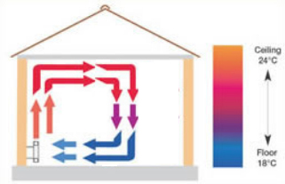

not used, so no idea how well they work, the idea is to put the TRV in the natural flow, circulation3.jpg so mounting upside down may help it sense the return air, or even a simple baffle.

My cheap TRV head, EQ-3 Bluetooth Smart Radiator Thermostat.jpg cost me £15 each in 2019, allows me to turn off rooms when not in use, can set to 10ºC and 30ºC if you want, but it means you can set times, so bedroom not heated during the day, and dinning room not heated during the night.

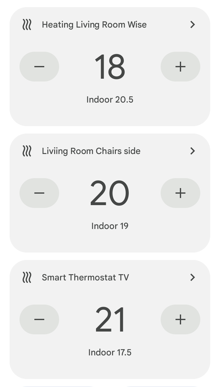

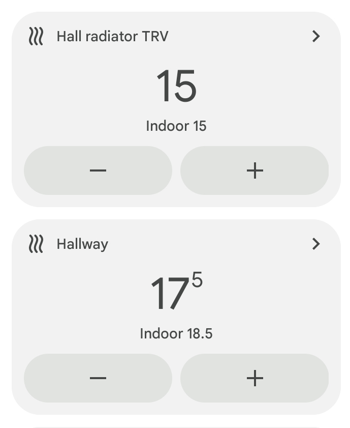

I find the thermostats rarely agree with each other. 1728906867232.png This is from Google Home, showing my hall TRV, and hall wall thermostat, 2.5ºC difference, so I have set them 2ºC apart, living room 1728907153562.png is the same, two TRV's and a free standing thermostat, well it is at the moment, trying different locations, be the TRV in a box, or behind a settee, or under the dinning table, often they are not in the ideal place, so you just set them higher or lower to compensate. 9.2ºC outside now, my central heating is not that good, so have to try making a silk purse out of a sows ear, only had second thermostat for a week, so still experimenting.

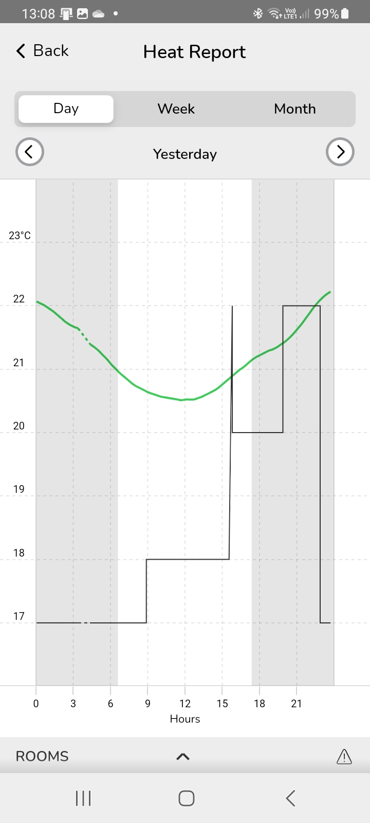

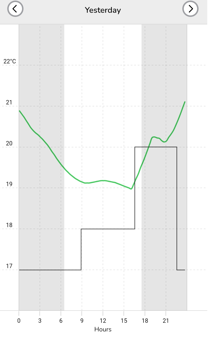

But yesterdays report from my thermostat helps 1728907768894.jpeg unfortunately only the wiser wall thermostat and the Kasa TRV show a graph like this, the Nest Gen 3 is rather useless. Only shows how long it was switched on each day.
