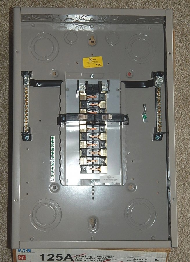

Discovered this the other day:
No reason at all why this Wylex should've been mounted sideways.
It means you have to stop and think, which way is 'up' and which way is 'down'

Joking about which way is "up" and "down" on sideways mounted circuit breakers aside, there is sometimes debate here about which way to mount receptacles, as there's no generally accepted "correct" orientation as with British BS1363 sockets. By far the majority of regular 15A 120V outlets in homes are mounted this way up:
The angled cordsets supplied with appliances such as refrigerators and washing machines are mostly designed so that the cord exits downward when used with such outlets. "Ground up" orientation is less common in homes, although found more often in offices, shops and similar commercial buildings.
Sideways mounting is also common in places where available height is limited, and is the norm for most outlets in a few areas.
