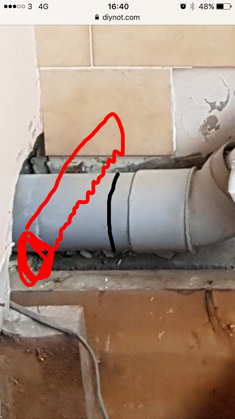

my paint skills aren't great, but hopefully from the pic you get the idea. hows best to actually adjust the soil pipe? should i just cut it before the joint and angled section? or is there a way of breaking/reusing the joint? i think its all solvent welded. or are there any other methods??
the rest of the waste pipes will need to exit through the wall into the next room then run along and back into the soil pipe at this location. as you can see the previous connection has fractured, what is the best way to recover this? can i just clean up the edges then solvent weld a new one on??

You could chop the soil pipe and add in 600mm with a solvent or pushfit socket. My paint skills are excellent so first try and pull the pan connector off, if it's stuck cut it here:

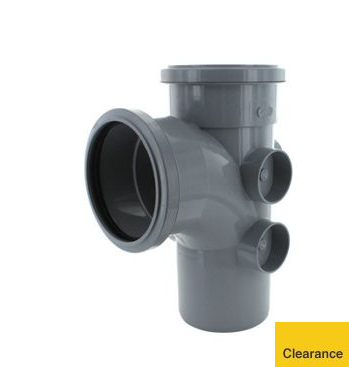

The connection into the side of the T is a bodge. There is a T with an adaptor on the side or you could replace the T and fit a strap on boss above or below it.

Where the waste is (was) connected in to the soil pipe, the fitting on the end of the waste pipe is a boss adaptor which should be glued in to a pre-formed boss on the branch. Yours has been glued in to a hole cut in the side of the branch, no good at all. I would now describe that branch as scrap. If you cut the soil above the branch and pull the branch out you can then fit a new branch with bosses. You could also get the waste pipe lower to suit the shower tray.
