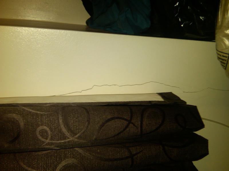

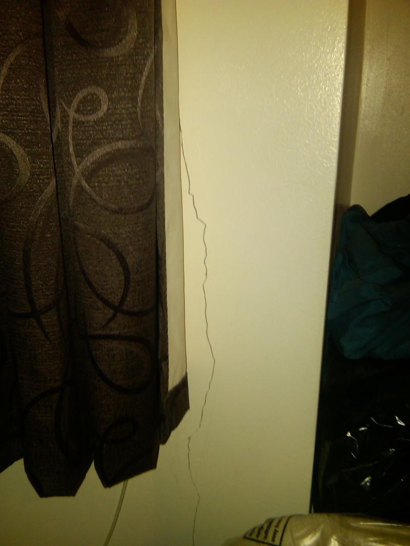

purchased semi in 2007 noticed upstairs bay window outside render cracked on edge, then in 2009 noticed cack was lenth of lower bay area, noticed crack inside of bay area, hair line crack but in last 6 months crack inside looks worse and when i push it it seems loosih, but also looked out window and noticed bay crack was same lenth and directly opposie, no air comming thru, tested that but concerned, live very busy life salvaging from credit crunch

thanks for that, did forget to say was told windows were fitted in 2006 before i brought the house, neighbour seems to think they were banging the frame a lot, but all windows seem level and all open and close k , so may not be frame allignment,
i have attached photo from inside bay
hope this helps house 1930's
many thanks
A photo of the whole of the external window frame and surround would be useful.
From what you say though my bet is poor quality window replacement. Many 1930s windows were load bearing and if they have not been replaced properly you will get problems.
