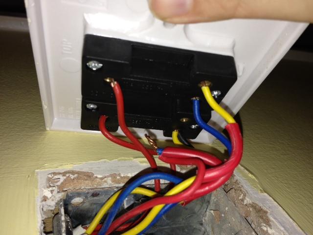

I have a three gang switch down and a two gang up. I've tried to show to the best of my ability what happens, but if there is a better way to represent it please let me know and I will redo it. As far as I can see switch one downstairs has no effect (there are security lights outside the door but it doesn't seem to affect them), and switch one upstairs also does not seem to have any affect.

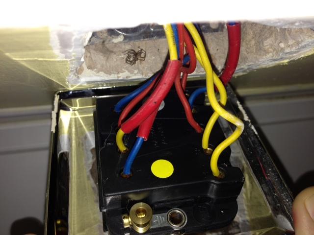

As requested here are two pictures of the wiring currently in the sockets.
The first picture is down - the second (white) is up
It seems the images were rotated when I uploaded them. I don't know how to fix that I'm afraid.
Most important point first:
  1. You do not have an earth connection to that metal switch - nothing else is as important as sorting that out.
  2. At the upstairs switch there are two wires twisted together. They should either be in a piece of choc-block connector or, more likely in one of the switch terminals, which might be why things aren't working.
  3. It's impossible to tell what a wire does just by looking at the colour, and you have multiple reds, blues and yellows at each switch. We need to know which terminal is connected to which, i.e. you need to draw a diagram showing how each switch is wired.

The downstairs switch (that previous owners installed - not me!) has an earth connection in the housing in the recess - is this insufficient? And if so - can I at least fix this problem?
You can move it to be connected to the switchplate.
But is it connected to anything at the other end?
There are three earth cores which originate from three, three core flexes which feed the switch.
I presume I can connect this to the switch plate.
Honestly I have no idea as I can't see - they go vertical upwards in the wall. But it's next to the front door so I presume it's first in the circuit so the main box?
The blue and red twisted together in the second picture.
Try putting them in the (only) spare terminal in the back of that switch.
It may fix your problem.
But first, sort out the earthing....
