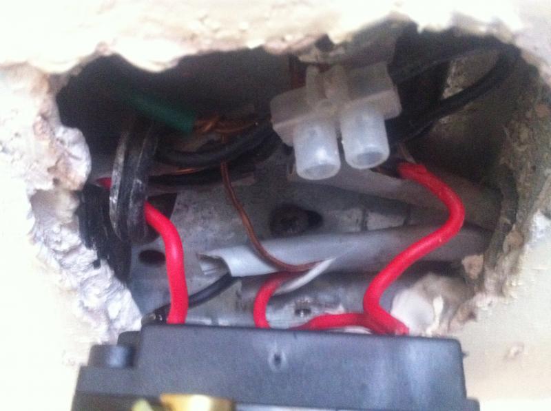

. I have uploaded some photos of the hallway and landing.
here are 2 picures i have managed to get up of the downstairs and upstairs switches for the hallway and landing.
LANDING LIGHT SWITCH
HALLWAY LIGHT SWITCH.
That all looks very amateurish and shoddy.
You ought to get a reputable electrician to check the whole installation, before you start decorating, fitting carpets, buying furniture.
Are my eyes deceiving me or is that an earth lead being used as a feed in the second picture???
And un-sleeved earths in the first picture!!
Don't delay. Get a professional in now.
Metal front plates and they are not earthed. The earth terminal is just visible in the photos but not used. Potential dangerous.
You do need to get the installation inspected and the errors, like the wiring of those switches, corrected.
