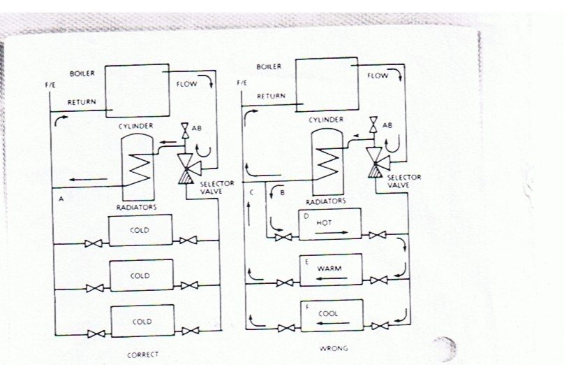

Often reverse circulation because the heating returns are not commoned let BG sort it out.
To try and explain this is a factsheet for a manual valve but the same applies to motorised valves.

Hope that helps

The only thing is, did the system do this before BG came in (I'd guess not) to fit the boiler & was it just a simple boiler swap?
You shouldn't all of a sudden have reverse circulation, if all they did was change the boiler, unless they were in at the location of the pipework and 3 port valve. If they've changed pipework in there then they may have altered the return, causing the issue.
