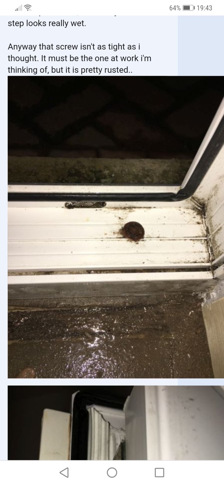

Hello I've been trying to weather proof my front door and have had advice to fit a threshold kit. I have now purchased it but I'm not sure it should go in to a upvc door frame? Does anyone know if anything should sit in the bottom of the door frame? Picture for info but not mine.
I was actually looking for a L shaped cill / sill cover for the concrete threshold under the upvc door and ended up with this issue and still havent got the cill cover!

I doubt if a threshold will work
does the door frame have no external cill -that projects over the brickwork?
have you checked if the drainage holes are blocked
is the water getting underneath the door frame
if the door was fitted without a cill, one cant be added now because it would add 30mm to the door frame height
a pic from outside would be helpful -one showing the bottom half of the door and below it
