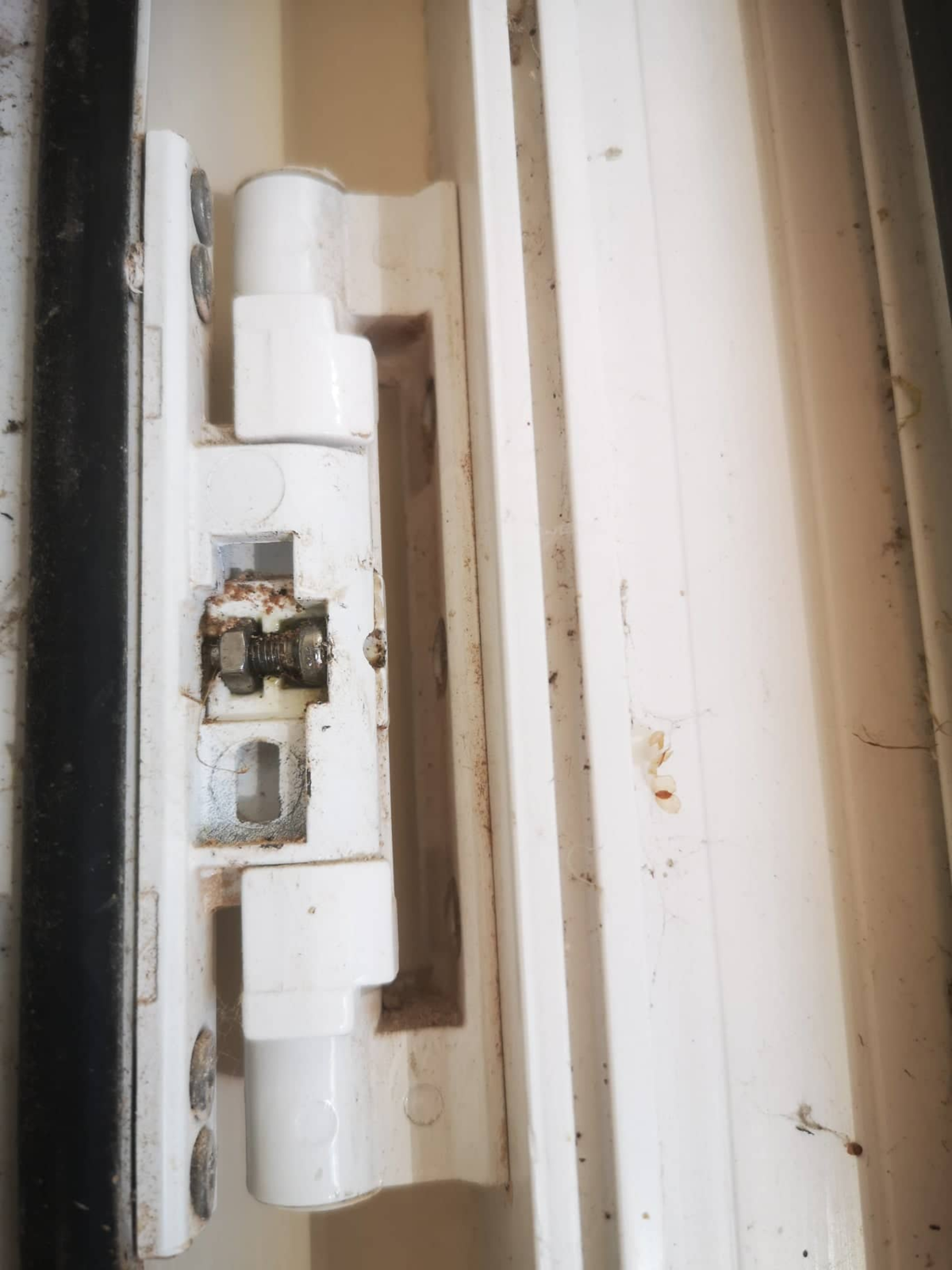

UPVC door hinge adjustment
21 Jul 2021

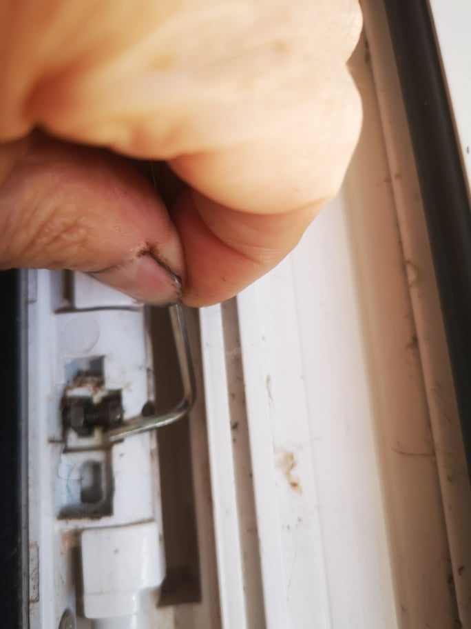

After many years, my door has started to rub at the bottom corner (far side from hinge). I seem unable to adjust anything and I can't find any image of the hinge. At the top and bottom of the hinge, there is nothing to adjust - when the plastic caps are removed there is only a smooth round pin. There is a small plate which can be removed from the hinge when the door is open, and this covers a small "captive bolt and nut" - but I cannot access this bolt make any adjustment - see photos
HINGE WITH FLAP REMOVED SHOWING "CAPTIVE" NUT/BOLT
PHOTO SHOWS INABILITY TO INSERT ALLAN KEY BECAUSE OF LACK OF ROOM BETWEEN DOOR AND FRAME.
Can you access the hinge mounting screws, on left of pic. Take door off and adjust, refit and check. Might be only way if door won't open further
