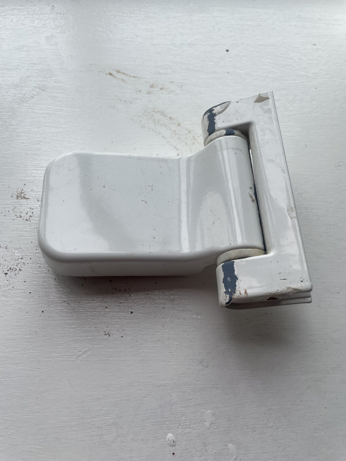

I have lost one of the Allen screws from this upvc door hinge causing it to drop. Can I get a replacement or do I need to get the whole hinge ?
Can you recognise that from the photo ? Are they easy enough to fit ?
Im a service engineer, I recognise everything :giggle:, new hinge is an easy swap but just the offset from the door frame surface to the door leaf surface, from memory they come 16mm to 24mm I think

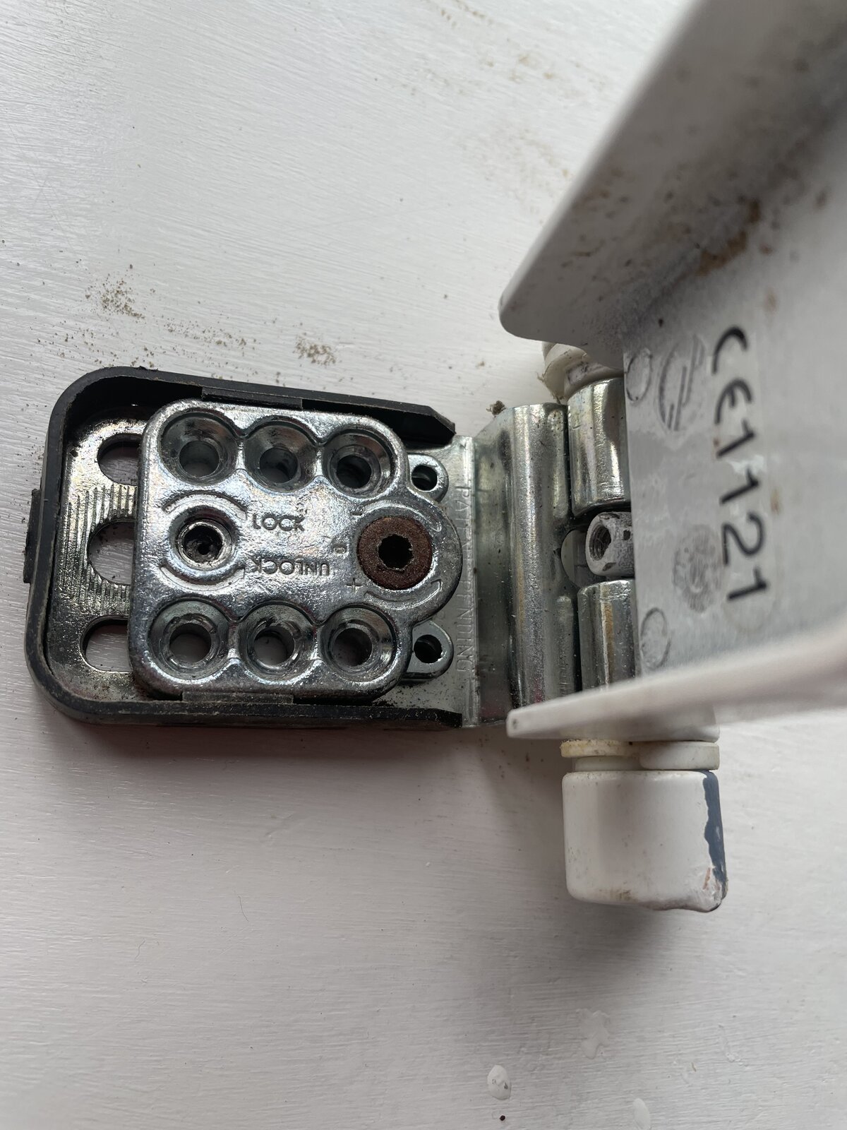

Is there anyone who can identify the make and model of this upvc door hinge the locking screw is missing on two of them.

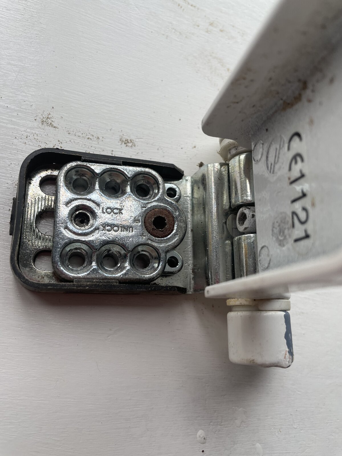

It's ok, the hinges are the same range, but slightly different. This hinge is the flush fitting variant! :)
Does flush fitting mean there is no upstand? I am struggling to workout the upstand distance

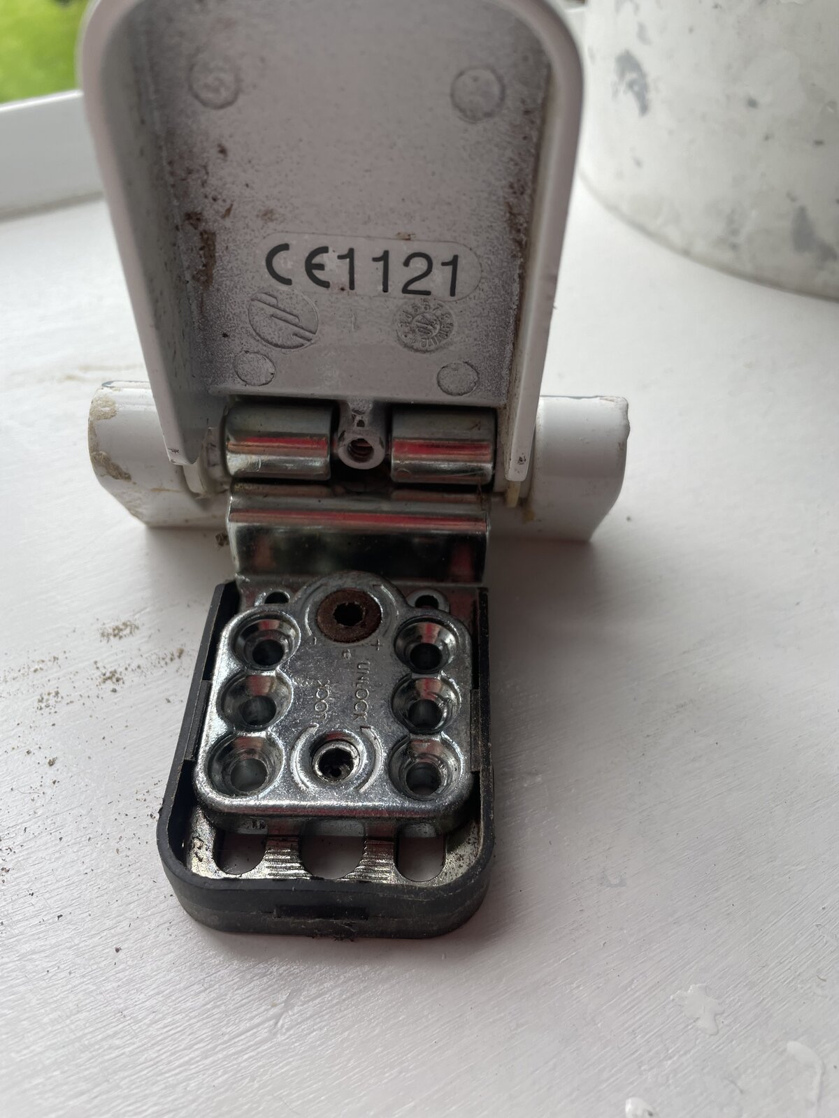

This appears to be the hinge from the first post...
Measurements are in the diagram.
It has a 23mm rebate

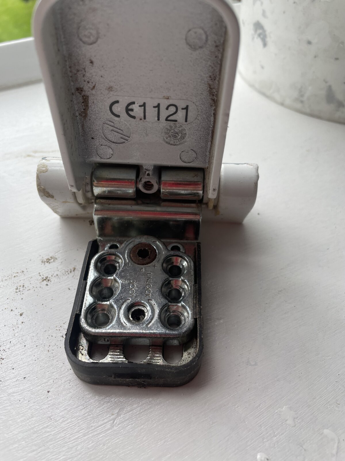

This is the hinge from your last post...
Again, measurements are in the diagram.
It is flush fitting with zero rebate.
Flush ones are found on composite doors, rebated offset ones found on upvc doors
