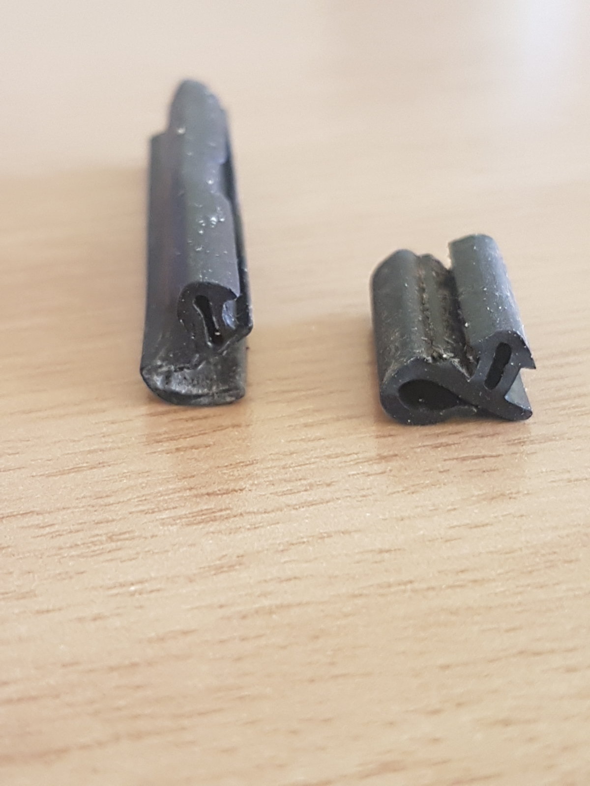

Hi
can anyone recommend somewhere to buy new Upvc Door/window rubbers?
or recommend what are best ones?

you need to lift up the end of a rubber and match the profile from an internet search, something like here.

Could you possibly help me out with what type rubber it will be in the 2nd link that you posted.
I'm not sure if the are both the same but it looks it to me.
20170804_065418.jpg My Rubbers
dsfds.JPG What I think it is.
Unfortunately I cant see the physical size of your gasket so why not get them to send a buble gasket sample set which I think should have a B047 gasket in it, then you will be sure to get the right one.

The dimensions are excatly the same in the picture above. 5mm x 5.5mm
Ebay you can buy by the meter.
Get a sample pack first 99p for the ones that look the closest match to yours

Check for the gasket, if it has shrunk on the inside , pull it out and check online for replacement. Buy a few meters, wedge them the same you pulled the old one out and a bit of washing up might make it more flexible.
I guess you can DIY it. In normal cases, a seal pushes into a groove in the plastic frame, so you may just have to pull it out. Remove and replace seal with squashed bit in a new position, which could simply cure your problem. Else try for a replacement length of seal. Hope you might have tried with ebay.
