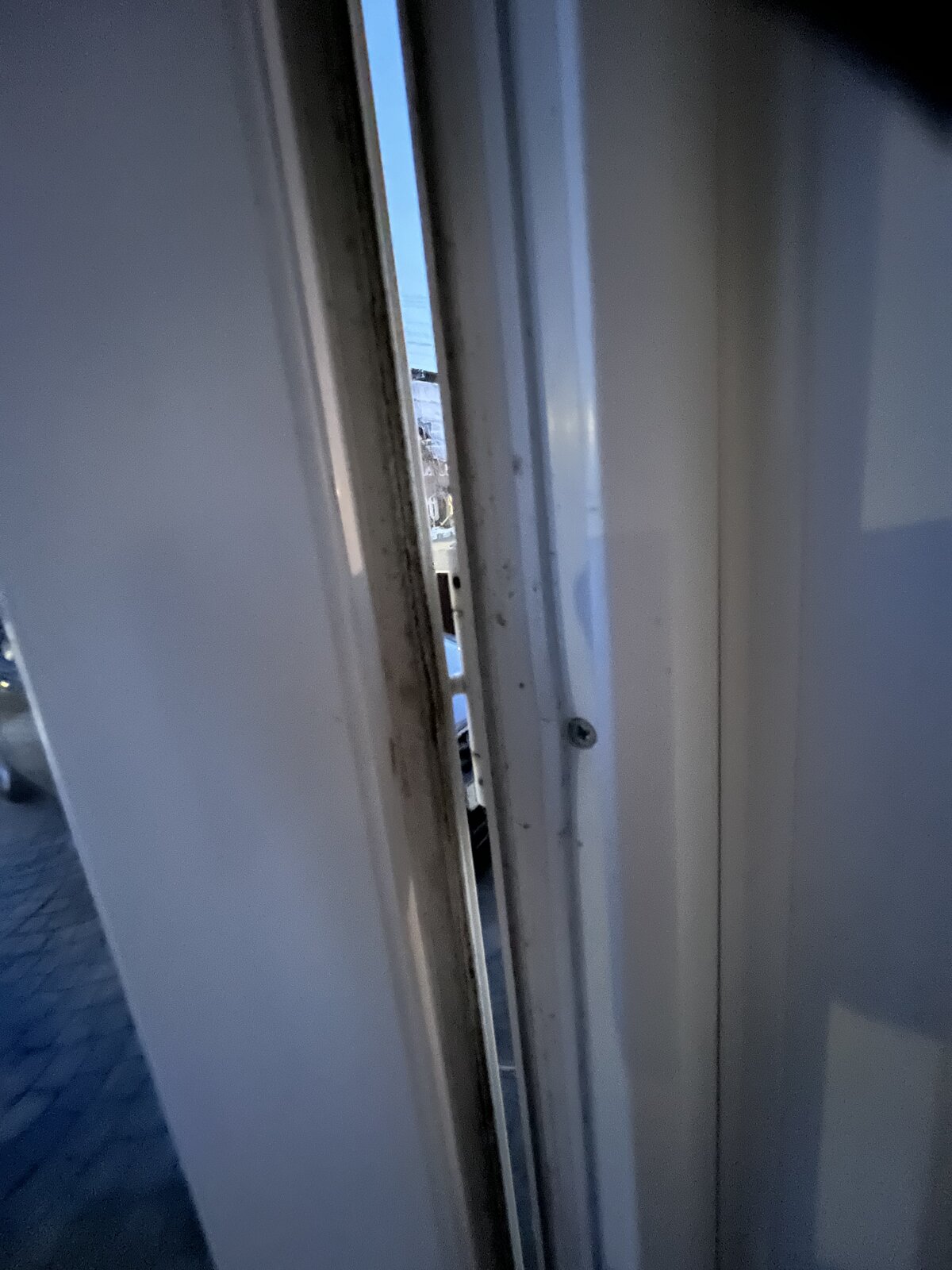

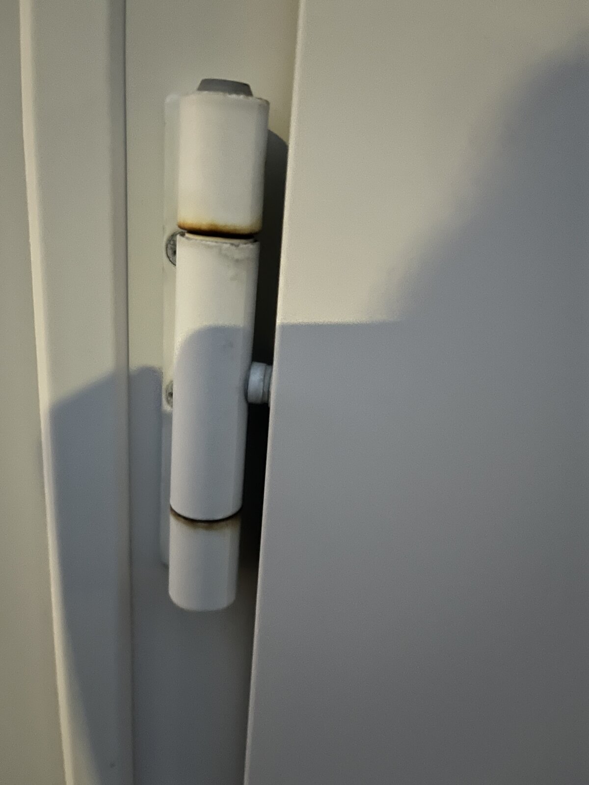

My main door UPVC door butt hinge has single screw that is connected to the main door panel. Due to the strong wind, the door slightly tilted from the top. I want to align it by tightening the screw at the top but cannot find anywhere how the screw is connected to the main door.
Appreciate your advise on how this door can be aligned.
Some pictures as attached

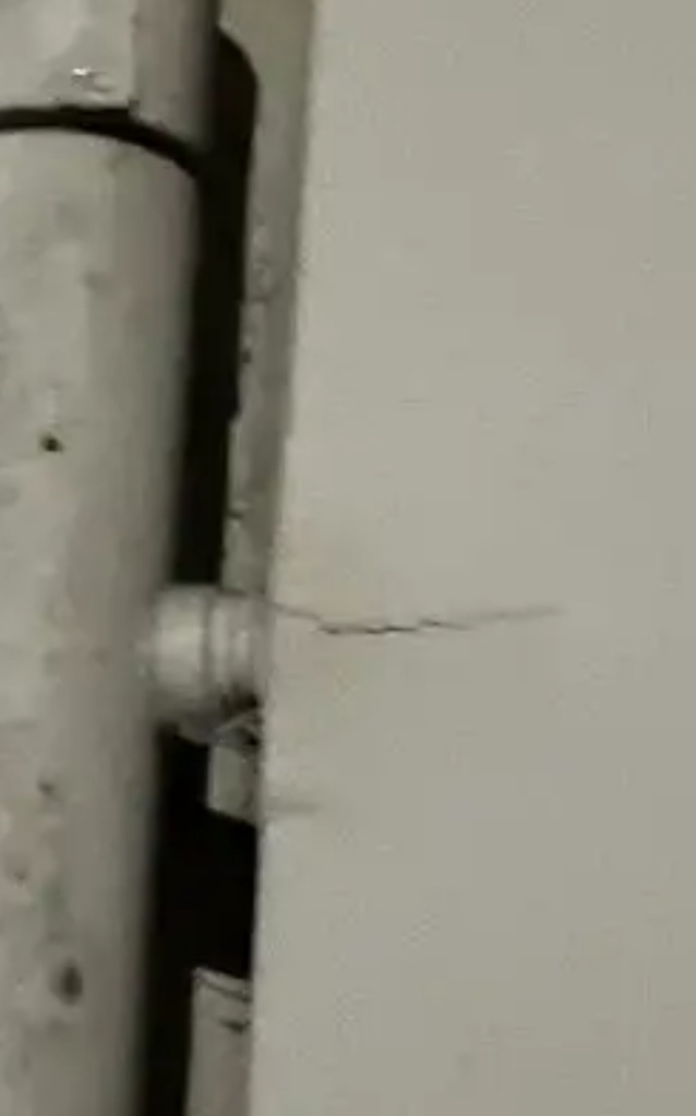

You knock the main hinge pin up to split the 2 halves and then pull the door separating the halves and turn the centre part in or out depending which way you want to force the door to go, then rebuild
Well spotted RG, I was replying from my phone while up some scaffolding so didn't see it, ideally it shouldn't be there but the pvc is double skinned so hopefully just the outer skin and as said 4 hinges so it'll be ok, its an old door anyway with that type of hinge bordering prehistoric
