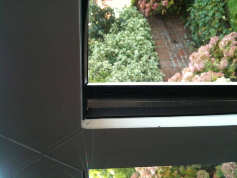

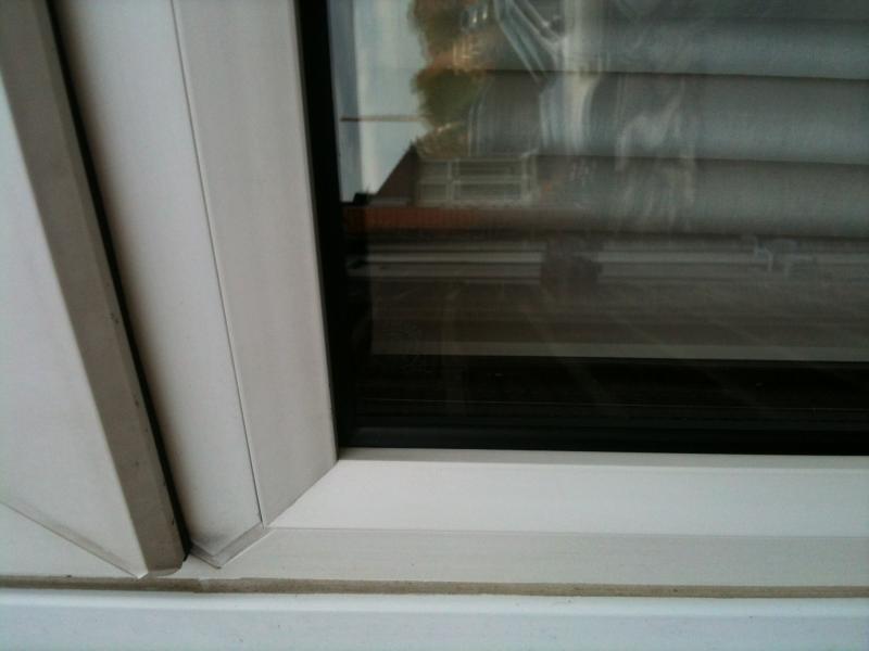

How the hell do i remove this window ! need to measure it and take it to the window manufacturers.
Any help would be great
looks like wedge gaskets on the inside , try and prise out the rubber bits on the inside then go round the front of the window and you should now be able to prise out the beadings on the outside with a paint scraper the wedge gaskets keep the glass tight against the beads good luck
