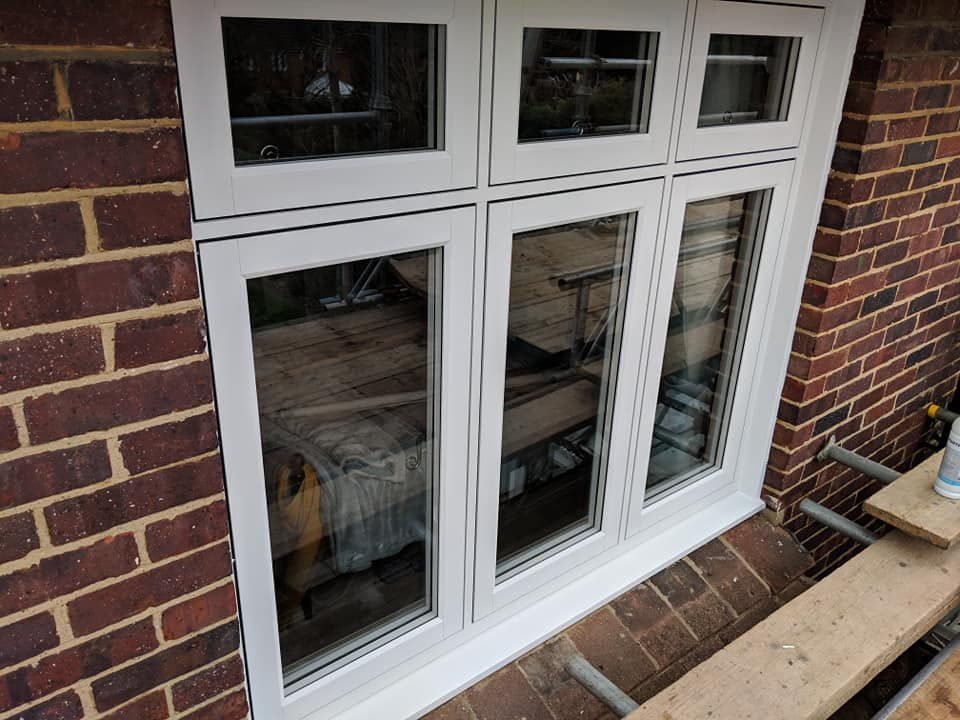

I've got Deceurnick and they seem a very well made window, you can have mitred finish as Gods white frame photo, or graff (spelling?) welded which look like the joints are butted-up close, instead of those big nasty 45° welds at the window corners
I had graff welded, from memory they were around £350 per window. 1m square.
Fitted both R9 and Deceuninck, Gazman has hit the pricing pretty much right, R9 are the top end of the market but the Deceuninck are also a good window with a great choice of colours. @Mr Chibs are you sure that the ' graff welded ' are actually welded ?, as our suppliers version of a Deceuninck flush sash ' butt ' joint are mechanically jointed, don't get me wrong looks much more like authentic wood windows but does add to the cost yet again
I'll post a pic later, you can tell me.(y) I hear a little bit of knowledge is dangerous! hahaha
If it is welded i'll be quite interested as i do think the ' butt ' joint looks better, cheers for getting the picture
Some factory's do mechanical join some do "Timber Weld"
For Decerninck if you have mechanical join then its only the external done that way, Internal is the standard 45 degree weld for strength (otherwise you have to bond the glass like R9 do).
Timberweld is the newish system that give mechanical joins with all the strength of a traditional weld, Can be used on most makes of flush sash windows I believe:
