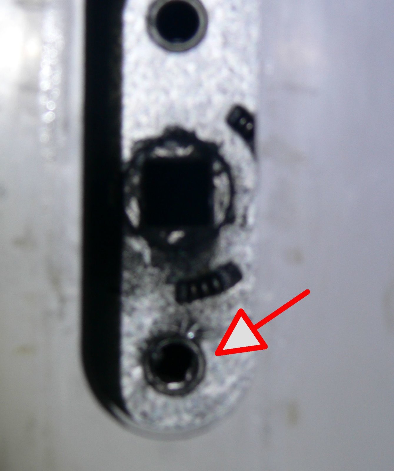

Hi,
I m trying to replace old (worn) pvc handles, current handles connected via 4.80mm (approximately diameter , vernier caliper shows around 4.77 so I assume is 4.80)
new one's comes with 5.80mm , I assumed were "standard" so I did not check the specs (were no specs at all about the screw sizes for the new handles anyway).
Issue is that the bottom screw fits, but the top not! As the UPVC mechanism allows only the old size to be fit there (arrow shows the TOP screw)
Do I need now as well a new lock mechanism now? Or is it possible to wide a bit the current pass-through hole (unless is a critical point for the lock mechanism).
screw to screw distance on handle is 122mm (bottom screw is under the cylinder lock -not pictured)
thanks for any help!
chris

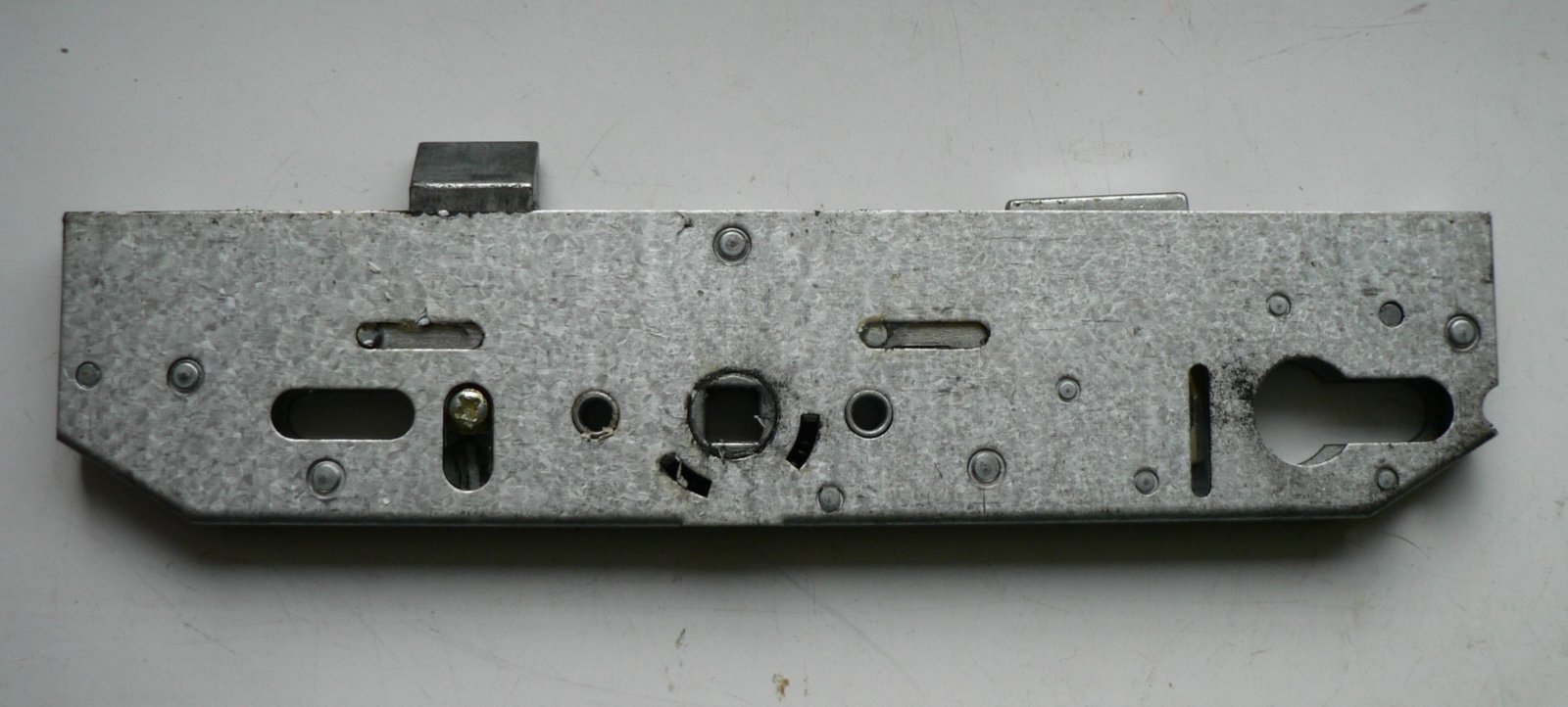

"New" screws (are M6 as I googling now - please correct me if I am wrong) can't passthrought via the locking mechanism (designed for M5 screws), old screws does not thread, as they have smaller diametrer.
Anyway, as I see now the handles have screw-on thread (replaceable?)
I am going to contact Mila in the case they offer too an M5 thread adapter or replacement for them
Do you think guys, that is possible to crack open the locking mechanism?

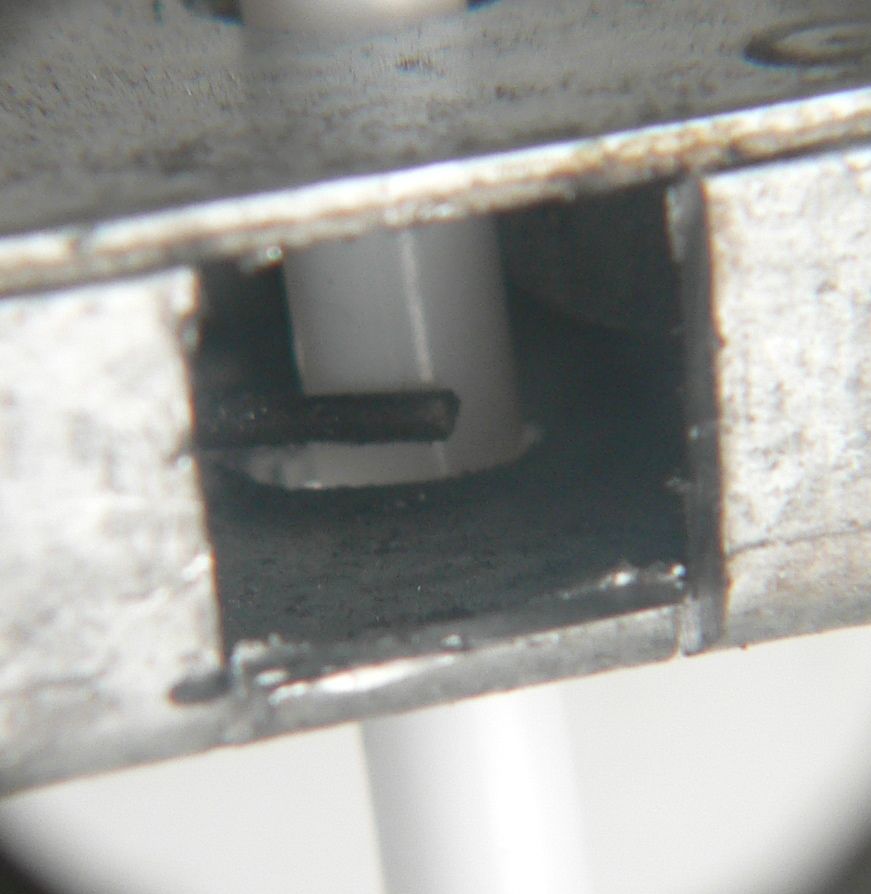

SUCCESS!!!

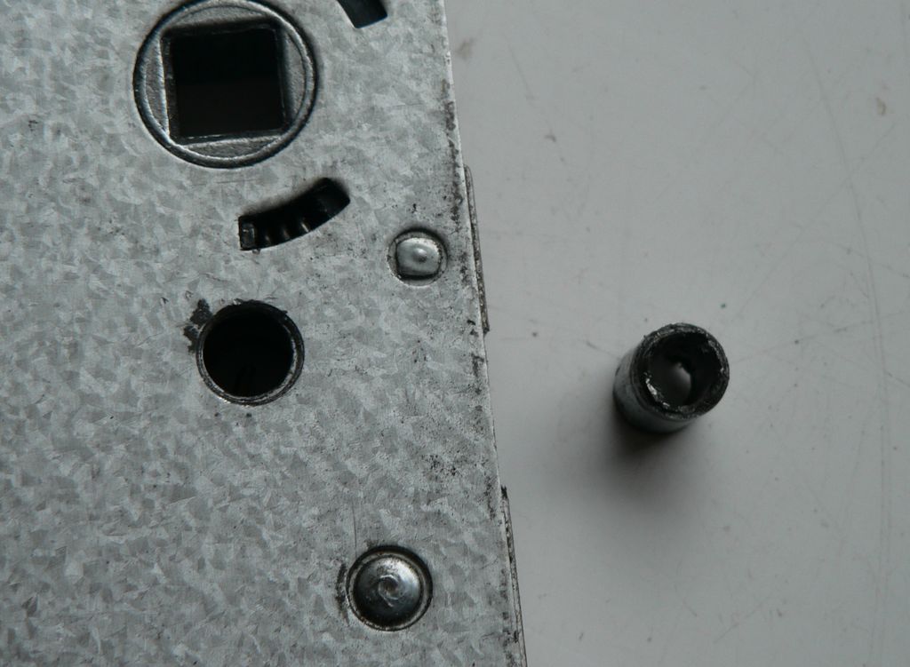

I managed to hack the gearbox :)

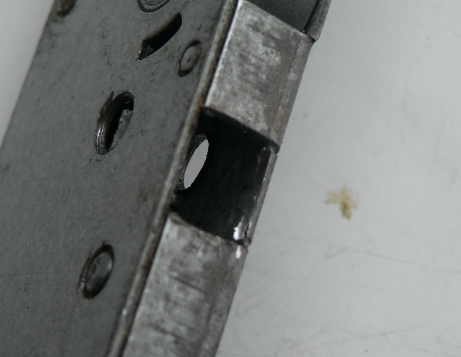

Using 6mm drill, I drilled both sides of that hole and hacked the supporting spacer.
I also, had to make a hole on the side,as its not good idea to have a roaming part into the locking mechanism :) , dremel cut the metal like butter :)
As I can see, the spacer supported a spring, but not a major issue as it will be supported
by the M6 screw.
