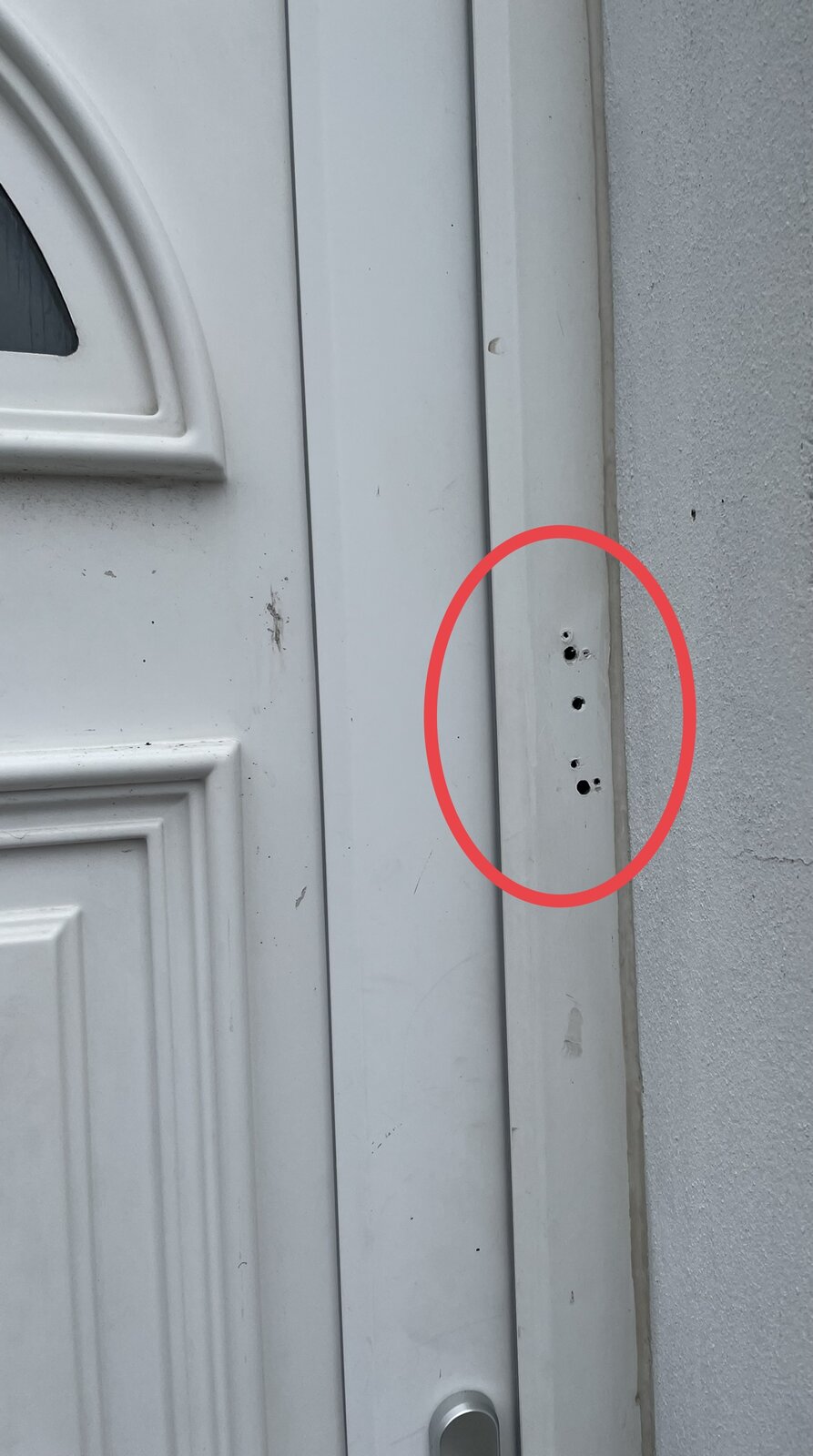

I am getting my uPVC doors sprayed however there are a number of holes on the frame (see image). I need to make good before spraying. Any advice on how to go about this? Some of the plastic is sticking out and needs to be flush (I assume) before filling I tried a stanley knife but that didn’t cut it (literally). Thanks in advance.

Sand it back to flush with an abrasive paper, on a backing block, before filling - pushing the filler well into those holes, then sand again with some finer abrasive. The guy doing the spraying, if a specialist, might do this for you as part of the job.
