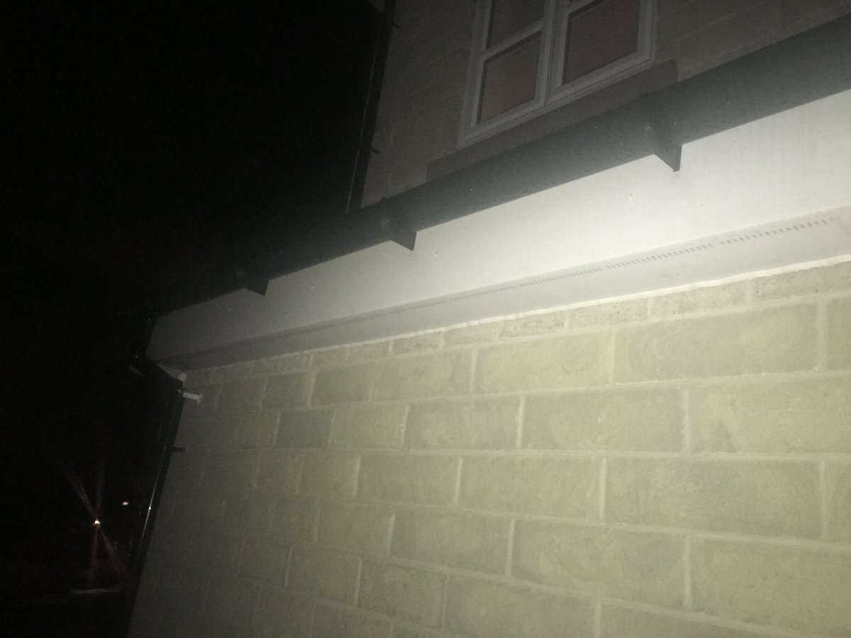

Im thinking of putting the lights above the garage soffets more than top roof line. But that has no loft space. I will just have to drill though the brick in the garage and into the space behind the Soffit. Does that sounds reasonable?
Yes, but I'd be amazed if the top of the inner leaf brickwork was positioned such that the wall plate was tight up against the bottom of the roof sarking - i.e. you should be able to push a cable down between the rafters in to the soffit space. Is your garage roof/ceiling clad on the inside in some way?
Y

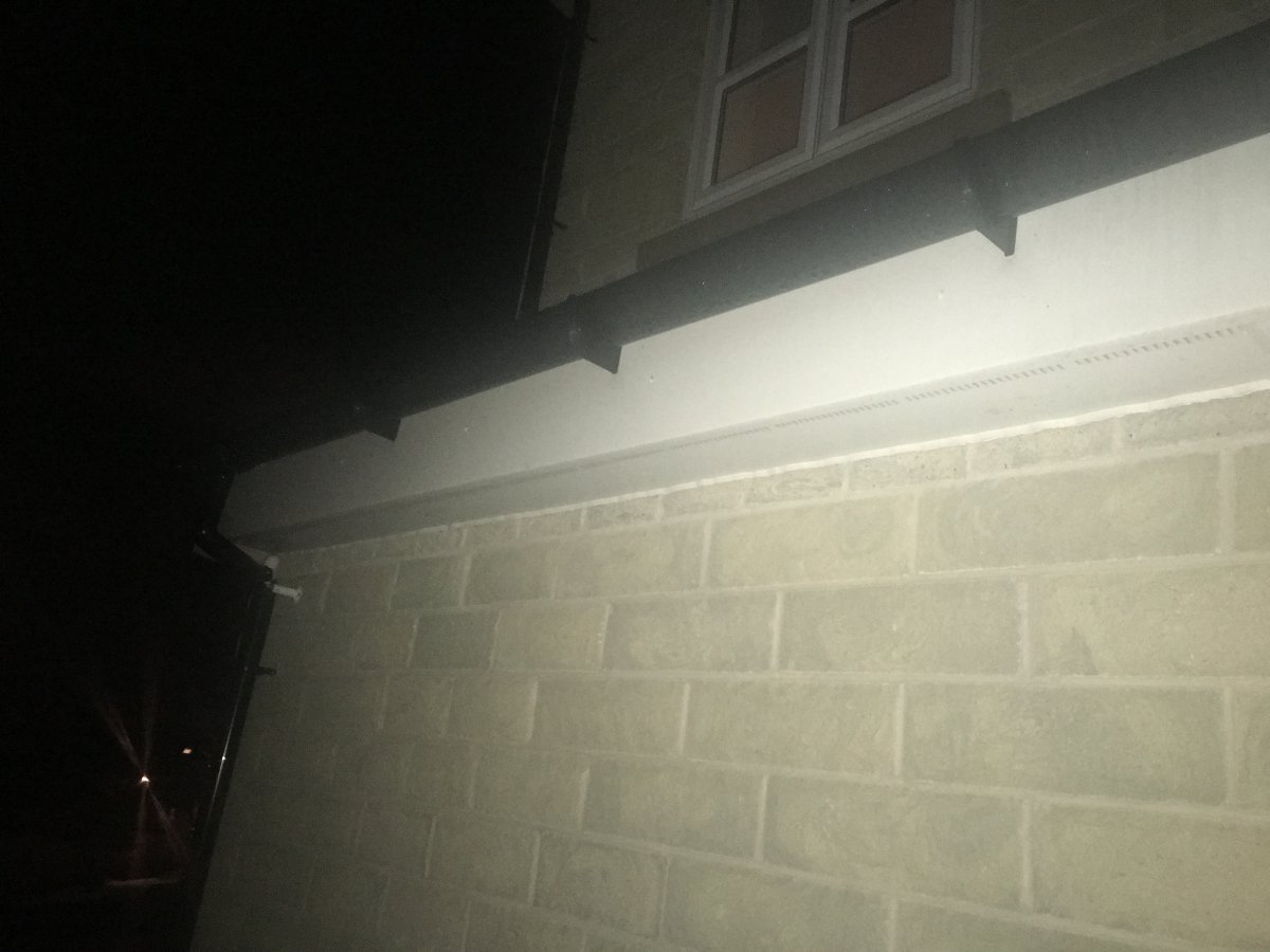

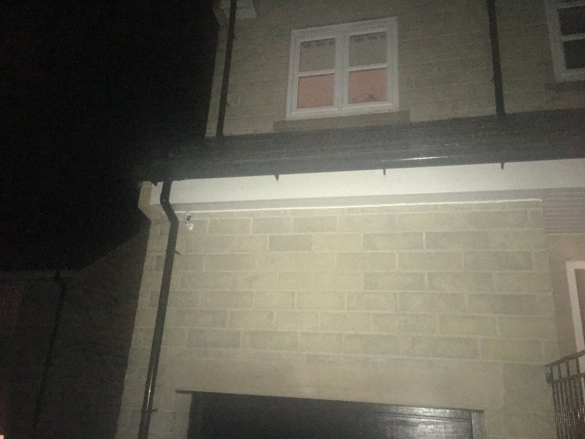

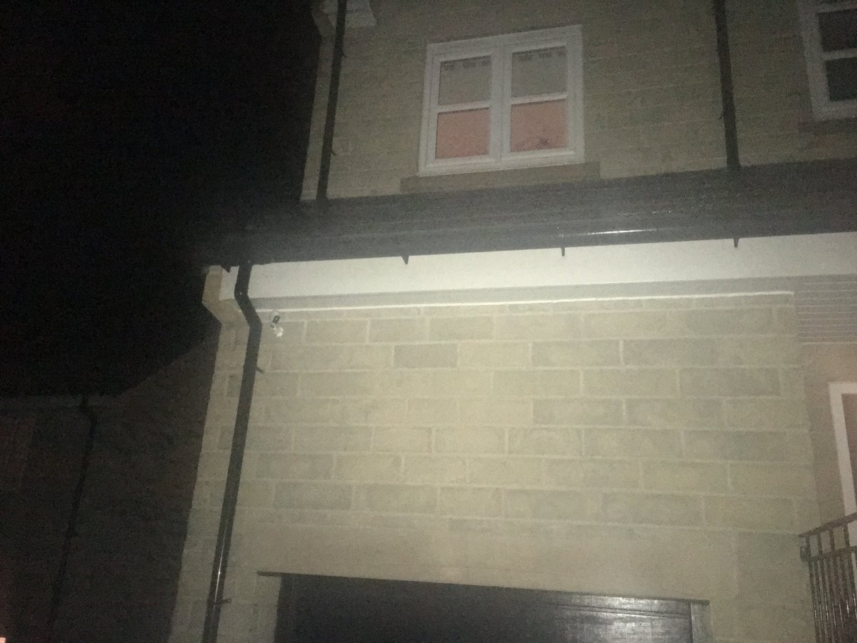

The inside of the garage where the soffits are on the outside is just a breeze block wall. I'll try to get some pics to help explain what I'm trying to do.
This is the outside where I want to put the downlights in. Thinking about it I don't think I can get behind here in the garage as it's too high!
How do how get behind this to run cables etc?

Hard to see but looks like pan tiles ( Marley moderns?). Push back the second row, remove the first row, fold the felt back/eaves trays and you've got all the room you need to work from above.
Provided its an Interlocking tile roof MW is on it with access from above..Easy.. Slate roof or similar then its fishing for cables

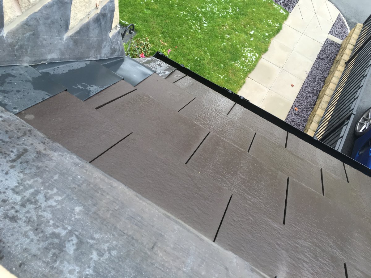

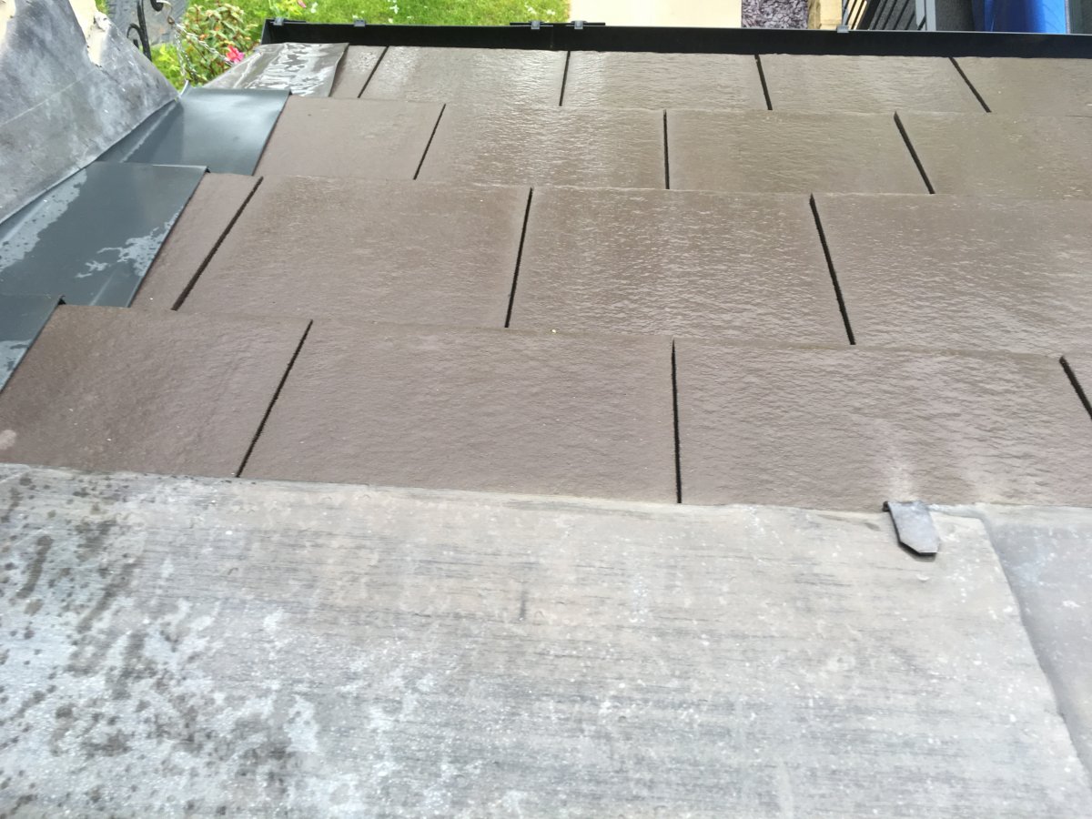

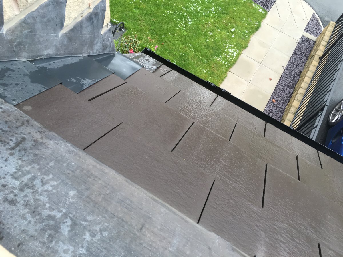

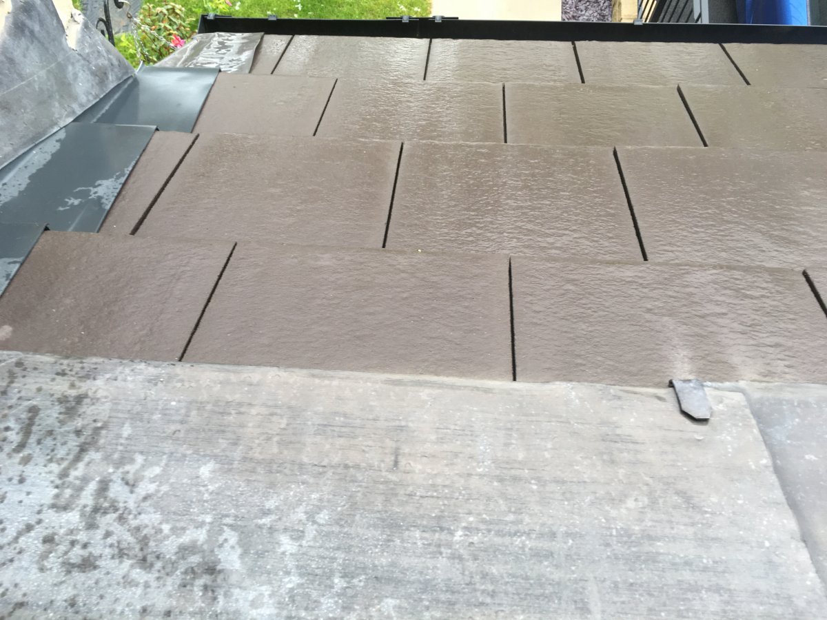

Thanks guys. This is the roof (looking down from the bathroom window). Should I should be able to just push the title out of the way?

Yes. Leave the end ones in place so you don't disturb the lead. When you push the tiles back keep them flat. If you lift them too much the backs of the tile could drag into the felt and rip it.
Great thanks. What should I expect to see under the titles? The underside of the plaster board used on the garage inside celling?
No mate you'll just see the inside of that white soffit board which is all you need to access to do your downlighters.
