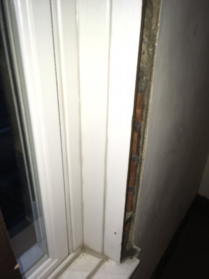

Afternoon,
I want to replace the current White upvc woodgrain arch used on my windows to make good with something that will cover the full window recess and meet the wall arch yet to be installed. While I'm at it I want to also replace the arch used on the sill and replace that with a woodgrain capping board / sill cover.

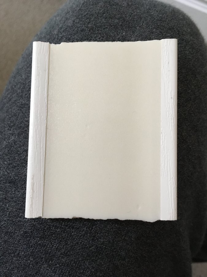

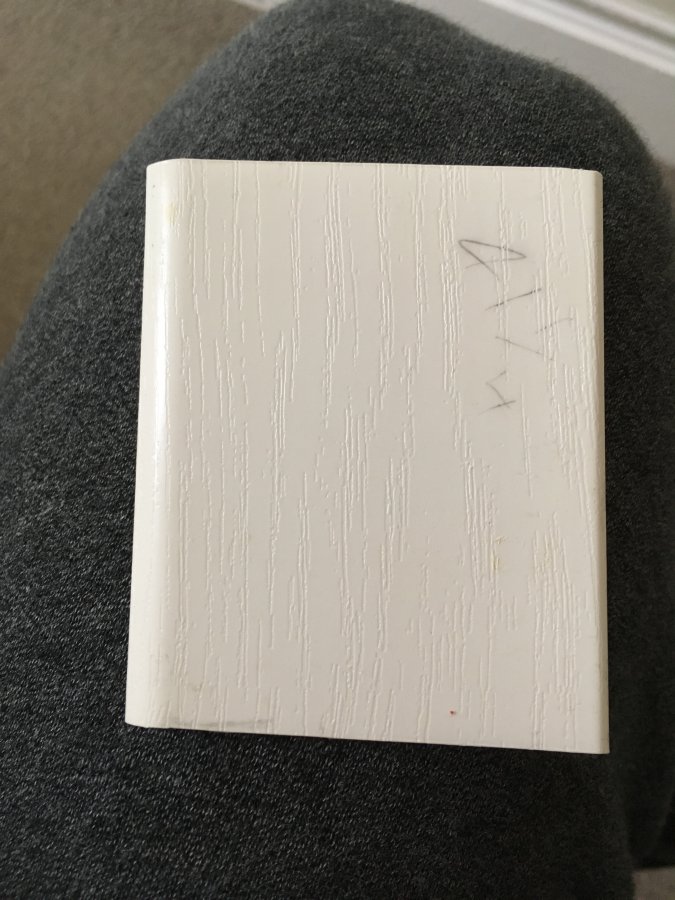

This is an off cut of what is on now.
Underside

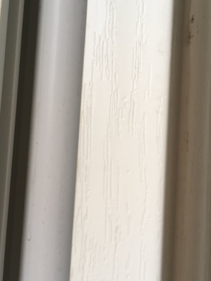

This is the window finish (internal and external)
Yep that's ash white, in the 150mm size you quoted it's probably listed as utility board or flat board, pop into eurocell and they'll order it for next day, they keep a good stock usually but ash white is quite rare I've found
