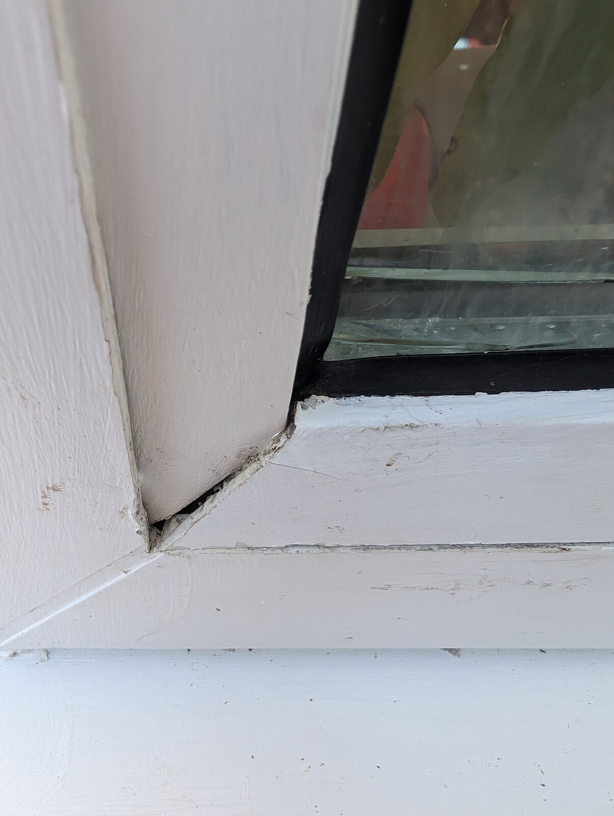

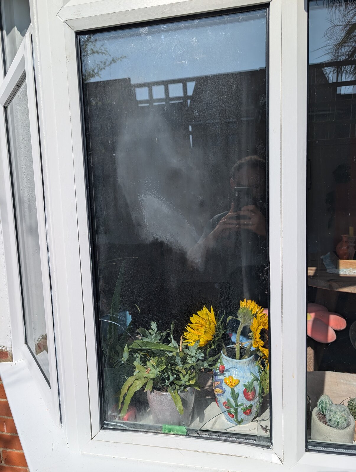

I have a 1930s bungalow with some old upvc windows, quite a few of which have blown and have condensation within the double glazing units. I have a friend at a glazing company who can sort the glass so I thought I'd take one out and measure up!
They are externally beaded and it took me some trial and error getting the beads off, damaged the first one a bit but once I figured it out it was fine, also did cracj the window in the process but we live and learn! It needed replacing any way.

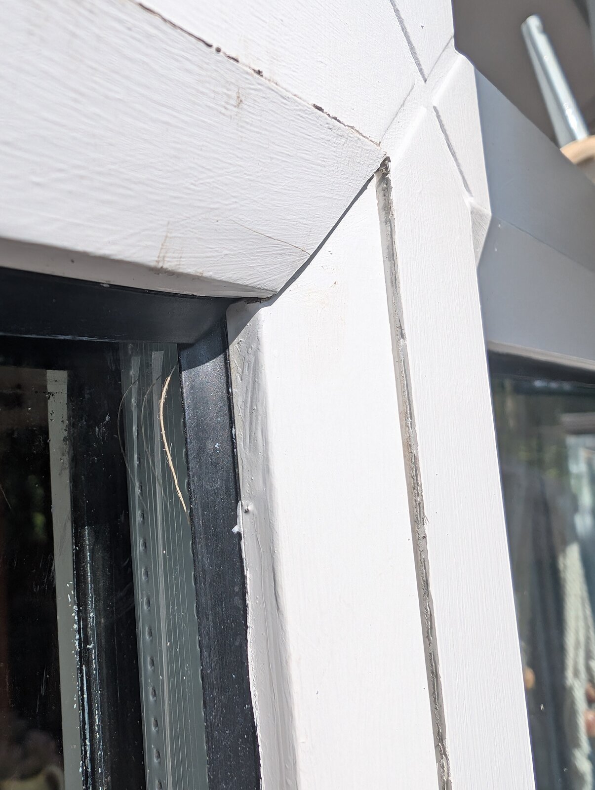

So I got the window out, measured it up and when putting it back in, whilst I wait for the new glass, I noticed that the beading is now not tight at all. It simply clicked into place with no tapping from a rubber mallet and the glass feels a bit of a loose fit. I can't figure out why this is? All rubber seals etc are in place. Also, the corners of the beading now don't seem to align with one another, they are cut at 45 degrees and are a very tight fit, I had to bend the strip in the middle then tap the corners in but they are a bit gappy.

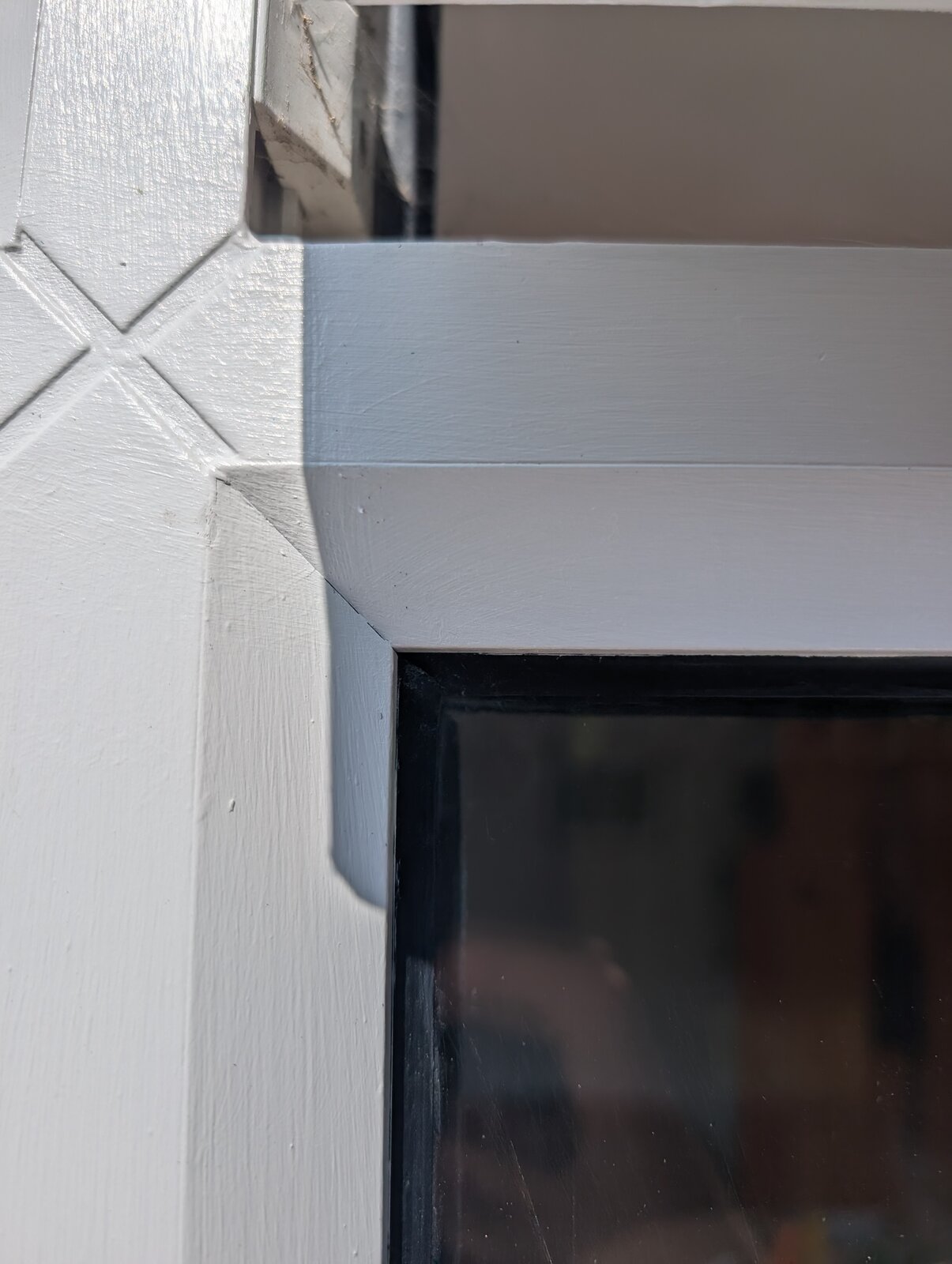

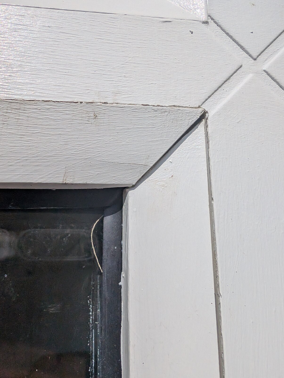

Anyway, enough writing here are some pictures. I have included pictures of a window that hasn't been taken out yet to show how tightly the corners fit.
Hoping someone can advise on the loose fit of the beading upon putting the window back in and on getting the corners of the beading right!
Thanks in advance.
Will

I don't think you have them in correctly. I struggle a bit to get mine in as they don't sit as you think they would before knocking in. Maybe try find YouTube video
Thanks both for your replies. Will see if I can find a video showing some similar ones.
I don't think the coat of paint helped with the removal, or re-seating either.
Did you try cutting the paint along the joints first and cleaning it off the mating surfaces before reinstalling?
It may also have helped glue the beading to the frame, if there were any pre-existing looseness?
They sit oddly but when you knock in they click in and line up. I use soap and a rubber mallet to get them in. Only 2 out of the 4 strips have a mite cut. Those 2 go on last on either side..
Yeah the paint definitely didn't help. I did have to cut along the gap first. Will clean up the mating surfaces and see if it helps.
Thanks for the tip on the soap! Will give it another go tomorrow. I also don't think it helps that the window has cracked. As the glass now has some flex in it.
Just want to make sure I can get this one back in before I attempt it with new glazing units on about 6 of the windows in total.
Also does anyone have a good source for replacement beading? I have a feeling these are so old I may be stuck with what I have!
Any manufacturers markings on the window edging. Open window and look.
I can't get any for mine unfortunately
