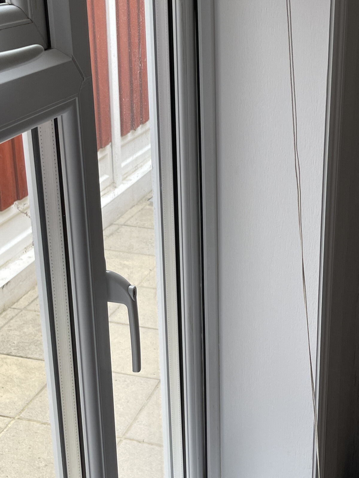

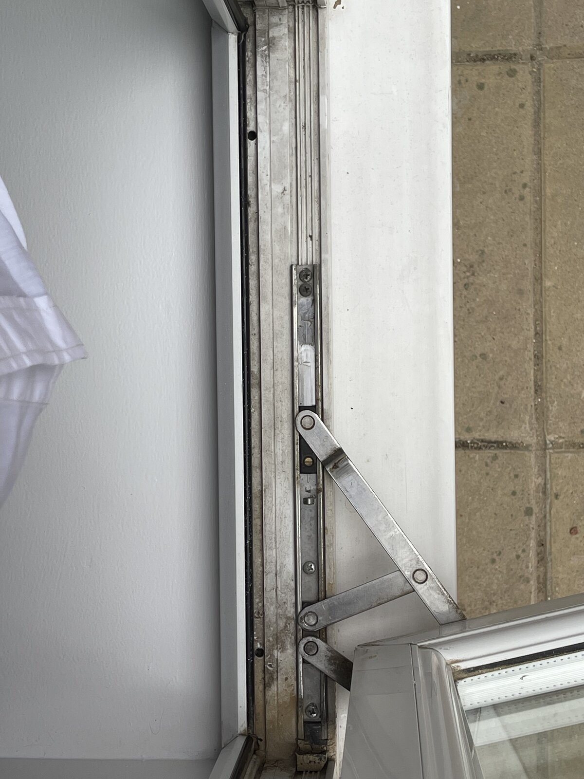

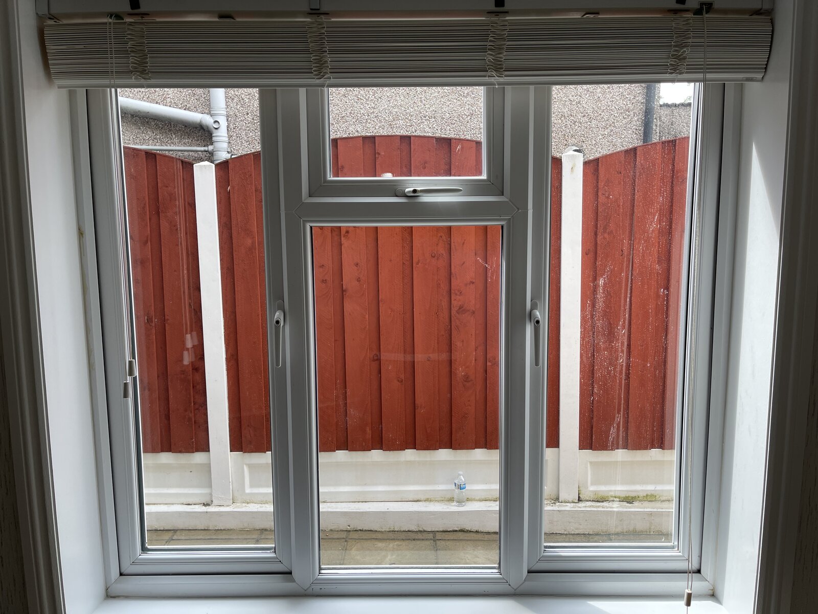

I have a uPVC window that is letting draft air in through the sides and at the bottom of the two large openings. The top and the top side of the two openings appear to be nice and close to the frame giving it a good seal. Pictures attached so you can see what the window looks like and a picture of a side showing the gap between the frame and the window with the window shut. I am advised I need to replace the hinges. I cannot physically see any issues with the hinges but I am no expert. Will changing the hinges fix this? I am quoted £190 for the job which seems excessive to replace hinges.
Secondly, and more importantly, the bottom of the window frame has two holes on each side of the large openings. I am guessing these are drainage holes. The holes are clean and clear but when I pour some water into these holes I am not seeing the water escape out of the frame. I cannot see or find any holes on the outside of the frame to allow water to escape. I have also checked on the underside of the frame using a metal coat hanger to see if there are any concealed holes but I was unable to locate any.

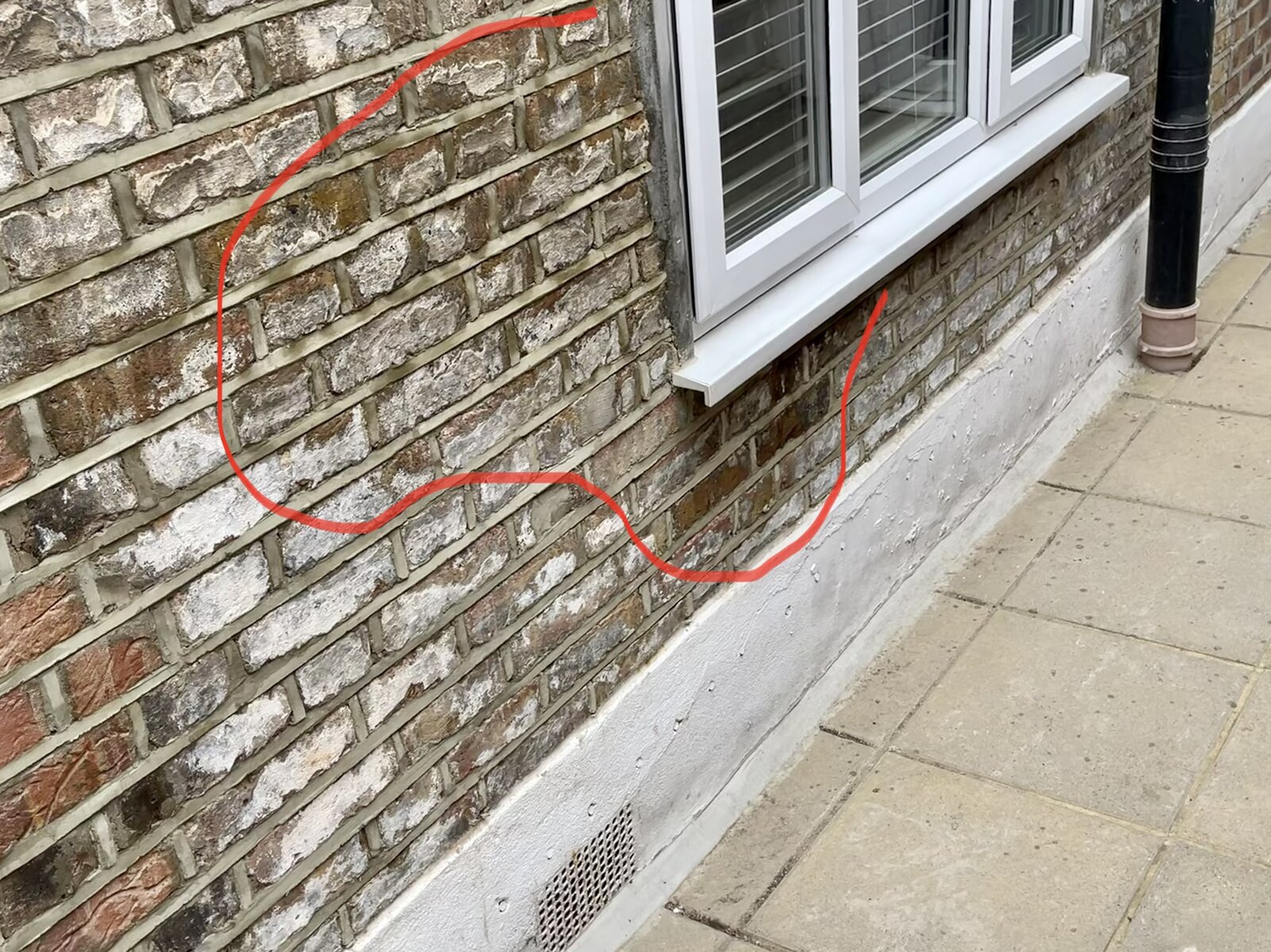

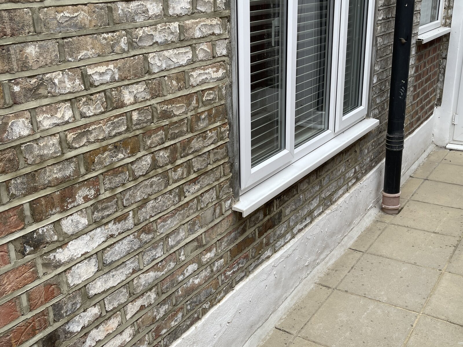

I have had the window for 16 years and have never had any issues with the frame filling up with water. I do have a small wet patch on the wall just underneath the side of the window (picture attached).

Changing the sealing gaskets is a cheap and simple DIY job that may solve the draft issue without any hinge adjustment.

To cause that pattern of water on the wall, the frame would have to be full of water, and you would notice it coming out of the internal drains!

Gasket alone will not sort that gap out! We do this type of repair regularly, that is a new set of hinges every time, probably 310's ( 12 inch ) by the look of that . Quoted £ 190 ...does seem a little high to me , £100-£120 would be closer to the mark for one set , two would be about £150 , depending on how far the fitter is travelling ( if the guy tou are using is 200 miles away it isn't to bad lol! ).
As goes the drainage , I'm very concerned about the two holes that are set within the frame , house side of those hinges. That is not the usual place to see drain holes , they should be within the very outer ' cell ' of the upvc frame, not set right back there. I can't see any drain holes on the outside of the frame either, normally face drain would be about half way across the sash, on the face.. base drain would indeed be under the frame between the cill and frame, inside the ' ribbing ' of the frame , so that it is invisible. I have a very horrible feeling that the water you have tipped done those two holes at the back , has gone straight into your wall.....
I'm with Ronnie, I think it's been drilled(drained) at the back of the frame not the front hence no water is visible bon exit, think it's draining along the back edge I'd the cill between the cill and frame and running along the end, this could be the reason the wall damp....I say COULD be
As for the gaps, I think a combination of new hinges as well as closing wedges will help pull that gap together, I've noticed the openers are very tall, a gap in the middle down the hinge sides of tall openers is a common fault

Why even £150 for a set? They are only around £10ner for a set from Screwfix so material is cheap. In my case the repairer is 2 miles away and I am hoping he has quoted £190 for hinges on all openings. Both my tall windows are letting draft in so to replace two sets at £300 would not be cost effective to replace the window. I will likely have a go at it myself to replace the hinges and the seals.
On the drainage holes, it was also my observation that they are set right back and not in the outer cell of the frame and I do wonder if water is running along the cill and on to the walls. However, as the holes are at the back end of the frame there is not enough water getting to that point. Them windows are mostly always shut except during summer.l and I don’t find/notice any water around the holes .
I guess the option is to seal those holes and drill new holes in the outer cell and a or two hole on the face of the frame (assuming there aren’t any holes on the underside of the frames.)
