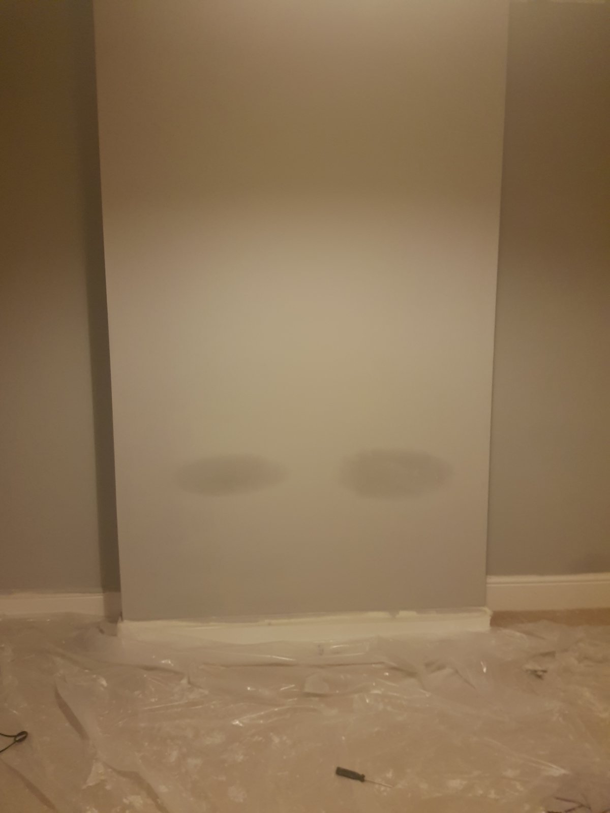

Hi all,
I was hoping someone could help.
First time painting so very new to this all.
Painted living room with 2x coats of Dulux (grey tone /Chic Shadow) It has been over 24h and certain corners are not dry yet.
They seem to be the walls which are towards the external so may be why. The main is concern is however on a wall where there are two very odd oval patches not drying..... Really not sure what the issue could be.
The wall was painted in a pale yellow before, we didn't use an undercoat. I also believe there used to be a fireplace in this spot so I am leaning towards it may be related to this?
Anyone can share any tips on what we should do?? Really stuck as everything else seems fine!!!
Thanks so much
See pic attached

how are you ventilating the room?
the chimney has no visible airbricks to ventilate the flue, so it will be damp inside from condensation. I wonder if those two oval patches are where airbricks used to be and have been plastered over. They are very regularly spaced. Drill a 25mm hole through each and see what you find.

As JohnD suggests, the sealed up chimney breasts need ventilation, otherwise moisture only has one way to escape - through the wall. What you have is a common occurrence and usually appears near where the fireplace opening was or higher, towards the ceiling. You also have a little patch above the skirting which could be condensation, some minor damp, or a water ingress issue. It may all dry out if the weather stays dry and warm for a while, but if it returns during rain, get it checked out.

It is also cold and humid out at the moment, and this makes drying slower. Are you both heating the rooms you are painting?

Yep, room heated.
