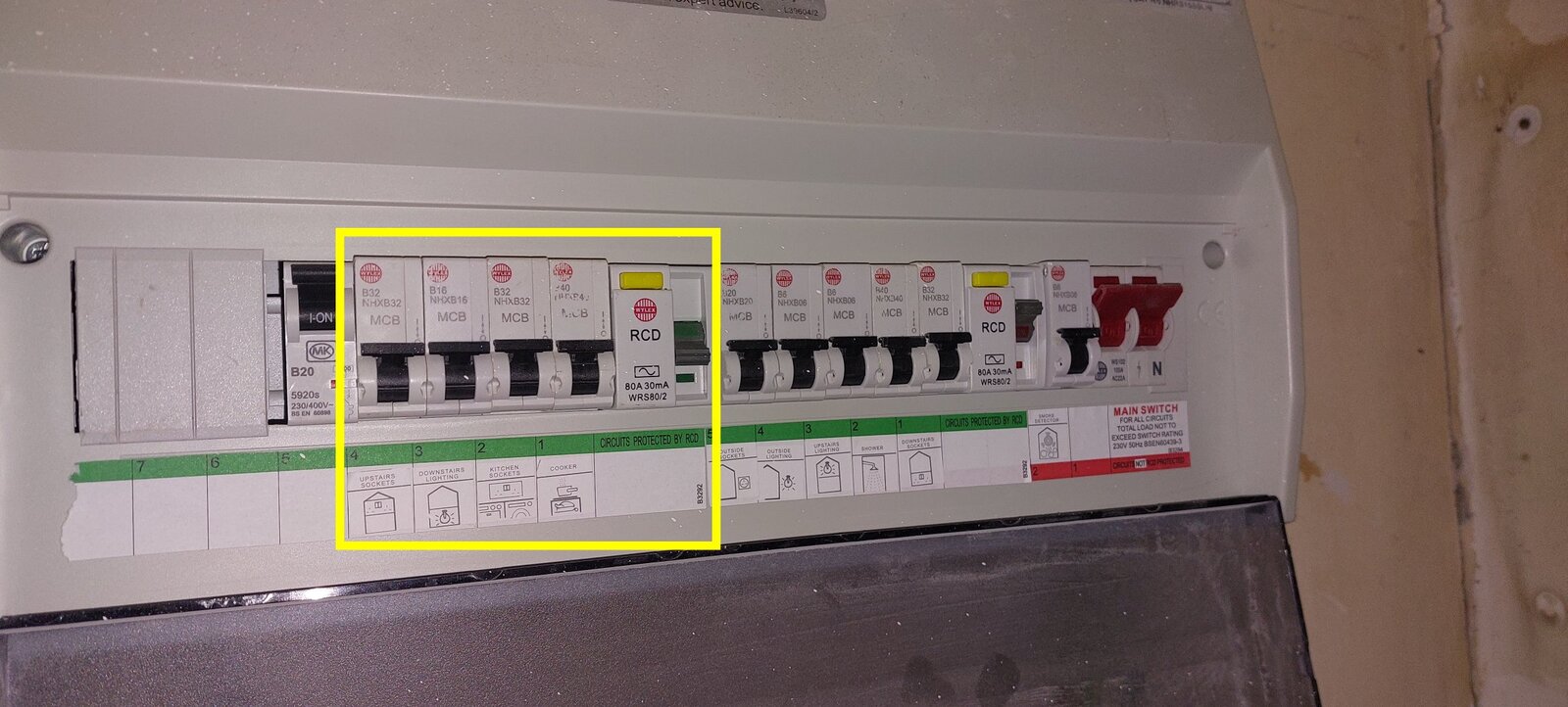

Went out this morning to drop my wife off at the station. Just before that I put the washing machine on. When I came home, everything was off.
Basically, the main switch connected to the meter will trip unless I leave the left RCD off.
I have tried turning this RCD on while all the MCBs to its left are off to start a process of elimination but the RCD will not stay on and trips the main switch connected to the meter.
I have not tried switching off all the relevant wall sockets off and pulling out the plugs because I'm assuming there's no point as I have tried switching the RCD on while all the MCBs are off anyway.

PULL ALL the plugs , and also turn OFF all fused SPUR switches hopefully they are double pole - Neutral and Live
there is a point in doing that - turning the MCD off does NOT stop an earth fault
is the washing machine on the Kitchen circuit - can you unplug that ?
Any rain, possibly in outside lights , connected to the downstairs light circuit
Also remove everything from upstairs sockets as well
I have seen a hair dryer left plugged in do that - as well as other devices
As above - however-

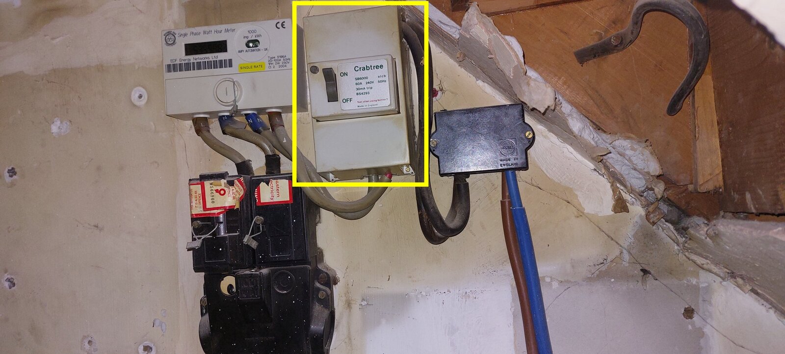

"and trips the main switch connected to the meter."
The main switch shown in your consumer unit does not have a trip function - which "main switch" are you referring to? Picture?
PS: That MK B20 MCB on the far left is not approved for use with the Wylex CU. Hopefully all the connections are sound and it is not physically stressing the busbar.

When I said 'main switch', I meant this one, sorry, tried looking up the correct term but couldn't find it.

I'm sure there's many other violations to this setup. As far as I am aware, this box was installed in 2014, just before we moved in. It's under the stairs and about 2 foot off the ground. You have to lie on the floor and if your waist is more than 44" then you'll struggle. I just hope an electrician will agree to touch it.

Ah, yes, that is not just a switch it is also an RCD, so we can deduce that this is a TT supply and that you have an earth rod somewhere (photo of the earthing/bonding for completeness pls). Proceed exactly as ETAF suggested and let us know the result.
