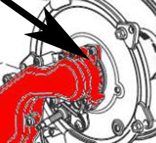

Hi I have a Glowworm 30HXI Gas Boiler
Recently it developed a problem, I called our cover provider Homeserve and they sent out a repairman. It required the Burner Door Seal (801635) to be replaced.
No problem, however the repairman was unable to get the part and after 10 days our home is freezing. I obtained the part myself and asked them to fit the part.
In doing so he damaged another seal/gasket.
Looked at the manual and he should removed the burner and fan as one unit to replace the burner door seal. However he removed the ducting from the fan to burner to remove the burner unit. Must have been quicker he thought. However in doing so he damaged another seal/gasket, which is required. However since he never got the original part it will be quicker if I source the new part which is now needed.
In the diagram below we need the gasket/seal between ducting (coloured red) and the burner plate. Can anyone identify the part and glowworm part number. So I can order it and get them back to fit.

part no is 801635.
Thats the Glow-worm 801635 Seal Heat Exchanger Door Seal, which fits between the combustion chamber and the burner.
Which was fitted, but he destroyed another seal as he remove the duct which connect the fan to the burner.
Its fits between the part i've highlighted in red and burner face plate. See below
How on earth could anyone damage that seal when replacing the burner door seal :eek:
You don't even have to touch that part or remove the fan from the burner to remove the door.
It comes off as one component.
Spares should be available at worst in 48hrs. I suggest you ask them to send an actual boiler engineer next time and demand your annual fee back as compensation for the idiot leaving you without heat for so long :mad:
I know, and I did point out at the time, that he was not doing the correct method stated in the glowworm book for replacing the burner door seal. Basically a crap fitter taking a short cut, then causing another problem.
