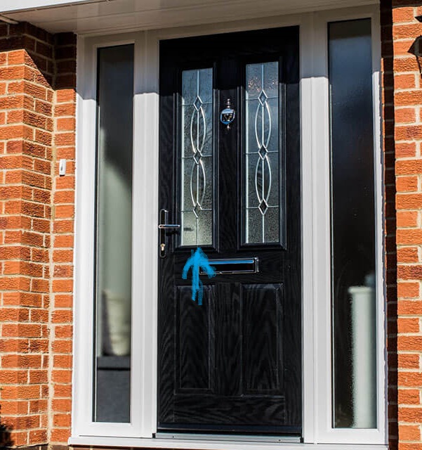

We had ver heavy showers today and noted for the first time water inside the hall.
I noted the leak came from the left cassette window.
The picture below is not our doors but imagine the water dripping through the inside back of the door where the arrow is marked.
Looking on the net I think the glass is taken out from the inside but after that not sure if its a seal, glue etc.
Another idea is to use a sealant, clear on the outside - what do you think and what would be the best clear or black sealant as our door is black on the outside and white inside.
NB: Where the blue arrow is the door is leaking from the back ie inside bootm of this frame. Door is just outside the warranty by a few months of the ten-year warranty but the company is useless.
What sealant or what should I do and how much approx would a professional charge approx
Would probably need to see your door, but if the panes are removable from inside, then if they’re like double glazing, there will be rubber seals on the beading. There could be some gasket/seal that’s perished on the glass panel as well.

Some cassettes are dry glazed while others have a double sided adhesive glazing tape just on the outer cassette but its foam and sucks up water, I wouldn't attempt to take the cassettes apart and they are a one time use affair now and you'll bust the clips off that lock the 2 halves together, whenever I changed units in composite doors they always came with new cassettes, best just to dry the outer and apply a fine clear bead of low mod neutral cure silicone, your also get the same problems with the letterboxes too
