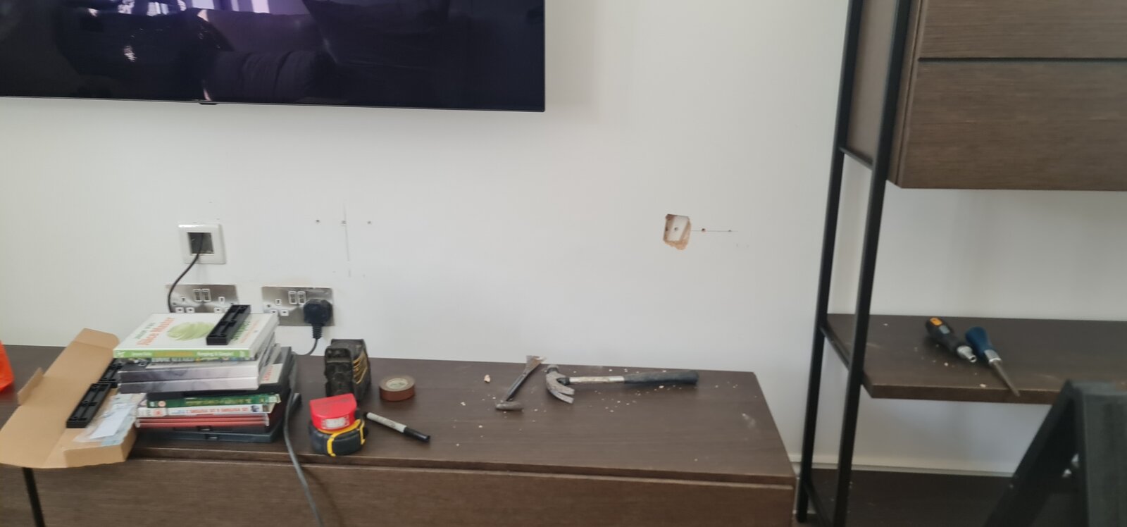

Customer purchased some BO Concept furniture. They assembled it but refused to hang it to the wall. I loosened the two 2 gang sockets on the wall and checked the directions that the cables ran in. The customer warned me that the builders had previously put the socket for the wall mount TV in the wrong place and vaguely pointed to where it had been. 2nd hole I drilled tripped the RCD and MCB. Turns out that the builders decided to run a cable at 15 degrees to the vertical with absolutely nothing to indicate that there is a cable in wall.

I flipped the RCD and MCB and the sockets have power again. I guess that the drill bit hit the earth and live simultaneously. I have no idea if I have completely wiped out one leg of the ring. I guess I could remove the left socket in image number two and remove the cable running to the one on the left and then see if the left socket still works.
I am thinking that I might get an electrician in to run proper tests. How do I cut through the surface mount channel without damaging the cable further? I was thinking of using an oscillating saw. I can enlarge the hole to the left but do want to go any further to the right.

Thanks but I don't see how chasing up to the ceiling will help. The (potential break is about 600mm off the ground). It is part of the ring in a newly wired property. There should not be any inaccessible (non MF) junction boxes in the ceiling, or elsewhere.
How do we know the damaged cable even goes to the ceiling?
Could it come from the two sockets low down?
It seems like the damaged cable(s) were intended for the TV, and got plastered over.
Have a look in the two sockets - you never know, it may be that the cables come from here.

To the point, you might be lucky and find that they've used cable protectors, the plastic flat kind.
Sometimes you can pull through a new cable without chasing anything.
Check if you can move the cables from between the 2 access points (sockets?).
