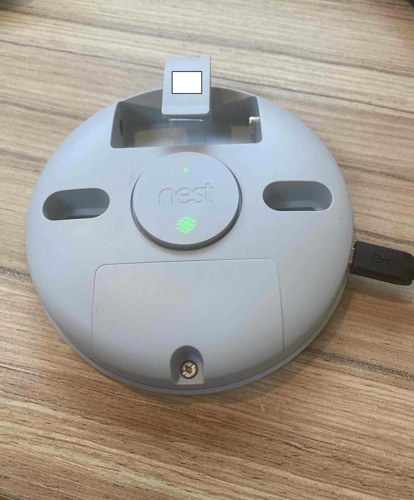

I have a nest 'e' (UK) and the heatlink is powered by AA Lithium's which should last 'years'.
The heatlink has a USB port which for 'fun' I decided to plug into a USB 3-pin adapter.
The heatlink can seemingly be powered successfully by this.
Will any longer term damage happen to the heatlink if powered in this way?
I ask because I'll be the leaving the device in a second home in Italy and it would save any issues re battery replacement.
(Previously asked elsewhere in this forum but it didn't get any response as likely not the correct sub section so apologies if you've seen this elsewhere).

I wondered whether it could be powered by mains permanently without damaging the unit.
I have tested it for a few minutes and whilst it appears to operate okay, I'd not want to damage it.

Does it seemingly work when plugged in via USB and with the batteries removed though? I mean full functionality (e.g. including relay switching) rather than just seemingly powering up (for the purposes of diagnoses/updates only etc). If so, I'd stick with doing so!
Does it seemingly work when plugged in via USB and with the batteries removed? If so, I'd stick with doing so!
It seems to function perfectly well via USB without batteries.
The top - purely decorative - cover would need to be removed / altered to leave it plugged in permanently but in my scenario (empty house) this wouldn't matter.
