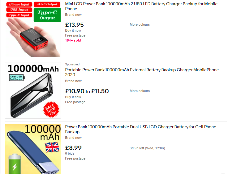

A search on eBay for "power bank 100000mAh" (WITH the quotes) gets 235 hits, the first three of which are:

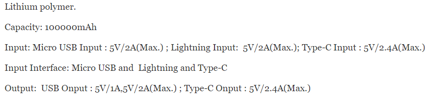

.. and the text of the listings continues to talk about 100,000 mAh - so it's not just a one-off typo in the listing title. For example, the spec of the first one above includes ...

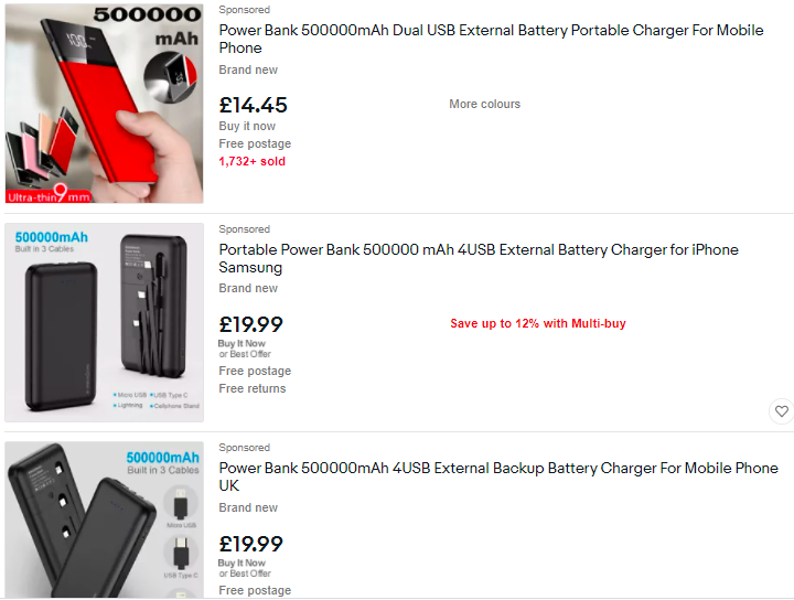

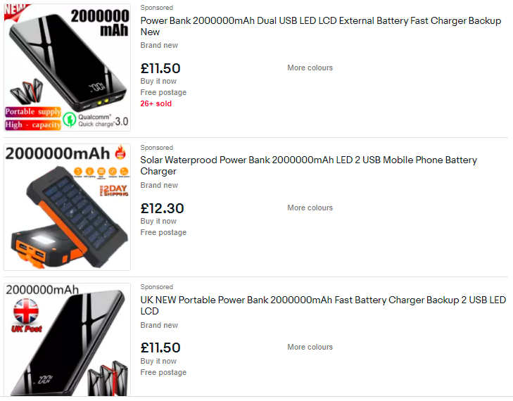

... I can but presume that they don't understand what "mAh" mans, and are all copying one another! If they are, as I would guess they probably are, 10,000 Ah, then they are still 'too cheap', but probably no more so than one expects of "Chinese imports". Mind you, whilst I can guess that "100,000 mAh" may actually mean 10,000 mAh, what on earth can 500,000 mAh (aka 500 Ah - but again about the same physical size!) mean - and there are 267 hits for that, of which the first three are ...
... and, maybe 'the record' :) ....

The claims on battery capacity are not mistakes - they are just outright lies.
One vendor has power banks of a certain capacity, so the next one will claim theirs has more so it appears better value. Repeat forever.
