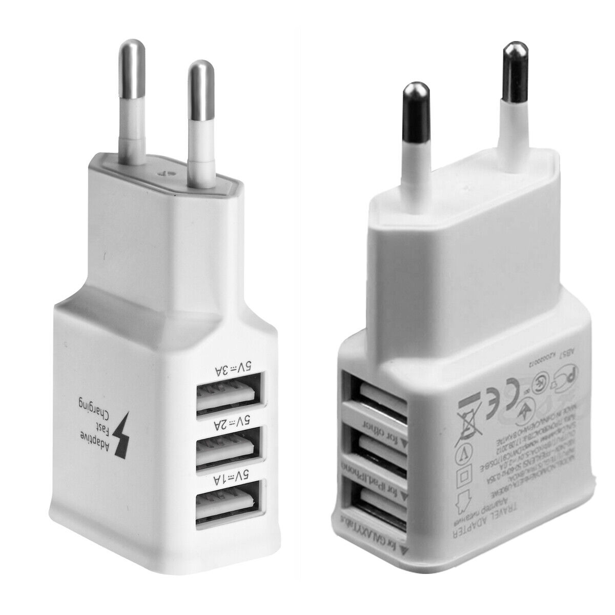

However because I don't does not mean no one else should and I see no good reason why these 1662476723022.png should not be used in the bathroom. One can plug in one of these 1662476867957.png into a shaver socket, so why not have a direct USB outlet, they are likely far safer.

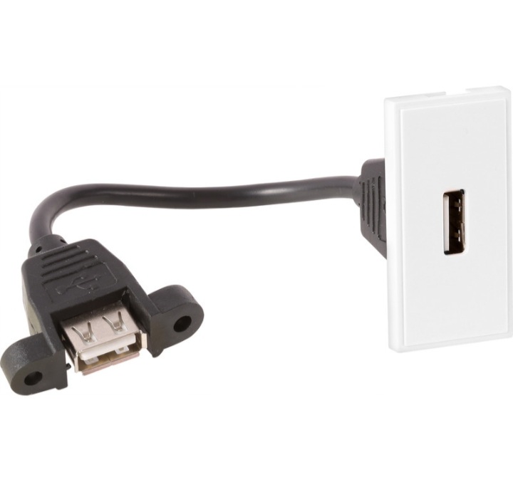

I believe an accessory such as a euro module USB faceplate:
should be fine.
As long as the actual power supply is fitted out of zone - in the loft as you suggest, or even a device such as the LAP module that Eric suggests, could be fitted inside a vanity unit. Your USB extension leads would then have less distance to travel.

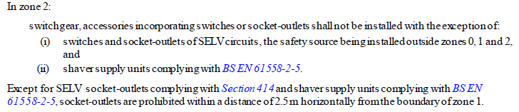

701.414.4.5 Requirements for SELV and PELV circuits
Where SELV or PELV is used. whatever the nominal voltage, basic protection for equipment in zones 0, 1 and 2 shall be provided by:
(i) basic insulation complying with Regulation 416.1, or
(ii) barriers or enclosures complying with Regulation 415.2 and affording a degree of protection of at least IPXXB or IP2X.
It talks about "SELV at a nominal voltage not exceeding 12 V a.c. rms or 30 V ripple-free d.c.. the safety source being installed outside zones 0, 1 and 2." and 5 volt USB would fall into this.
As I said, that would only be the case if one could successfully argue that the 230V bits in the backbox of the OP's USB sockets were 'outside of Zones'- but, as I said, I'm not convinced about that argument.
If the accessory were mounted on a 'surface box' ,I can't see that one could argue that it was acceptable, so I'm not convinced that sinking it 2 or 3 centimetres into the wall necessarily makes a difference.

How about one of these, seems to be made for the job
