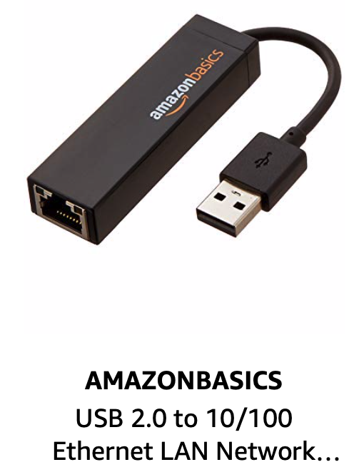

if i connected a USB device to my network through a "USB to Ethernet adaptor" would i have access to the device as if I had plugged it straight into the computer ?
"USB to Ethernet adaptor" converts a USB port on your computer into an ethernet port.
This is for computers without an ethernet port (and only using WiFI) to be able to connect to the internet / WAN via a hard wired ethernet cable.
You plug the USB into the USB port on a computer and you then have a Ethernet connection for an ethernet cable.
You cannot connect a USB device (eg a USB memory stick) into a "USB to Ethernet adaptor".
is there any way to connect a USB device to a computer through some sort of wireless connection ?
I have some of those ethernet plugs that use the household wiring to create a network and had hoped I could somehow use those.
